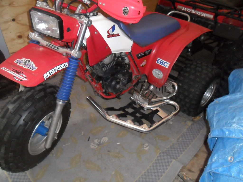

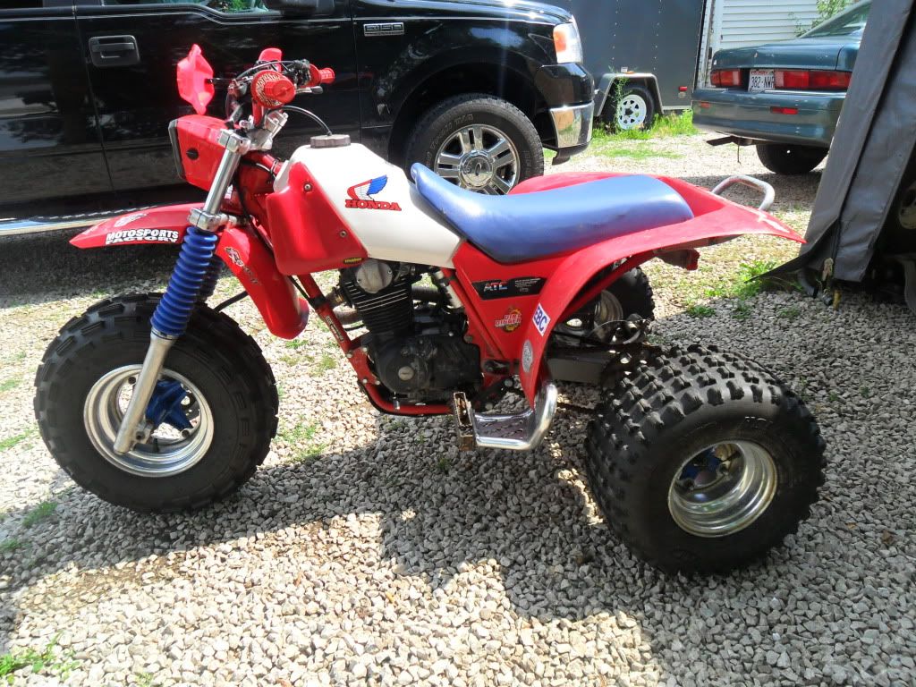

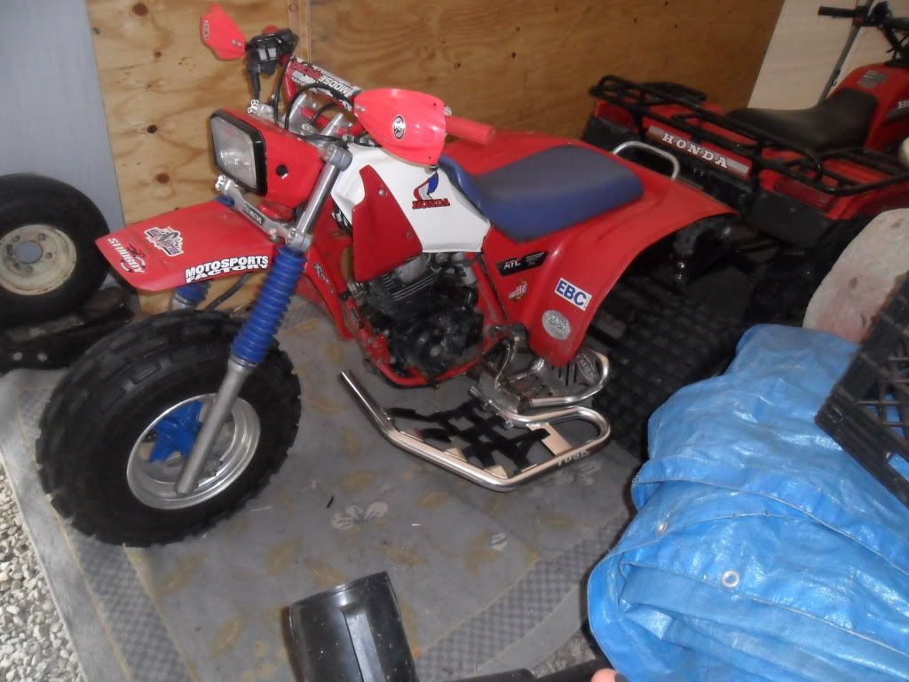

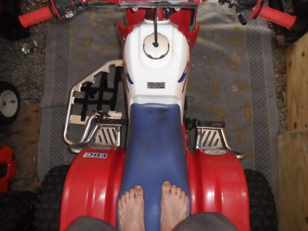

Messed around the shop yesterday with a set of 400ex Tusk heel guards.
[IMG][/IMG]
[IMG][/IMG]
[IMG][/IMG]
My intention is to add a set of Warrior Tusk nerf bars that I have. Pretty much boxed in the pegs and drilled some holes and bolted em on. Had to extend the left peg, the right peg sits out more off the frame than the left one. Made a quik mount for the top to the subfrmae area. Sorry for the crappy pics, I will take some better ones tomorrow evening. Everything is just goodly tacked on in case I need to adjust something when I do the nerf bars. Also need more goodly bolts for the subframe mount. The nerfs should bolt on the front side of the peg like the guards. Haven't started the front mount yet. The front cross bar for the nerfs rests about halfway between the frame by the lower engine mount and front tire, kinda out in the middle of nowhere. Gonna take alot more Bud Lights to mock that up.
