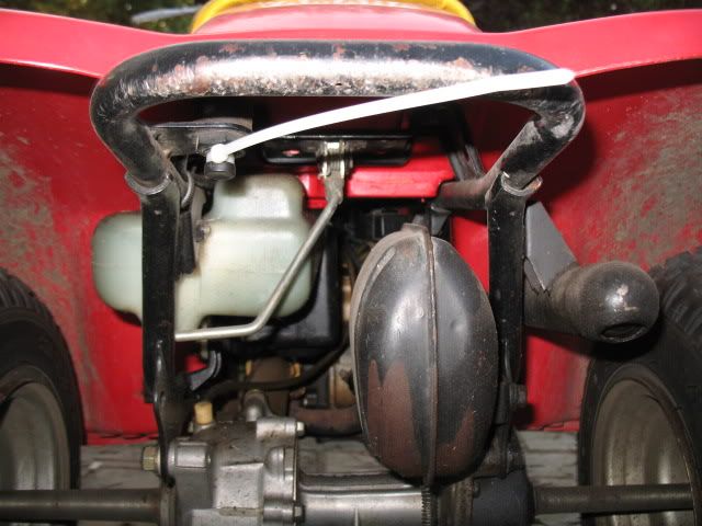

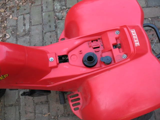

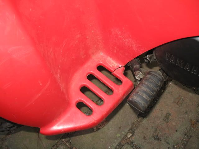

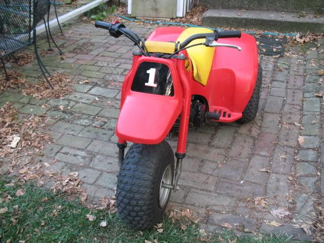

    1985 Tri-Zinger, just picked this up a couple hours ago for $350. guy said it was mint, but i know everyones idea of mint is differant. condition is basicly about what i figured it would be. so how did i do? anything wrong or missing that you can see? the guy said he had just lost the clip for the safety shut off right before i got there, front fender/number plate needs mounted correctly, gas cap is cracked, right side of plastic next to peg has a small crack, seat has black rub marks from pull start and tank stickers are pretty rough. looks like there should be something next to the oil injection bottle filler under the seat, just don't know what or if there was anything even there. the oil injection does work. starts very easy 1 pull, new tires and rides straight. only real thing i've noticed sofar is it'll get up to (i'm guessing here) about 15 maybe 20 mph then seems to hit a wall and quits pulling and won't go any faster. read on here where people were saying it should do about 30mph. yes, switch is on the run position. any pointers on where to find a gas cap, tank stickers and such? e-bay my only choice? also, the fuel shut off is very hard to turn, got it turned on, but had to use pliers to shut it back off. any ideas on why it's so hard to turn?

    That's a nice pickup right there. Gratz.

    Looks very nice.. They are a load of fun as well.. Ebay is probably your best bet for parts. There is a space under the seat for a "tool kit", but I think it's just a plug wrench. I have 4 tri-zingers and none of them have the tool kit. There is a NOS shut off cord and clip on Ebay now. The 4-zinger (yf60) used a lot of the same parts (mechanicals) as well. Ebay has decal kits as well. There is a small washer type thing between the head pipe and the head that is used to slow them down, you might see if it's still there or not. They tend to help gum up the works inside the pipe and silencer. There is usually a clog of goop in there making it run poorly.

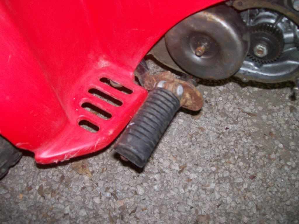

    don't want to really go with warming over the motor, it wants to pop a wheelie when i take off already. just looking to fix it up and get it up to speed. it needs a little work. seem to be a good, but fair buy i'm thinking. either way i'm keeping it, so it might take awhile, but i know i need to do something about the pegs. i can only fit half my foot on them, any suggestions?

    I ride with my heels on the pegs and my feet pointed outward.

    One of my parts tri-zingers has motorcycle foldable pegs on it.. lol

    The pegs are big streetbike pegs you can barely see the drag ball on the peg to let you know when you're about to take a digger.. lol

    also, where exactly is this washer/spacer in the exhaust? i took the head pipe off and it was open. nothing like a washer or spacer in there or on the head. so if it is already out then it would be a safe bet the exhaust is just really oiled up then? govenor screw on the throttle is taken off already so it's not that.
