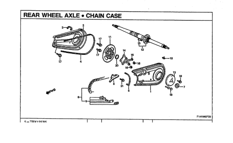

    the snap ring that holds the sprocket on has no holes it's num 19 in the diagram.
    Jul 2011
    Lilly PA
    1,480
    #19 is a bolt, #20 is your snap ring and should have a break in it to pop it off

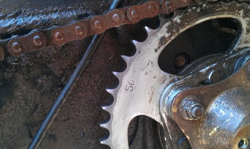

    item 20
    it has no holes for the snap ring tool it was a sob to get off, But i got them swapped out and rode some wheelies down the street whoo hooo my son is going to be so happy!!!!!

    You're gonna destroy that sprocket because you didn't put a new chain on. Kind of a waste.
