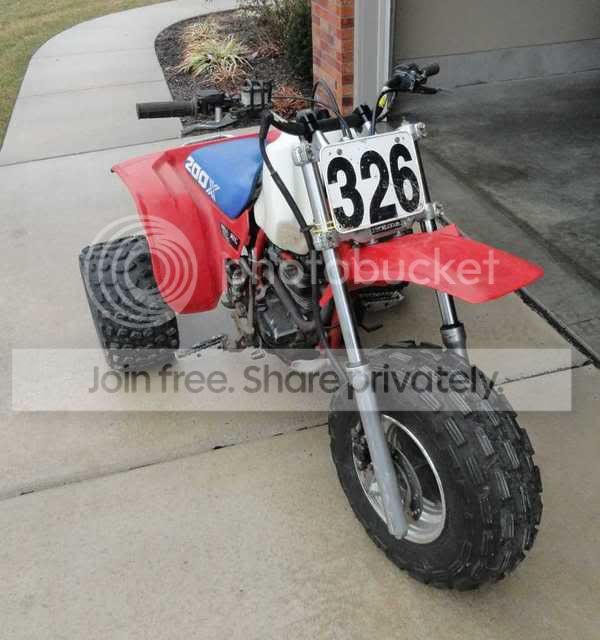

    ok, heres the update list below. Gonna test drive next weekend. Thanks for the various parts received from members.
    1. 250R forks, 350X triple tree
    2. Plastic clark tank, UNI air filter
    3. Pro Taper contour fat bars, fat bar adapters
    4. wider footpegs from 250rRoostmaster
    5. 400EX hubs
    6. 18" Kenda Klaws on 9" rim
    7. GT Thunder rebuild rear shock
    8. number plate replaces light
    9. CR85 caliper swap mod

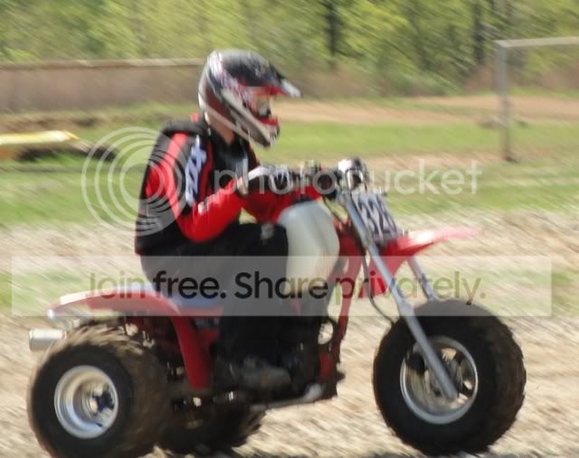

    Ok, i test drove the bike friday. I changed to stock 450R tires on old 350X rims. The best pic I have is below. I dont remember being too big for the bike, but I am. However, the ride is not good. I fought the front end too much. I think I need to push the 250R forks up into the trees at least an inch. Also, move handlebars more forward. I let too much pre load out of the rear shock.
    Anyone that has done this 250R mod got any tips for dailing in the 250R front better?
