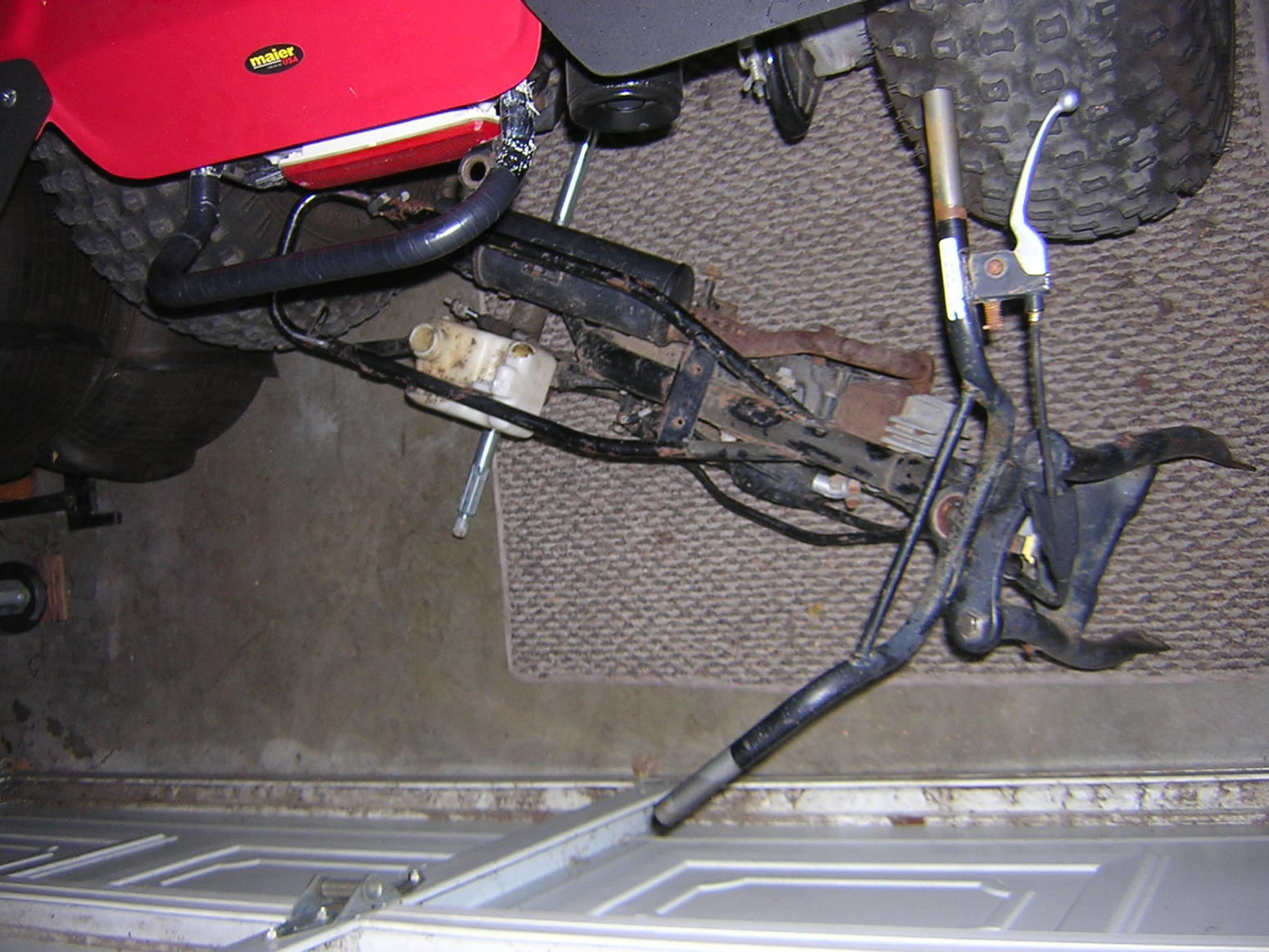

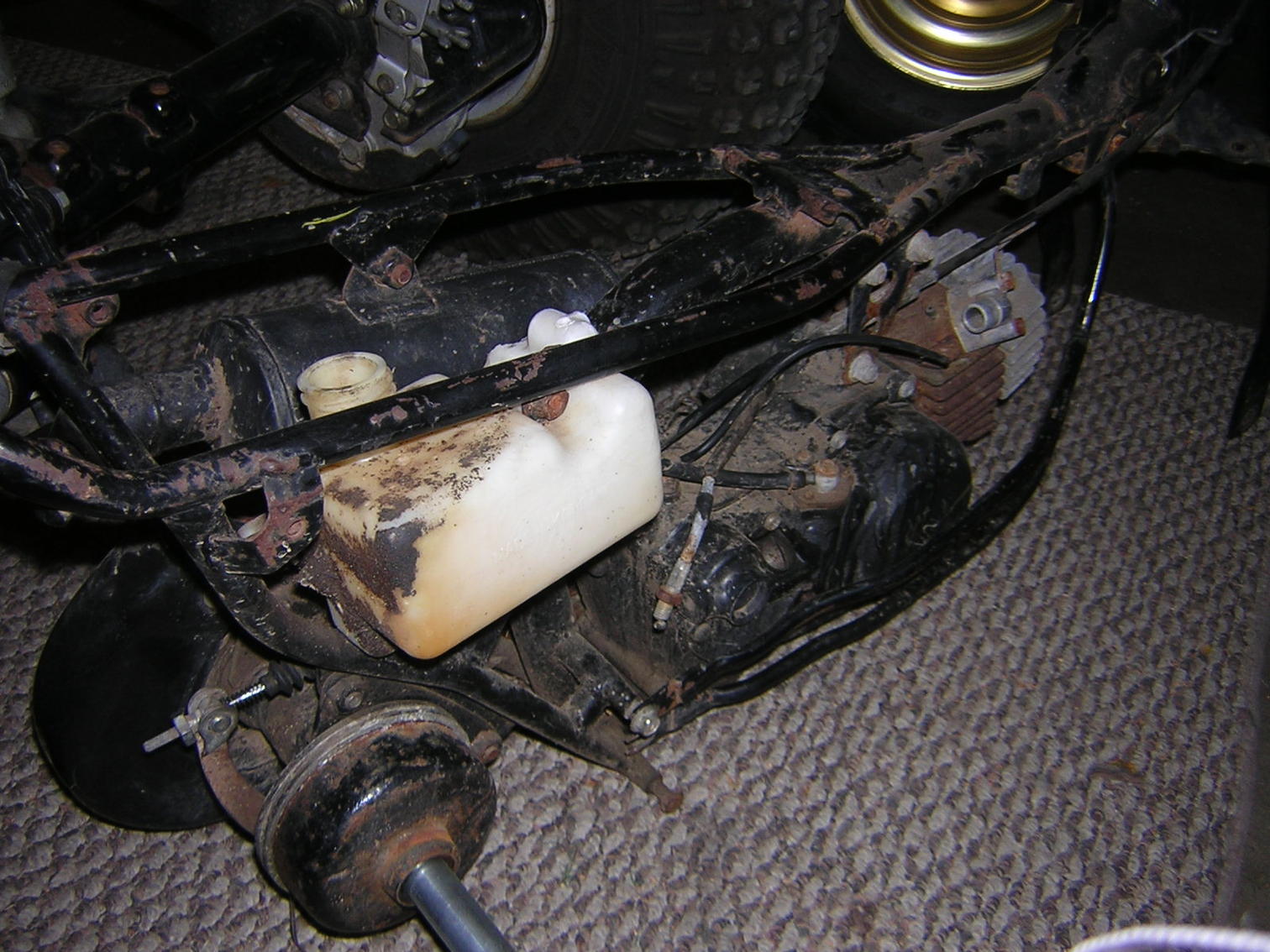

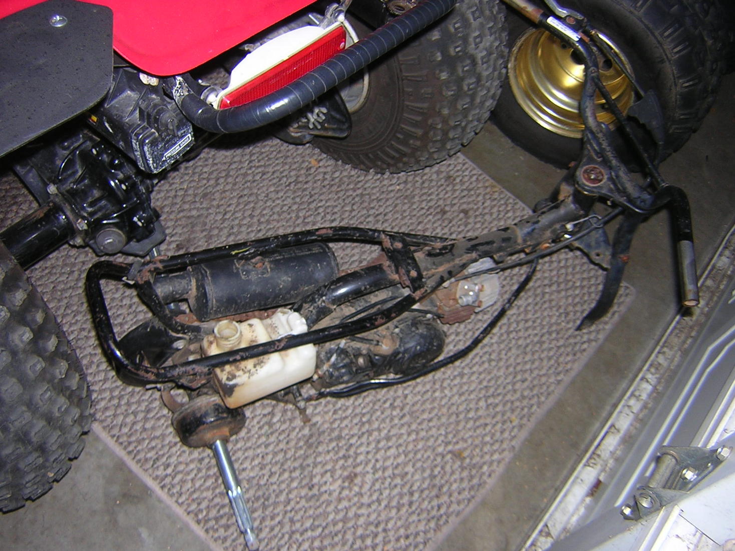

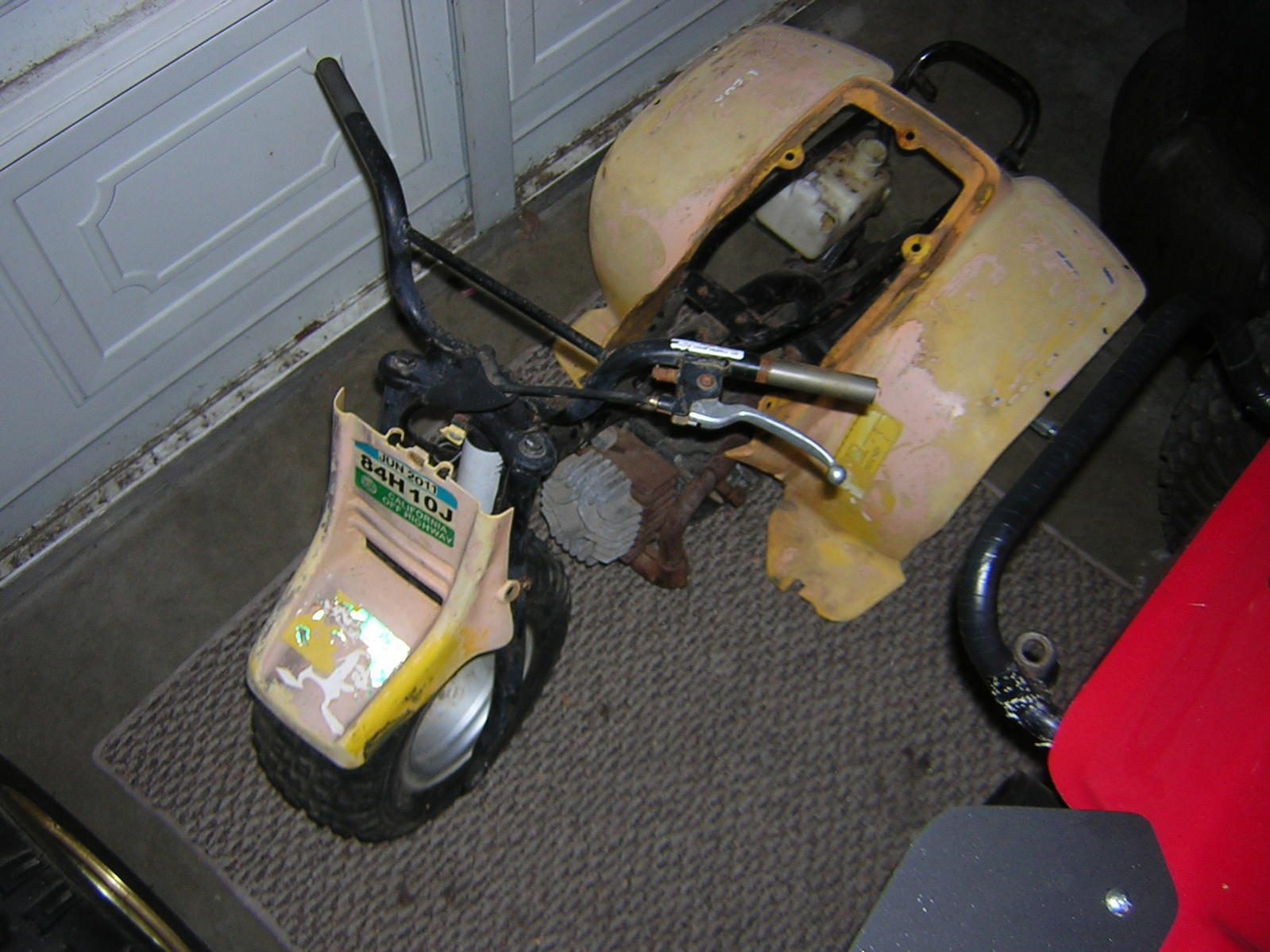

    Well, this is my first post, so hello everyone. Glad to be here. I recently came across this tiny little guy on Craigslist and decided it would be awesome for riding wheelies in front of the house. Once I got it home I realized how much work it needed. I never really intended on a full restore, but it's kind of going that way. I'm not trying for a mint restore, but it will be as nice as I can get it within my budget. Anyway, I'll post up some pics....
    These are pretty much how it came home. I took the wheels off and the seat....I was too excited and didn't take too many pictures along the way. sorry.

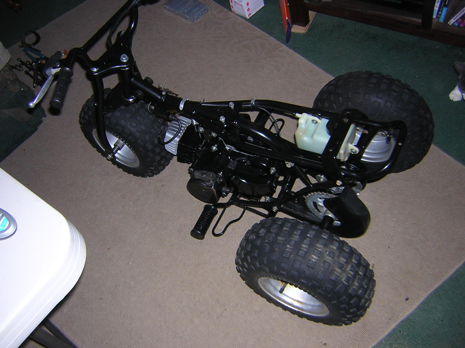

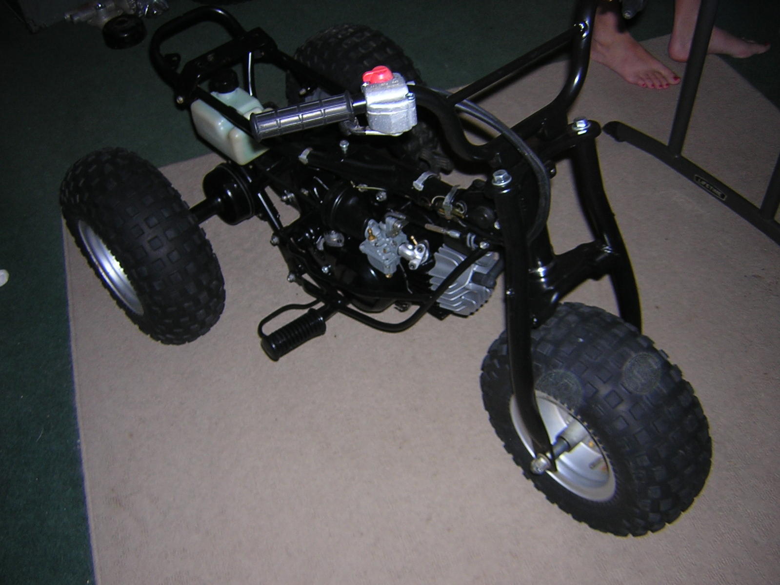

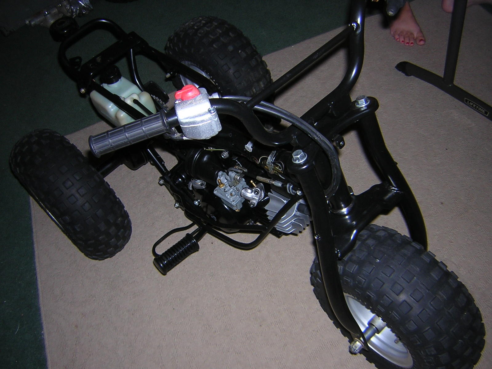

    I completely tore the engine down only to find there were no piston rings and the bearings were shot. So it got all new crank and transmission bearings and seals. A new +.020 piston and the head shaved down .030 to up the compression. Again, no pictures of all this. =(
    The frame got sent to the powder coaters and this is pretty much how it sits now....I'm still waiting for the new plastics and seat cover to arrive, and I need to repaint the tank....but it's coming along.

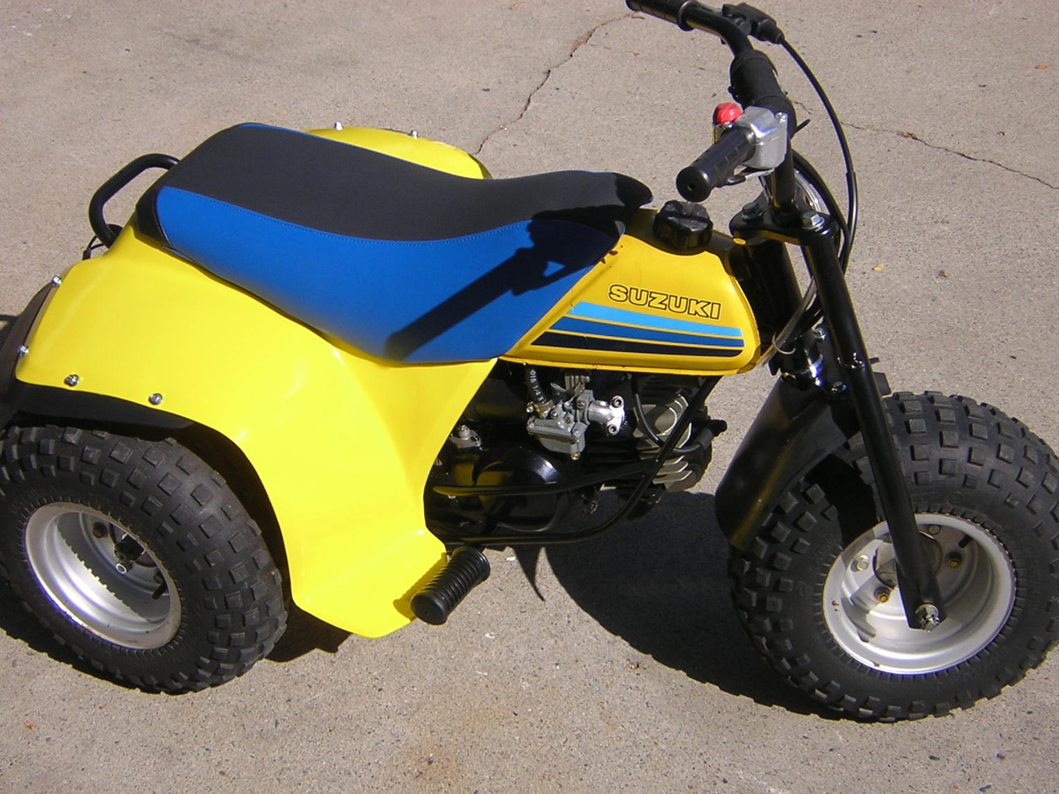

    Anyway, I finally got the parts in, and instead of taking pictures, I put it together and rode the hell out of it. My neighbors just shake their heads and walk away when they see me coming. I'm 6'1" so I look like a monkey humping a football on this thing, but it's a blast. It accelerates like a beast but tops out pretty quickly. Makes me wish I had a second gear, but oh well. It's a wheelie machine for sure.

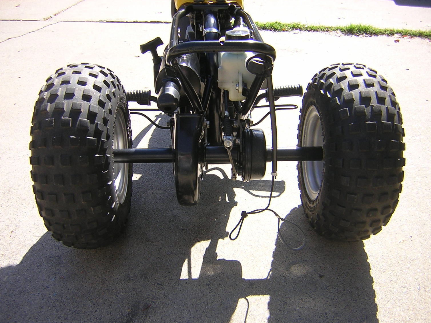

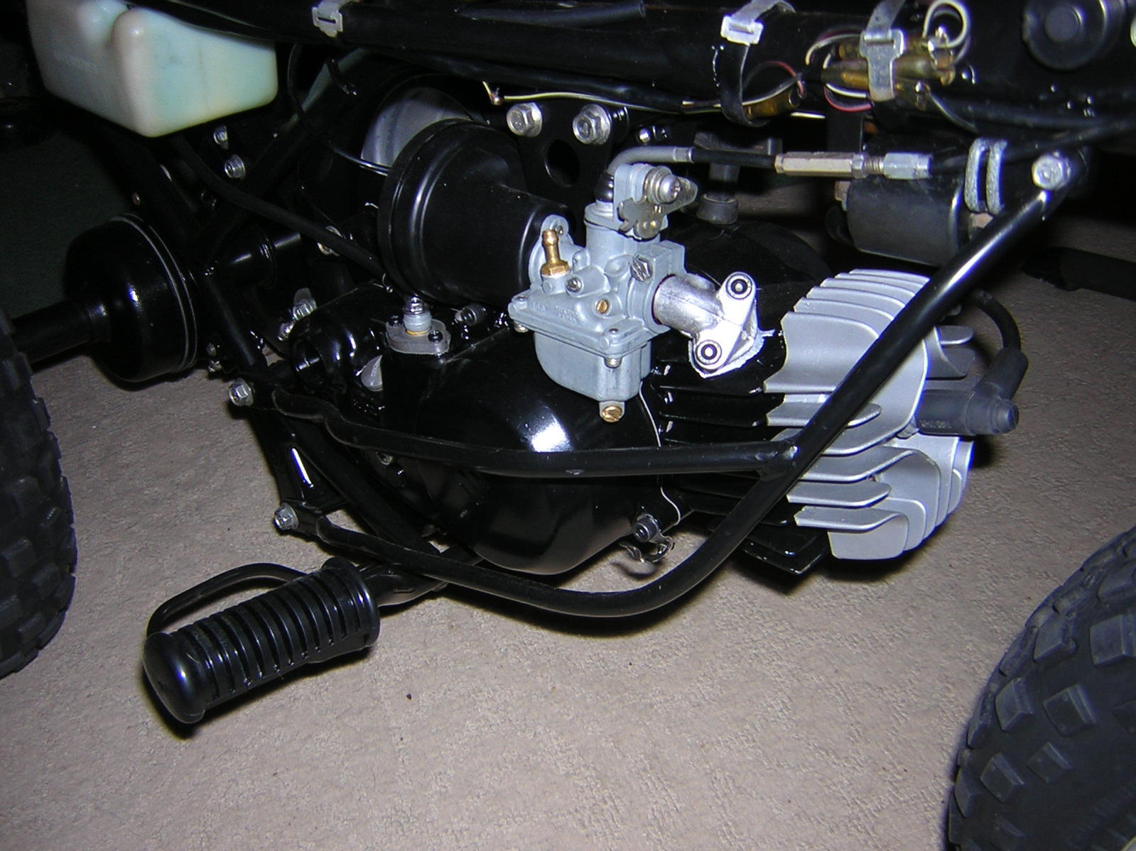

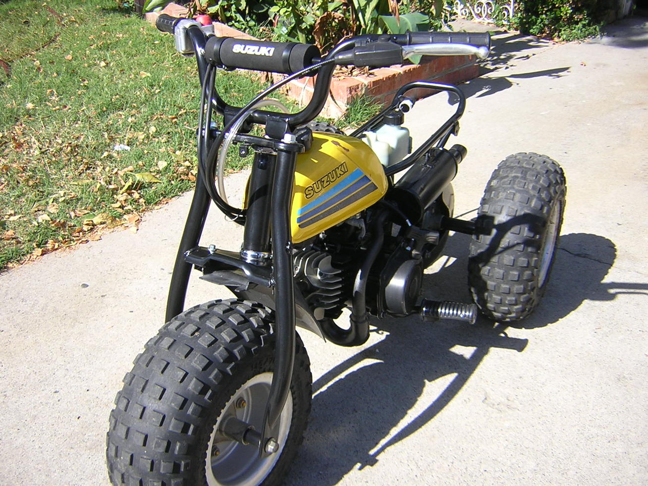

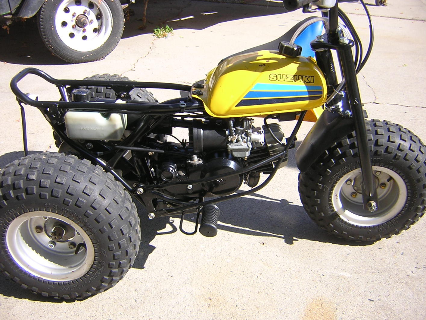

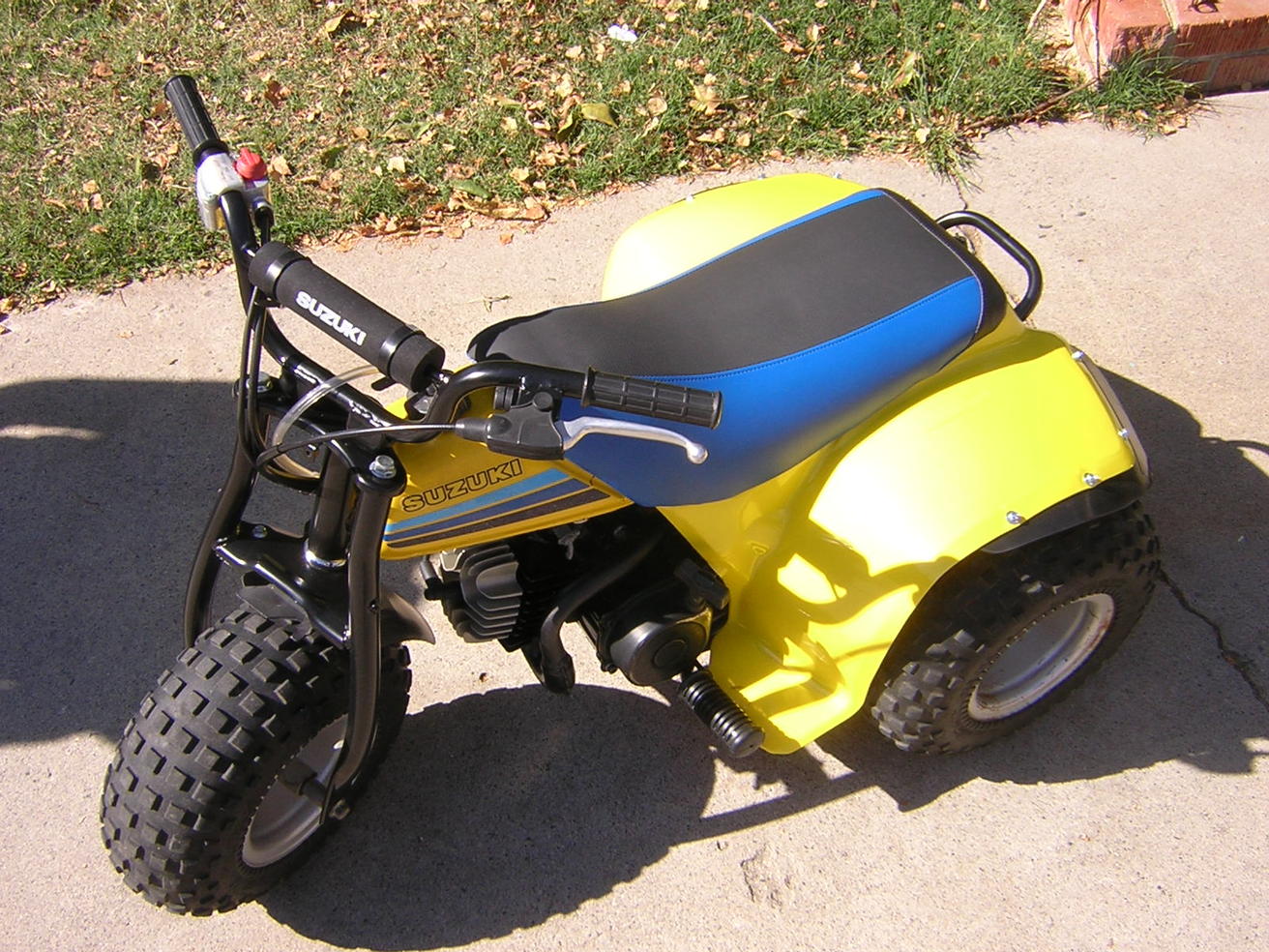

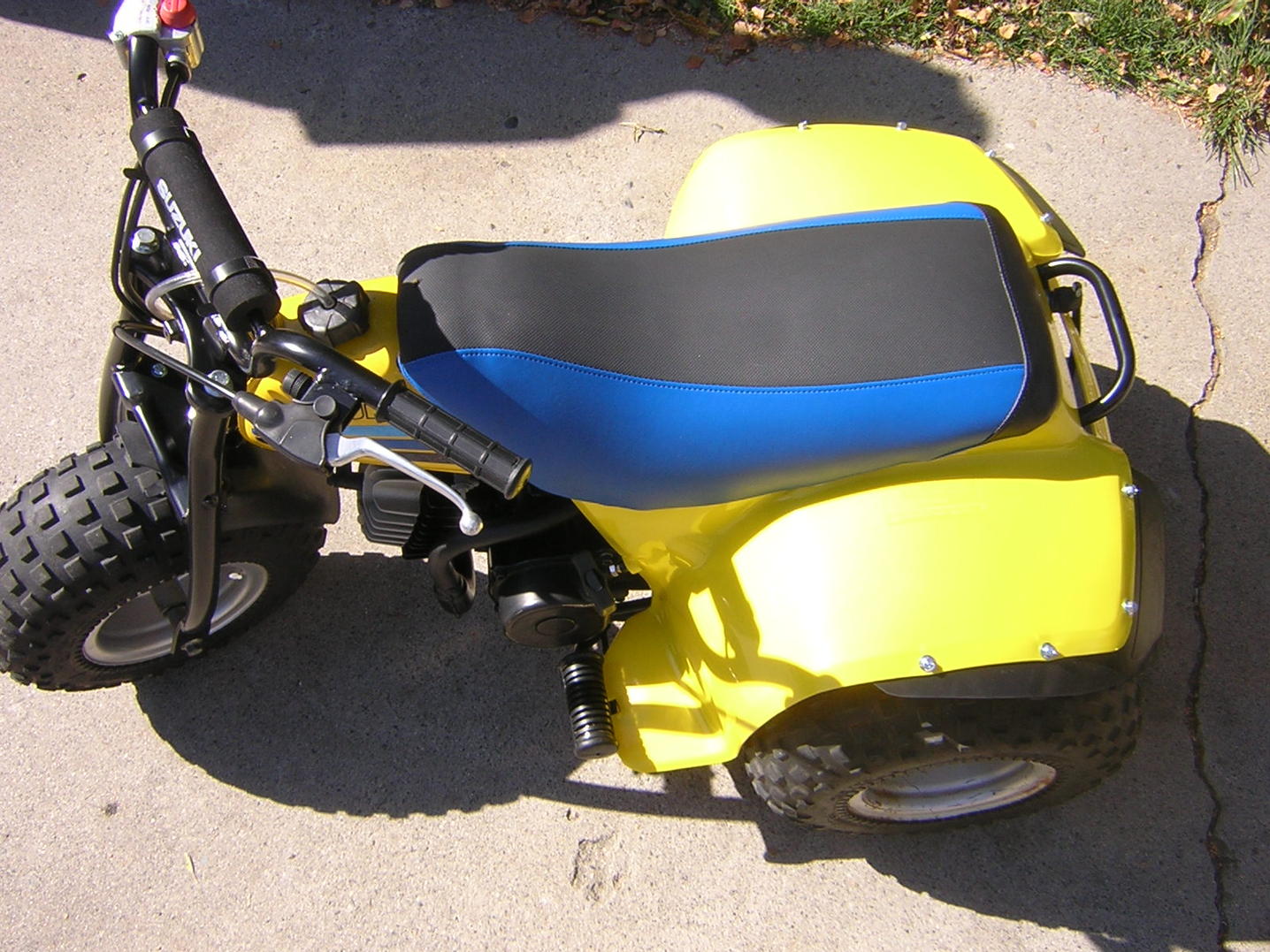

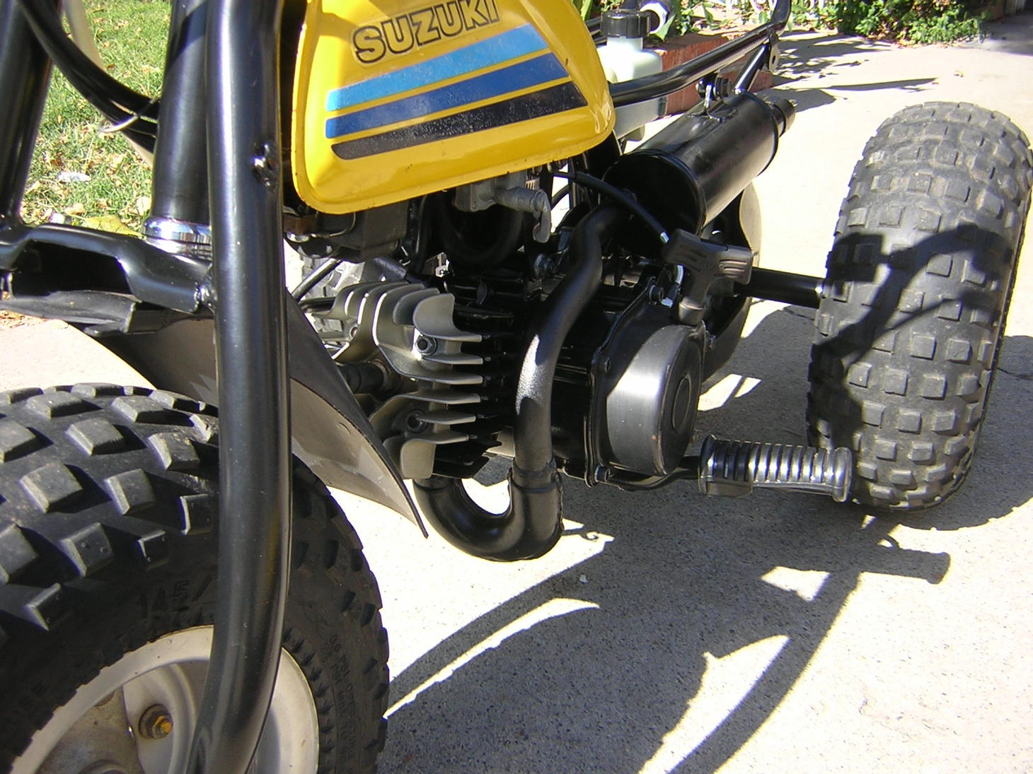

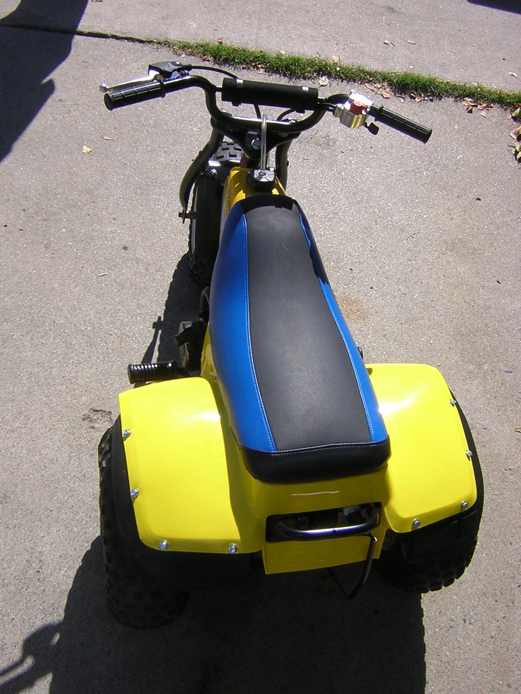

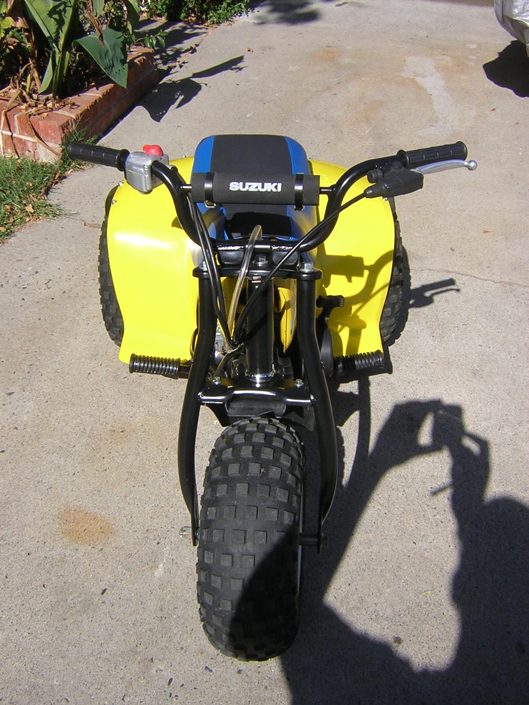

    I did, however, manage to clean it up a little and snap some pics this afternoon. Take a look:

    I decided not to paint the tank just yet. It runs fine the way it is. And I have 3 new tires for it. They'll be replaced next week when I have access to a tire machine. These little buggers are a pain to break the bead on.
    That's all for now...I'll post some more when I have some more. Thanks for the interest.

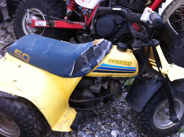

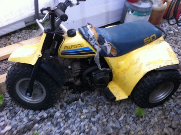

    It looks fantastic windupdevl! I just picked one up for really cheap and would like to restore it. I was told the machine was sitting for 4 years, and ran before it went into storage. Here are some pictures of it:
ID:	149394Click image for larger version.
ID:	149393Click image for larger version.
    It seems like it has great compression and would like to try and get it started this weekend. I'm going to completely clean the carburetor, fuel tank and oil and put fresh fluids in.
    Also, I'm trying to find a free downloadable service manual. Can anyone tell me where I can find one?

    nice liitle ride. its coming along nicely. Is that a 85 250 sx with electrical tape on the grab bar..

    IronBear: I sure wish mine was that complete when I started. It's funny I just started this little guy up last night and rode it around the block a few times. Been busy lately so I don't get to fool around on it much these days.
    Keepah Rolln: Thanks, and you are close. It's an '87 250sx with electrical tape on the grab bar. Like that when I bought it.
