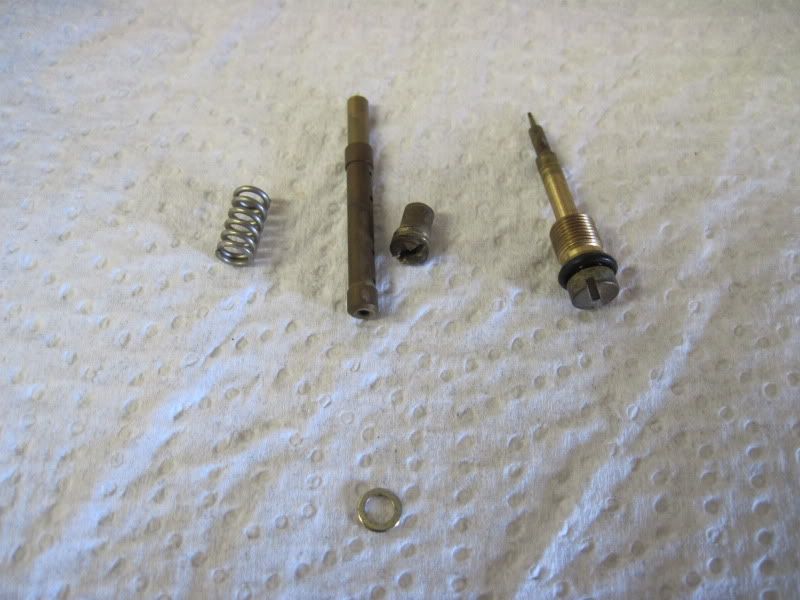

    Well that went over like a fart in church. I take out the floats and 3 jets (why 3 BTW?) and start spraying away. I unplugged a couple of ports and seemed to be making some progress. I put the jets back in and started spraying through them to make sure everything was opened up. There are two problems I have encountered at this point-
    1- I can't seem to get any fluid to come out of the very front (closest to the motor) orifice that the mixture screw (?) is under. I'm assuming there is a port coming from one of the small jets that goes to this orifice and I can't seem to see where it is to unclog it (because I can't get the goddam carb off the bike). Where is this orifice supposed to get its fuel from?

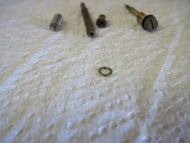

    2- All of a sudden this stupid little washer shows up from nowhere in the venturi near the butterfly and I have no idea where it came from. WTF?

    The washer in question is the one in the foreground. I know, I know, "use the manual Fabio". Well never in my life have I had to use a manual for a simple carb cleaning. I'd like to meet the guy who designed this setup so I could punch him in the face.

    The washer looks like a carb bowl screw washer to me, but it may have also been installed along with the spring pictured too.. A member here by the name of Chillian is a long time friend of mine and has an SX. He has had his carb off for service, but I wasnt present when he did it. Try PMing him, he would know the trick to get the carb outta there. I know he said it was a b***c. I wish I could help you a bit more than that, but I dont want to misdirect you.

    Thank you, but it's not a bowl washer.

    By any chance did the spring come out with the mixture screw?

    The little washer appeared on the paper towel when I did it also, memory tells me it may be for the mixture screw below the spring..but not 100%(it's been a while)..

    the front "jet" is more like a choke jet. if you open the choke i bet you will get it to spray through. the little washer also has a rubber O ring that goes with it. it is still in the carb or fell out also. they go in the mixture screw hole. when holding the screw you would first put the washer on then the rubber O ring on then thread the entire thing into the body. just look inside the body to see if the little O ring is still in there. they are hard to see and may very well be lost.

    X2 on the spring. it would be the spring then the washer then the O ring.

    The fiche lists three washers and I don't think any are the ones you have in the photos as there are two on on the bowl and the third is on the upper front right side on a screw that holds a cover they call the "body cover" http://www.bikebandit.com/houseofmot.../m1914#sch6400
    However there is a jet/screw looking thing that goes into the carb from the bottom on the front right corner called a "screw set" and it seems to have a washer that the spring pushes up against to keep it from touching a small gasket. Looks a lot like your picturers, but the fiche is so blurry I can't be sure.

    That sounds right that the washer would go with the mixture screw. So there is another O-ring Jensen? I'm a little confused as to your assembly instructions. Are you referring to the order of installation in relation to the carb or how they would stack on the needle? I'd prefer the order in which to stack them on the needle. Very good info on opening the choke to see if that port flows Jensen, I'll try that.
