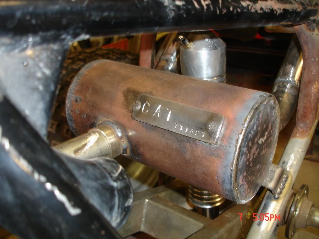

    ok i wanted it to be quiet and since i couldn't use the stock muffler i cut it apart to see where the bottle neck was,, the turbine core in front of the spark aresstor was it,, so rather than modify it i figured twice as many would help it breath, ,,, so i built a muffler with baffles in it like a flowmaster car muffler, it should be quiet and legal .... this trike will be a chase trike for the mass 70 rides coming i am going to build a suspended trailer to haul gas tools food and supplies we are going to start exploring the old ghost towns and what better way that a 70? don't need to go fast or tear up the country,, just get there and back,,, oh yeah i added this today...

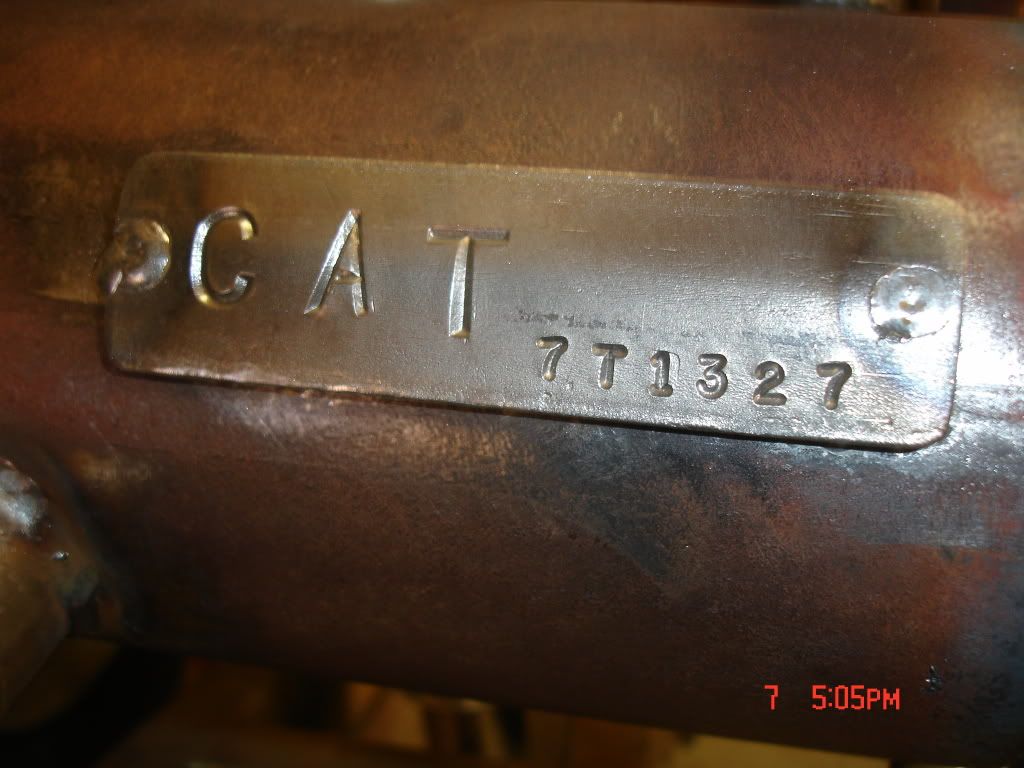

    i guess the caterpillar theme will really come out in the paint and a few more details,,, and really killer decals and lighting...

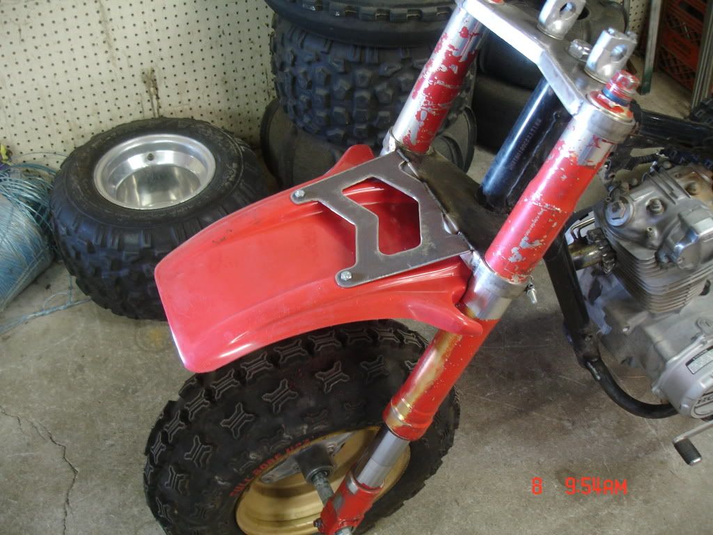

    only got a little done today... daughter flew in and so i am done for a few days,,, did this today...

    I was expecting the Honda wing to be hand cut into that brace. You're starting to slack off! Looks great! I can't imagine what you could come up with if you had a water jet and some aluminium in hand, but I bet I'd buy whatever it was.

    when it all comes together you will see why no honda wing,, more generic industrial...

    Hummm, sounds like the first action shots will require a yellow hardhat on the operator's head for authenticity... Looking forward to this. I just noticed how you dealt with the front brake issue, hope the rear is in good order

    Wow... I want a Freaking Dual Exhaust Also!!!!!!!!! That is Epic!! Very nice work..
    What about clearance though for when u hit a jump. looks like the top of frame will smash down on the exhaust.
    Sweet though,!!! Let me send u my exhaust and maybe u could do a little fab work for me a dualy!! lol Love it
    KASEY's Avatar
    ARIZONAS BIGGEST TROUBLEMAKER
    4,248
    the swingarm is 10 inches away from the exhaust and it has 6 inches of wheel travel... how would it hit? the exhaust is inside the subframe and they are tied together,,,,
