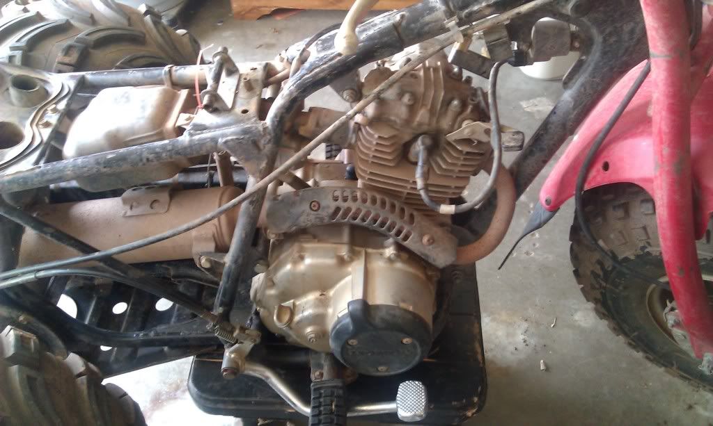

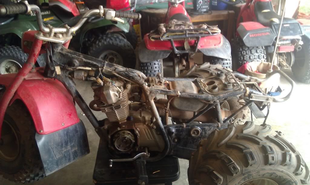

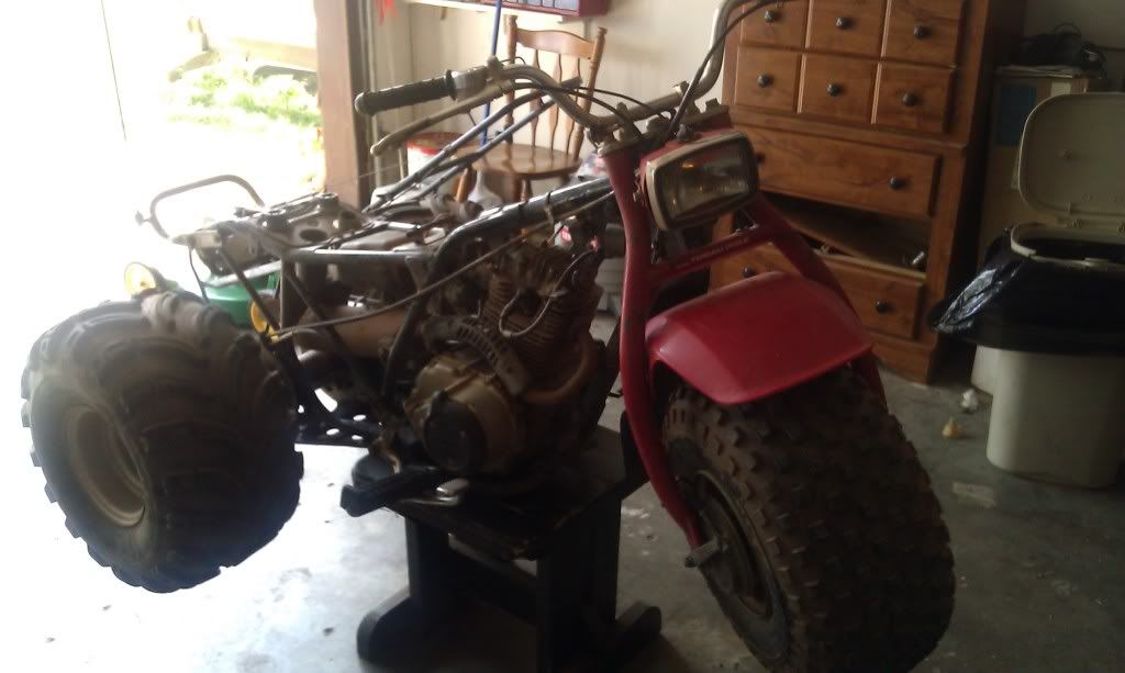

    Well here I go again I blew my Honda 185s top end but I think Im just going to rebuild the whole trike here is what I am starting with. I will also post a walkaround video.
    If anyone has any helpful hints before I get started please let me know.

    My first question is will the engine come out of the frame without taking the top end off first?
    KASEY's Avatar
    ARIZONAS BIGGEST TROUBLEMAKER
    4,239
    Yes it will... Pretty easy too
    louisiana
    1,499
    takes about 10 mins to pull that engine

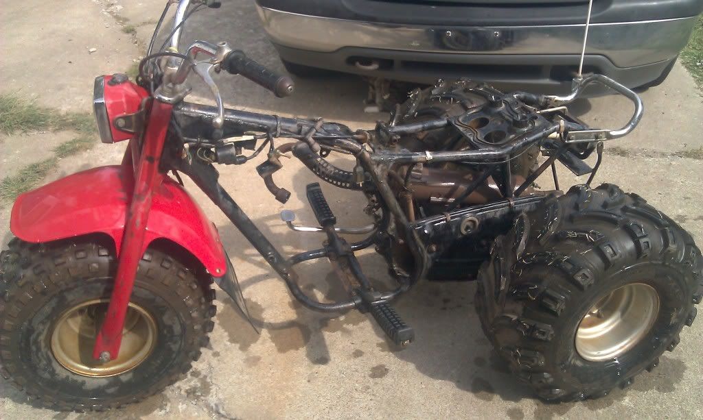

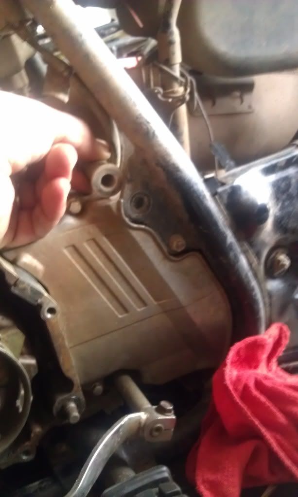

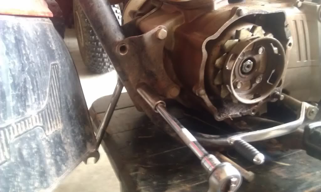

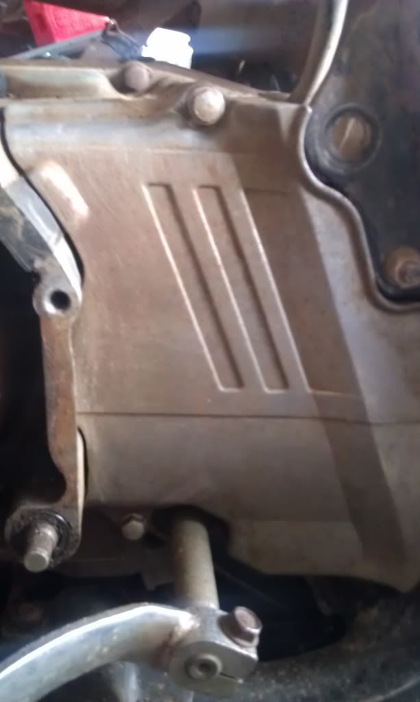

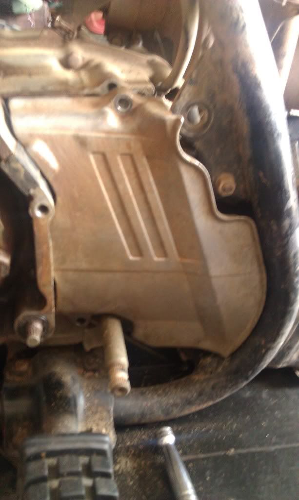

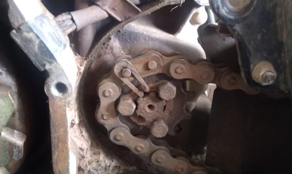

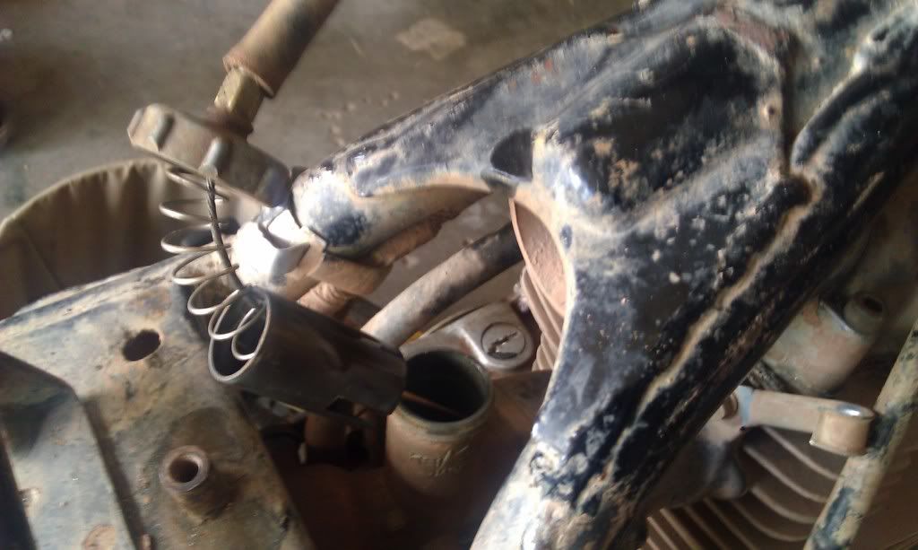

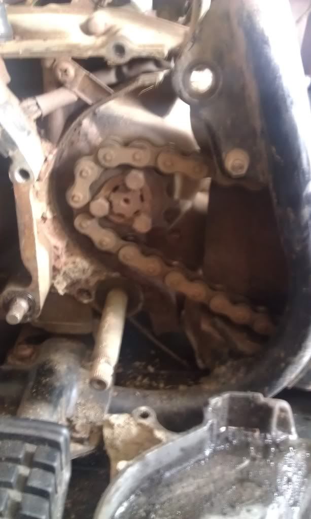

    ok I hope I am doing this right but this is what I have done so far...
    Motor still wont budge i must have missed a bolt somewhere.....

    few things i remember correctly.the following need to be unbolted
    exhaust header and silencer
    motor mounts:top of engine,front of engine,bottom rear mount,mid rear mount
    shifter
    loosen chain tensioners and move axle forward
    electrical
    carb.

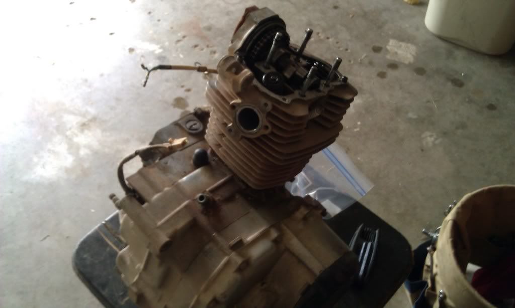

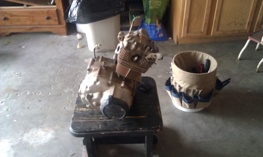

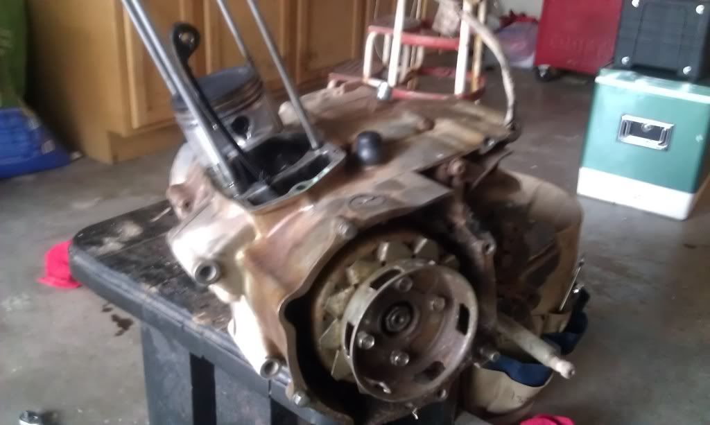

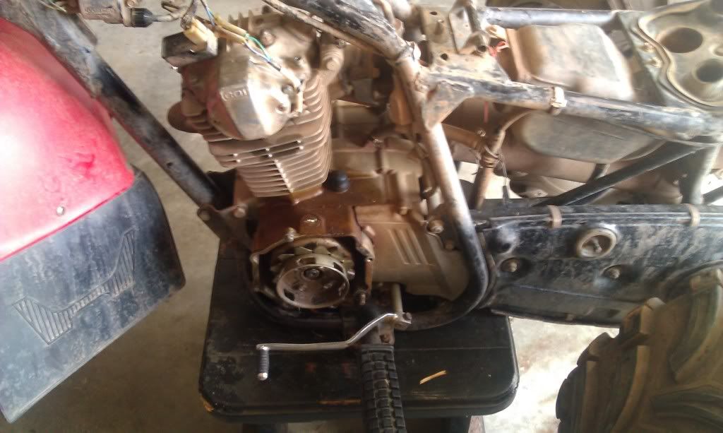

    Well I got it out now what lol?
    Apr 2009
    Oklahoma
    1,234

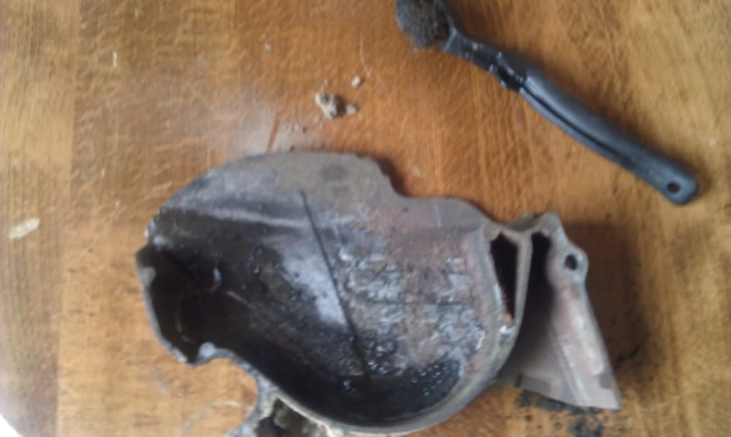

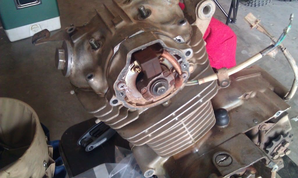

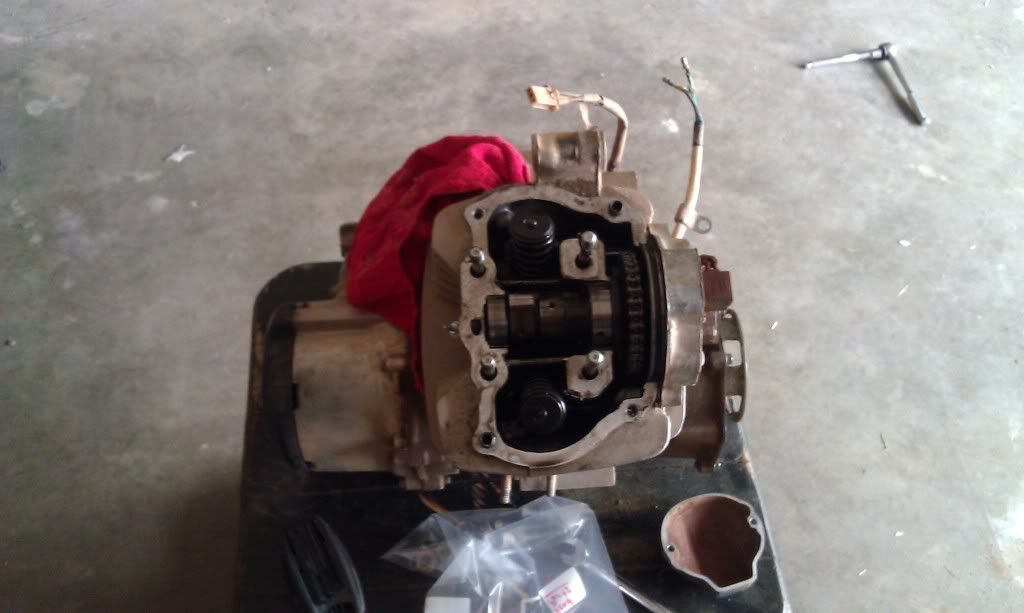

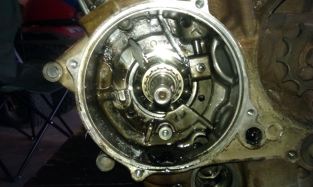

    Next I am going to take the side cover off. What do you think of that head?

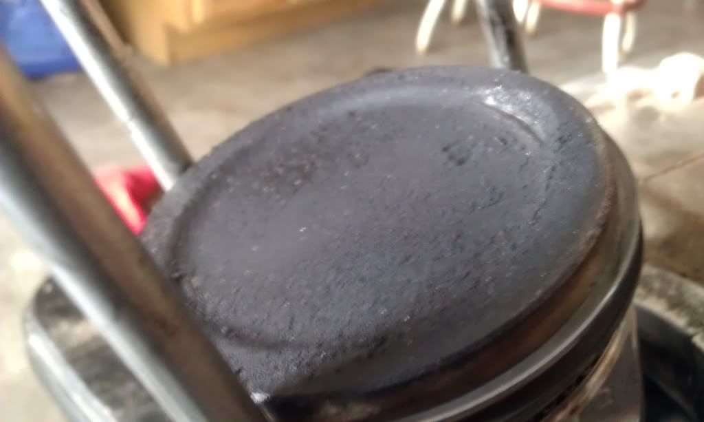

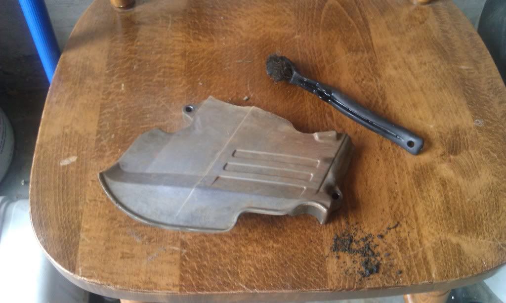

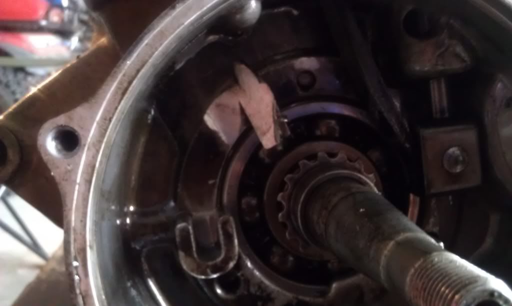

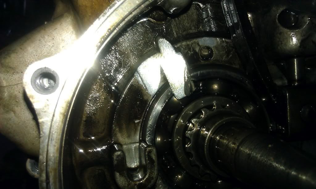

    Ahhh found the knocking problem hsve s look st thid!
    check the video what could have caused this?

    Your timing chain sprocket looks screwed..looks like your timing chain was slapping around then jumped. Judging by the knock marks in the top of the piston the valve timing went off..
    The knocking sound was the piston hitting the valve..look closer!!
    The chain rub marks on the inside of the engine cover is the least of your problems.
    Change your oil once in a while..look at the sludge in your engine!!
    Junk engine!!!
