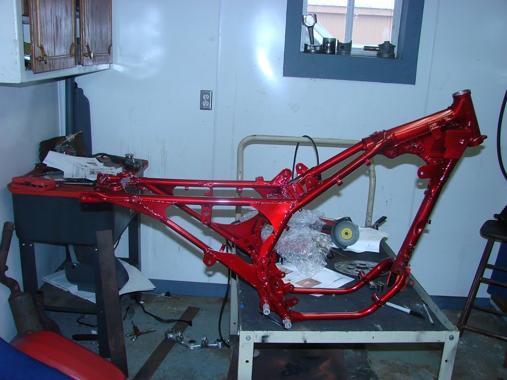

I made some progress today, my gusset kit should be here Tuesday according to Fed Ex

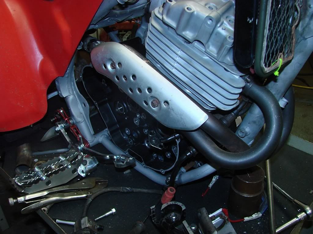

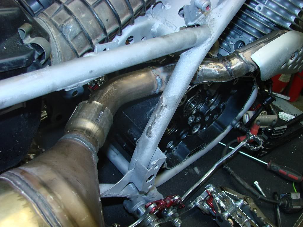

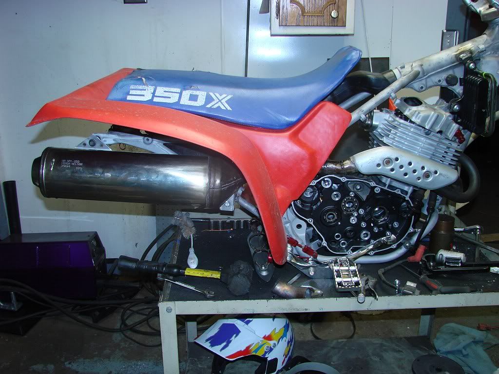

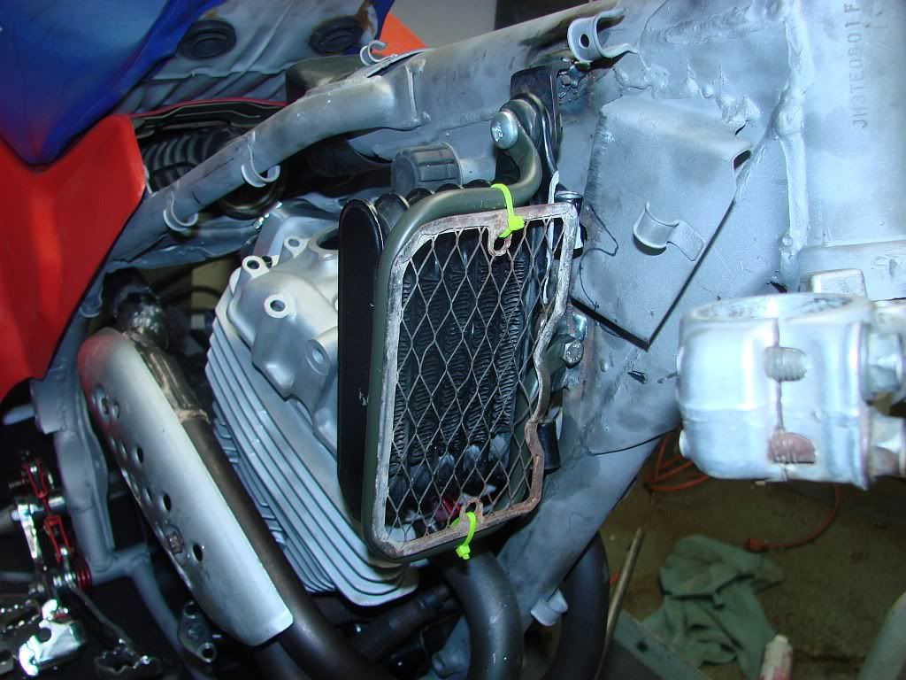

My Piston and Cylinder showed up so I assembled the bare case and installed it in the frame to mock up the Exhaust:
It is a 400EX head pipe with a 450R Muffler

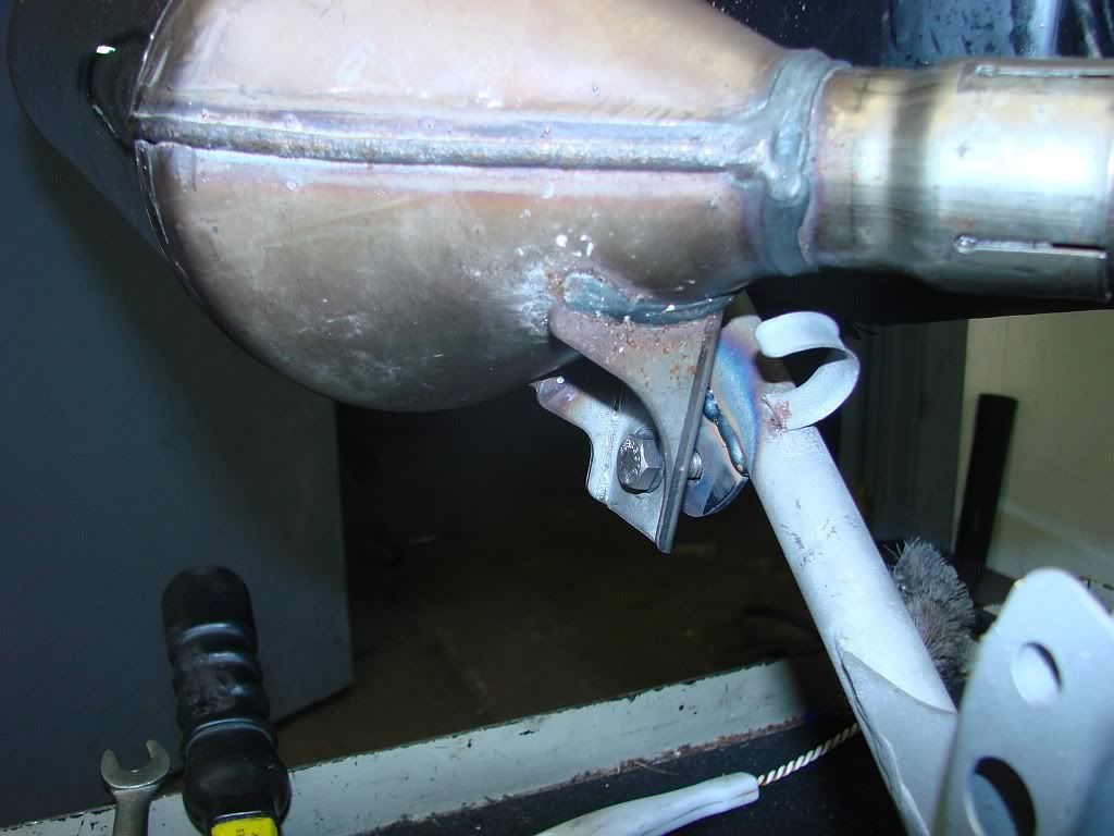

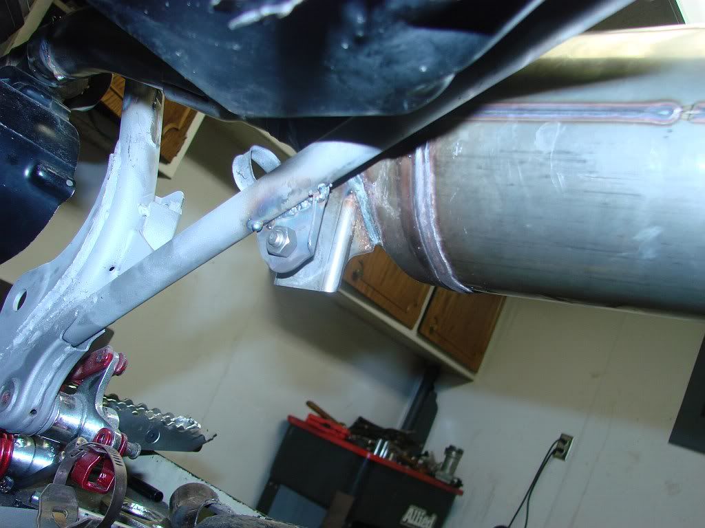

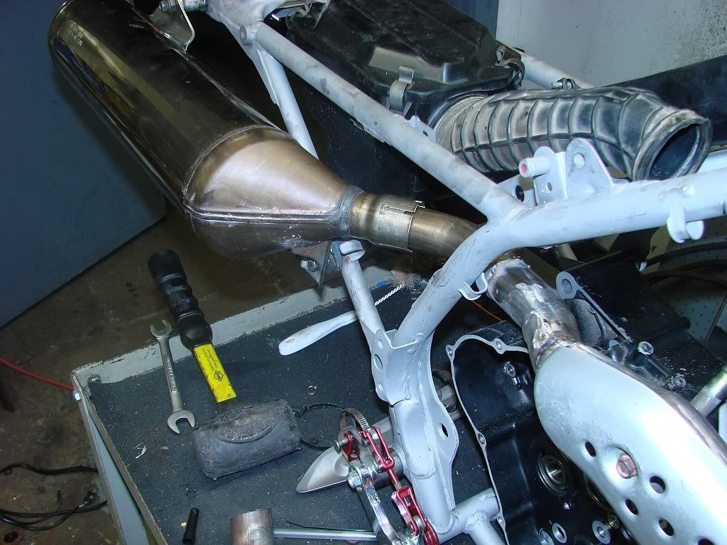

I cut off the stock exhaust mount in the middle of the frame and recycled it for the 450R Muffler, I also cut the rear brake reservoir bracket off the frame I am going to move it to keep it further from the exhaust, but want to see what the gusset covers in that area before I weld it on :

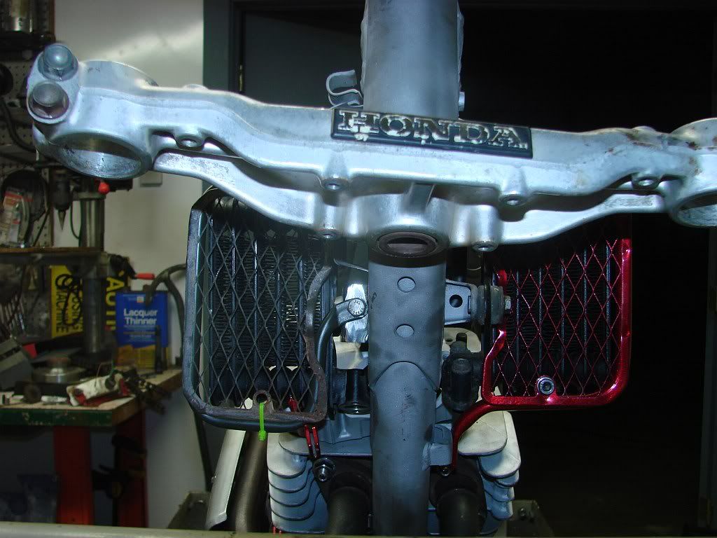

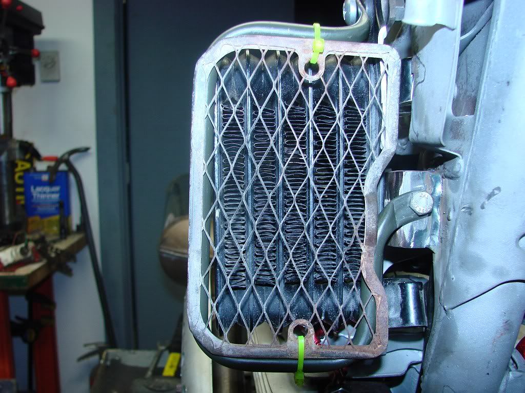

I also made a new frame for the 2nd Oil Cooler I am going to mount the grill to it with Adel Clamps:

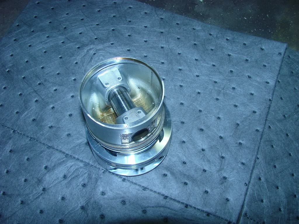

Here is a shot of the piston:

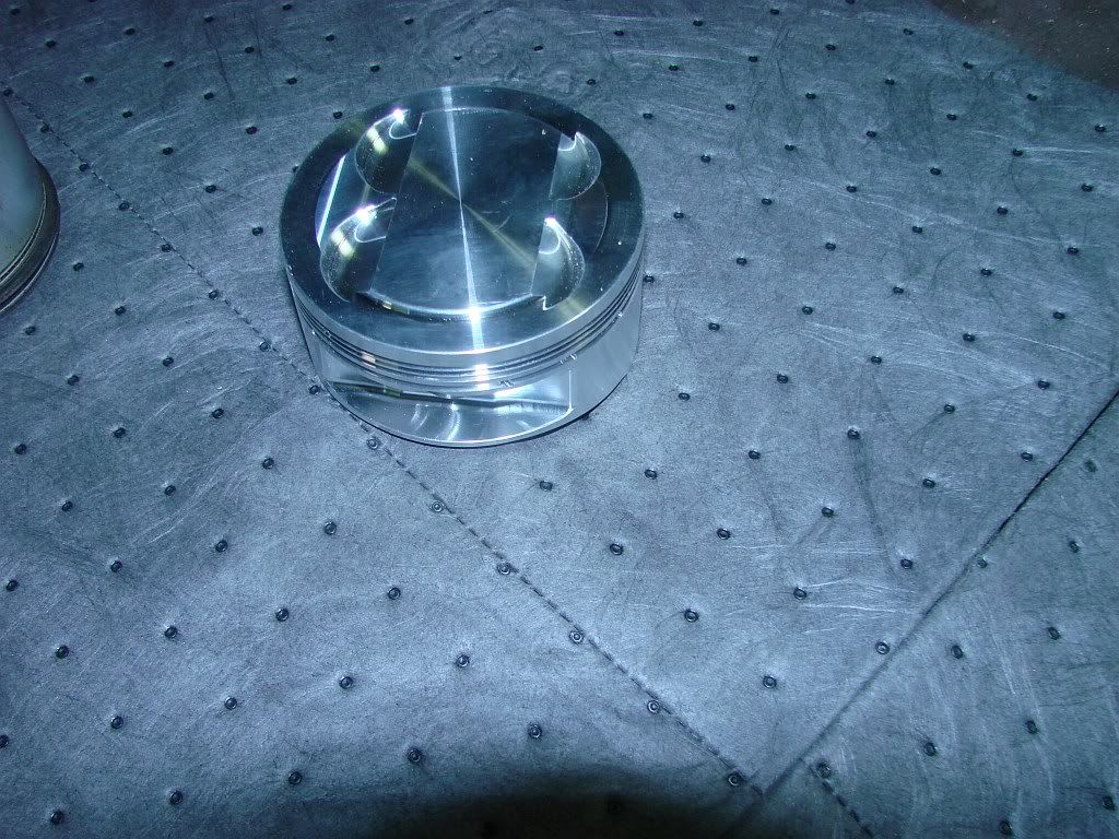

New Vs Old, just a bit bigger lol:

I still have a ton of work to do, but most of the dirty work is done. Plumbing the 2nd oil cooler looks like it is going to be fun, there is not a lot of room up there.
