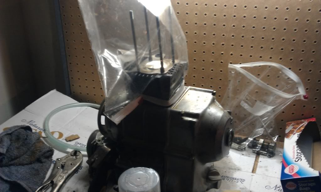

    Engine is going together. Waitin on a head

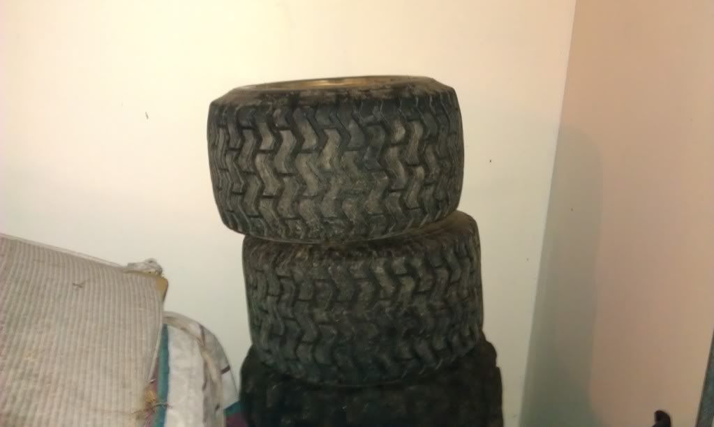

    Want to use these tires:

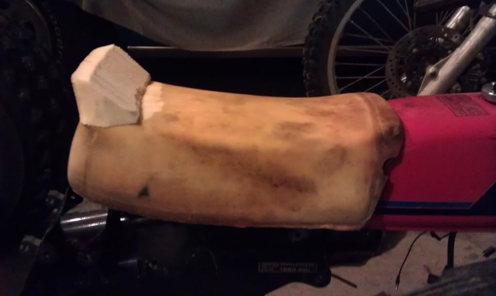

    Look at my seat!

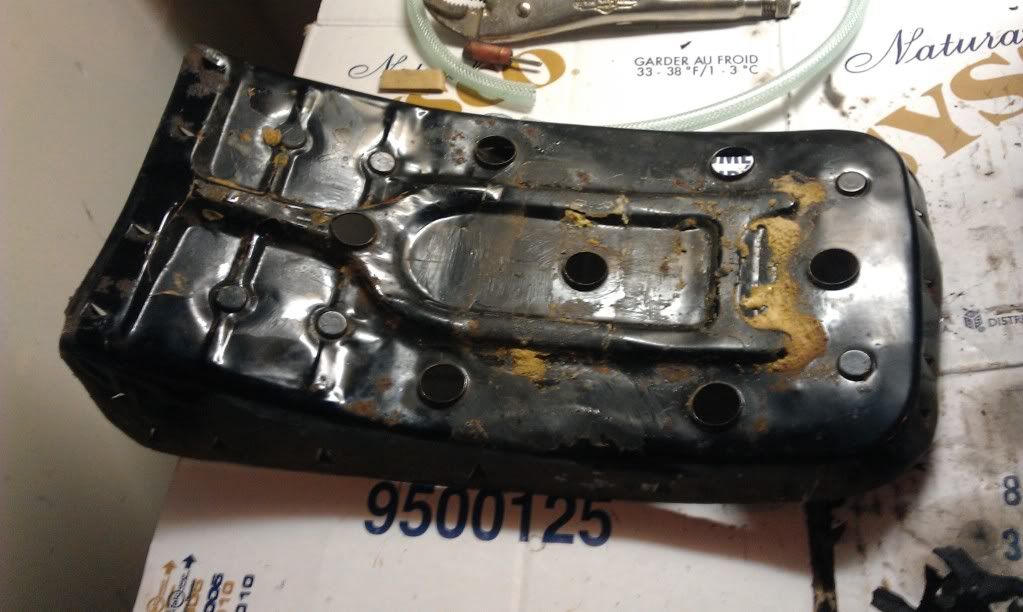

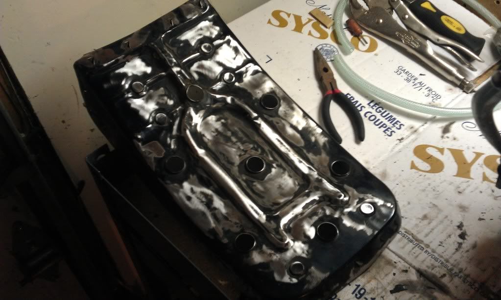

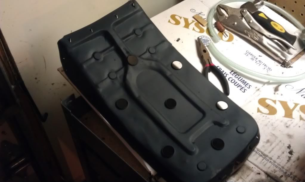

    Ready for glue and a custom cover!

    Small update,
    brake shoes came yesterday, and i got glue for my seat.

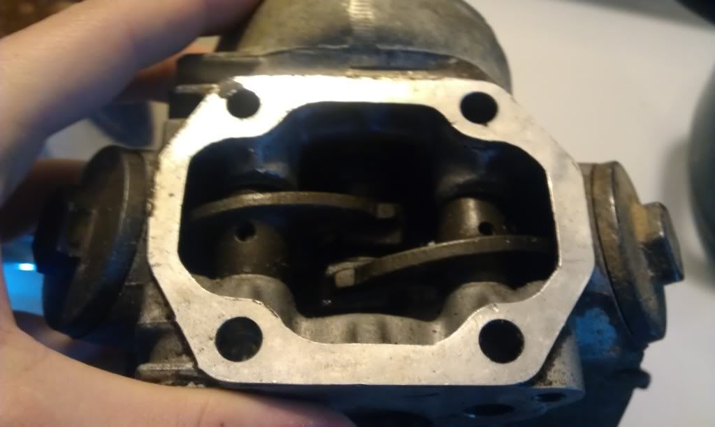

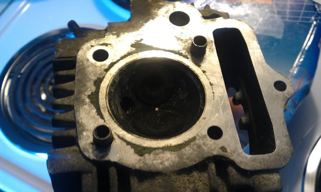

    And on top of that, the valves are in the wrong holes. Who does this? Really.
    Thats funny right there ! That poor bike good thing ya got it away from that guy.

    Looking good, and you got it for a good price too. Are you pretty handy at recovering seats? I like the little kicker of foam at the back. I sent a PM to Mrs Mosh to inquire about fixing mine up. Where did you find a new head? If you find yourself with two pull starts somehow, I could really use one.
    Yeah that guy was crazy.
    I think i may have forgot the dowels where the cylinder goes into the case..hmm
    haha. at least i dont have the head on, the cylinder will pop right off.
    gotta make sure, you know?

    The spoiler on the seat is just my own fancy add on. I shall be the first to do this! I think...
    My friend will stitch up a new cover once i giver her some templates out of thin cardboard or paper.

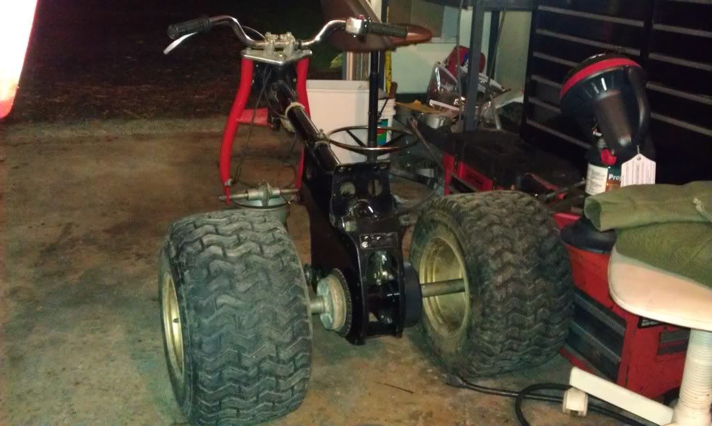

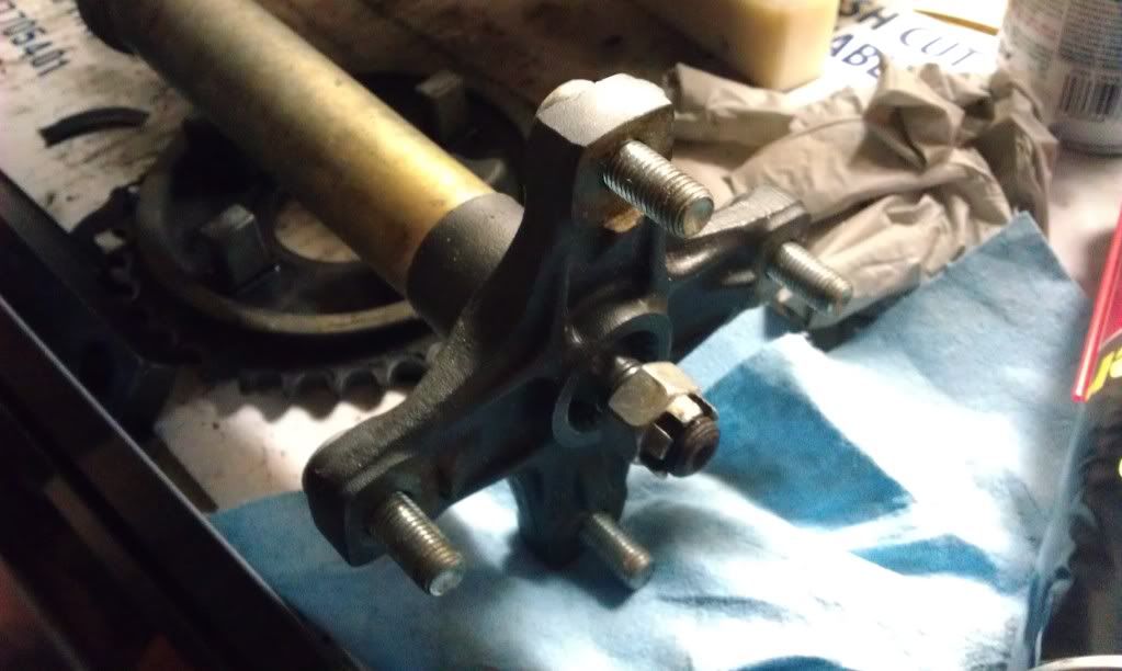

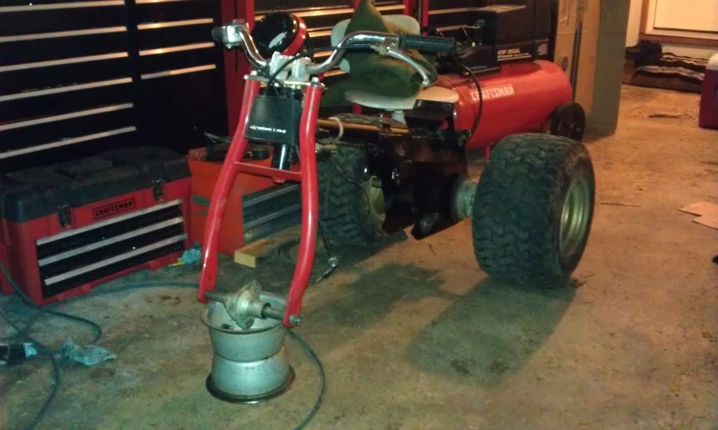

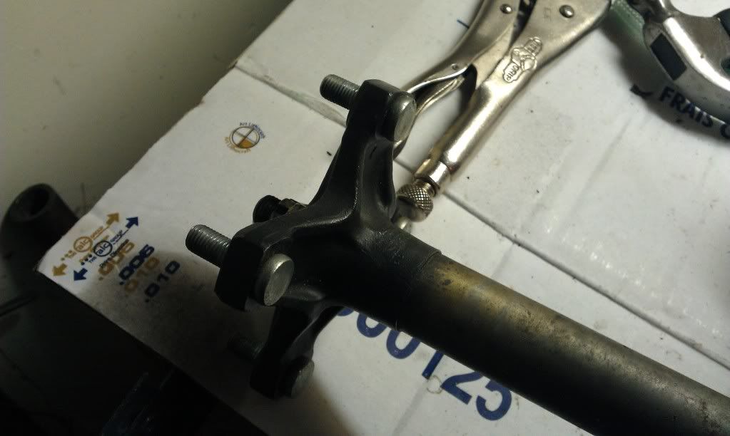

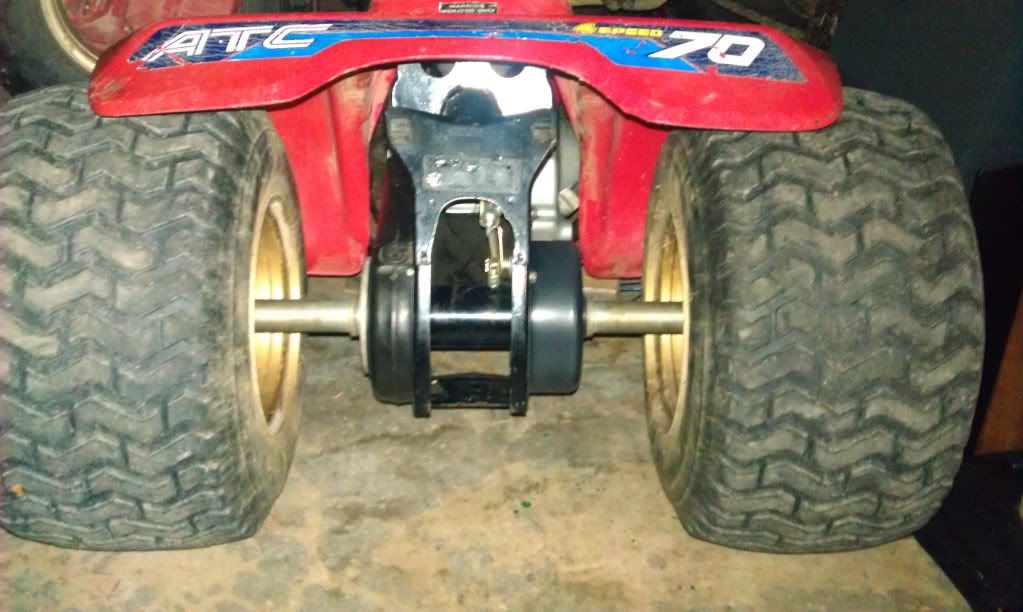

    Got the new 200x rear hubs today! Fit like a glove!
    Now i can run honda 4/110 bolt pattern wheels!
    My new head is in shipment on its way!
    Progress should accelerate once i get the head!
    Need to run down the freeway to get a front tire and wheel.
    This guy is selling tires and wheels for 20 bucks!
    Might buy a brand new tire and mount it on my rim.. hmm.

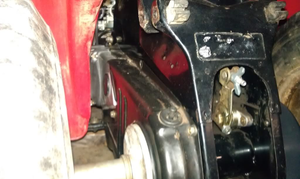

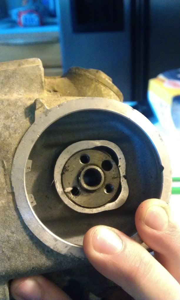

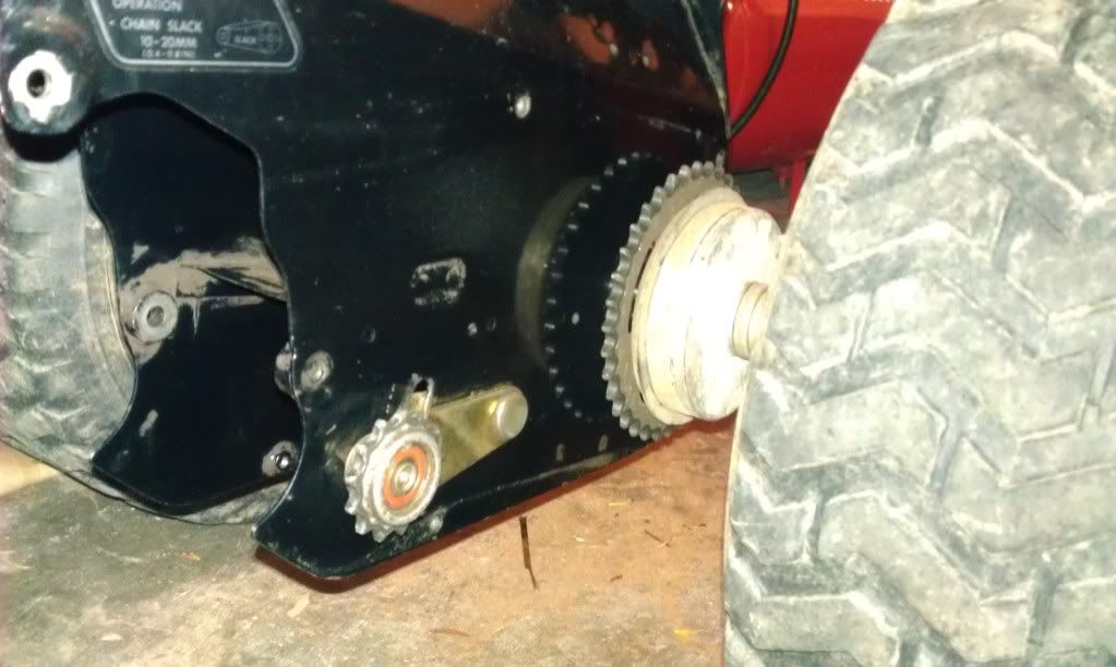

    Hubs!
    Rear drum mounted up after a clear coat.
    Mock up of the rear tires!

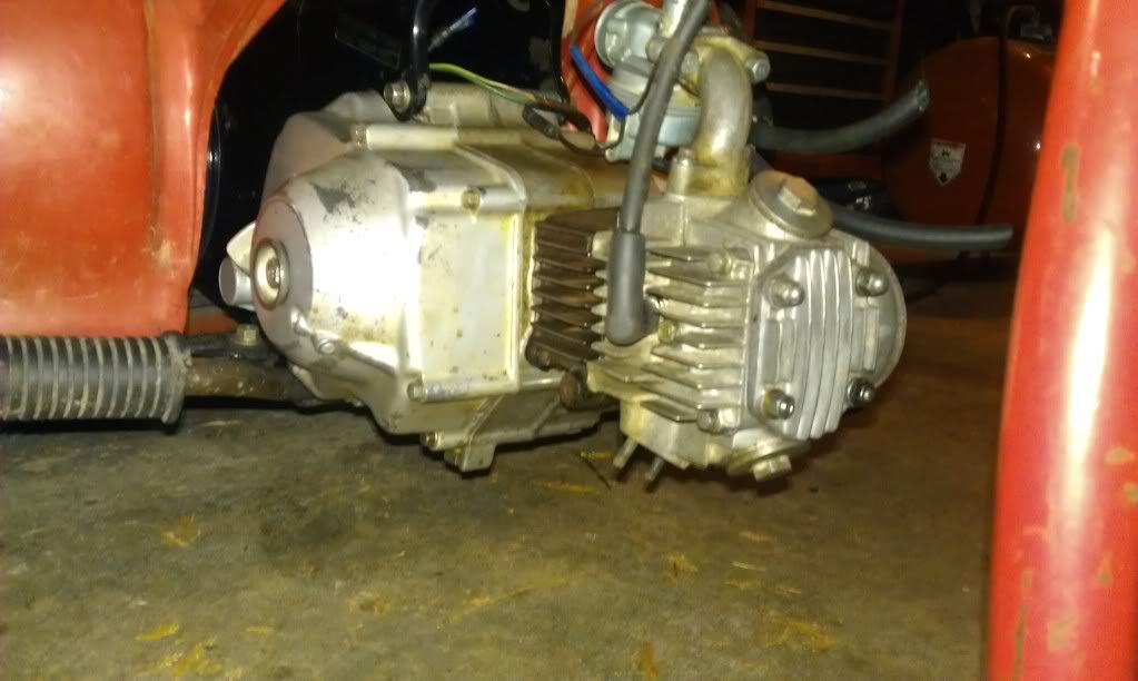

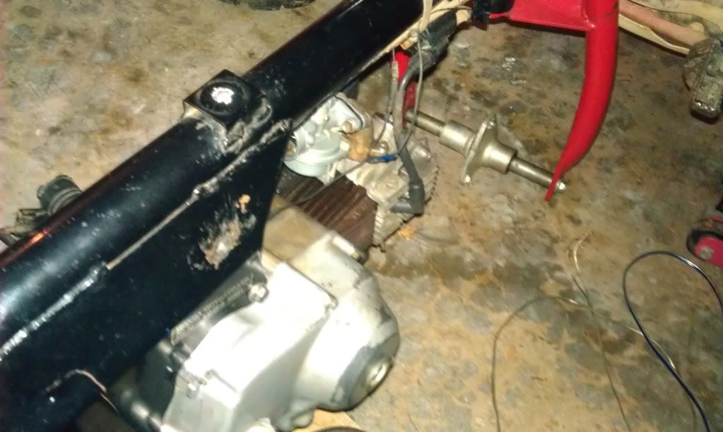

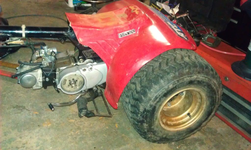

    And here is the engine...sitting, waiting for the head. lol

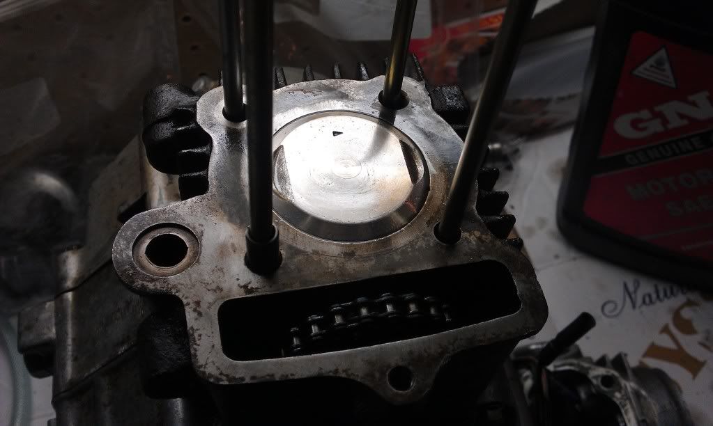

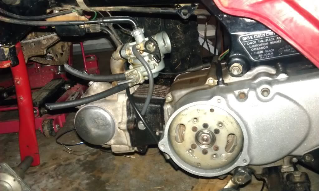

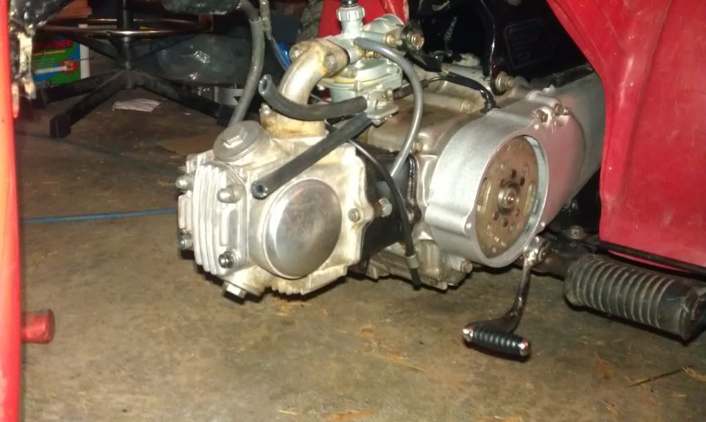

    Okay, lots of progress today.
    Got the engine completely rebuilt, timed, and valves set.
    It seems, when you tighten the 4 cylinder head nuts, that they just keep tightening endlessly.
    Im afraid of wrecking something by keep on tightening.
    Not stripped of course, they just seem to take forever to tighten all the way down to the required ftlbs.
    Anyway, heres what i did today.

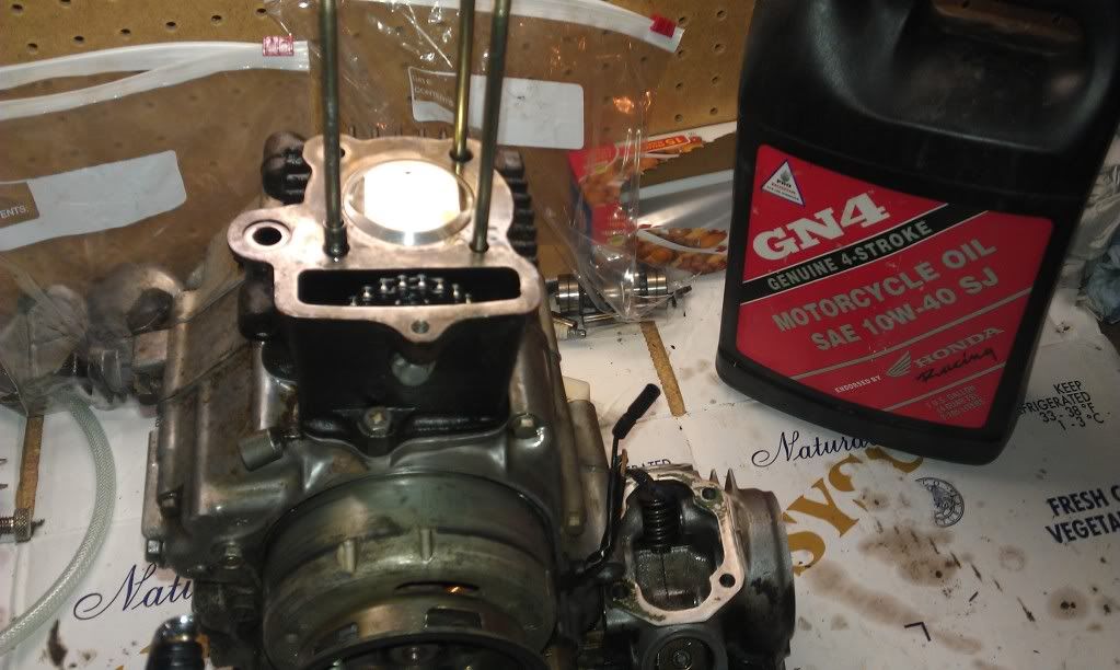

    Got the head
    After that I cleaned it up and took the rockers out and the cam and replaced it with my lower hour cam and rockers.
    Then put everything together
    Looks good with those tires! right???
    But now...I have to take the carb off and one engine bolt nut, because i forgot the airbox. Haha.
    So do i keep tightening the nuts on the head till i get the specified 8 ft lbs? Or what..
    Thanks guys.

    Okay, used some gasket stuff on the carb because i didnt have a gasket, and waiting to put that back on the trike.
    Also am looking for some sealant where the carb intake boot connects to the airbox because of course that isnt held anymore.
    Bought a half link because the chain is so stretched out the tensioner can't pick up the slack.

    Quote Originally Posted by 350xx View Post
    Small update,
    Nice job on your build. Actually the first gen 70's had a "spoiler" built into the seat foam.
    I will give you a nickles worth of free advice, and anyone else thinking about doing this.
    DO NOT USE GLUE ON YOUR SEAT.
    Unless you want to buy new foam everytime you need a new cover. If your cover is made and installed properly, you will not need glue to make it lay flat.
