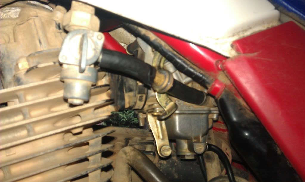

    I am trying to come up with a better fuel line and filter setup. can anyone provide a picture of your setup? There jst doesn't seem to be enough distance from the petcock to the carb... Any help is appreciated!

    There is enough room if you run the short clear filters. Not allot, but it does fit.
    Also, in the past, I have run the tube around the carb an d then into the inlet in order to fit a filter in there.................
    If I think of it, I'll take a pic.....

    There ya go. That IS the best way.

    Perfect! I just need to find a filter like that. Thanks!
