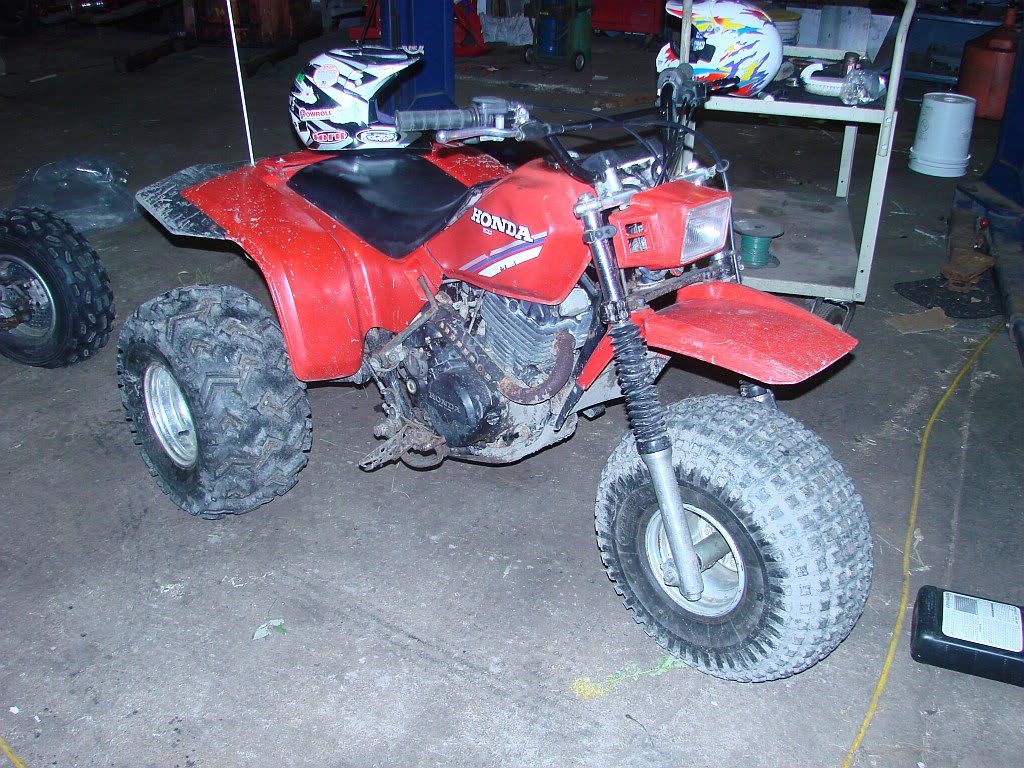

    I mounted my mud sharks on stock 85 350x rims and mounted them with 1" aluminum spacers from E-bay:
    The mud sharks seem to work pretty damn well. I don't know if I would have chosen them, but they were thrown in with the 350x when I bought it.

    i never knew that the 350x was the same bolt pattern as a 250sx?

    All of the larger ATCs have the same bolt pattern..4/110
    200x, 250r, 250es, 250sx, 350x..front wheels aren't interchangeable but the rears will, besides the tires not being correct for the machine they work.

    'murfman', you should find a similar mate for the front..you will be amazed how it improves the trikes handling and steering!!!
    Those knobbies suck!!
