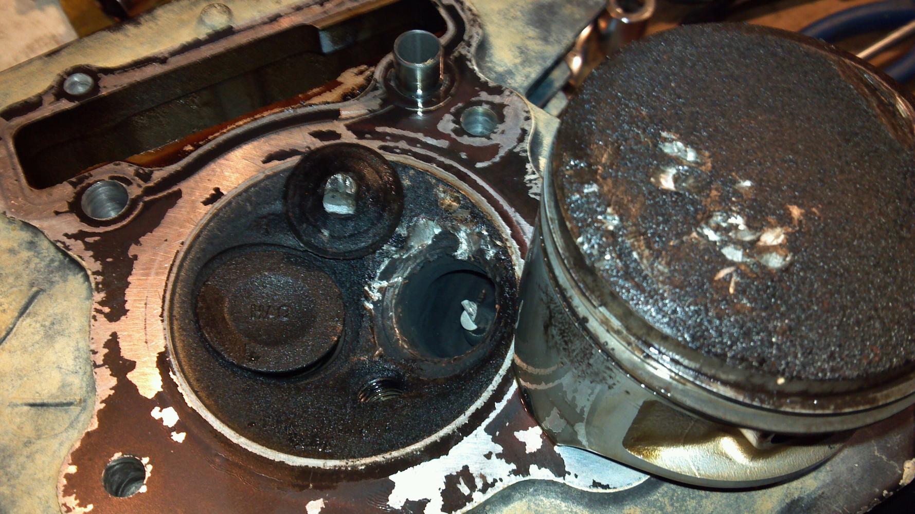

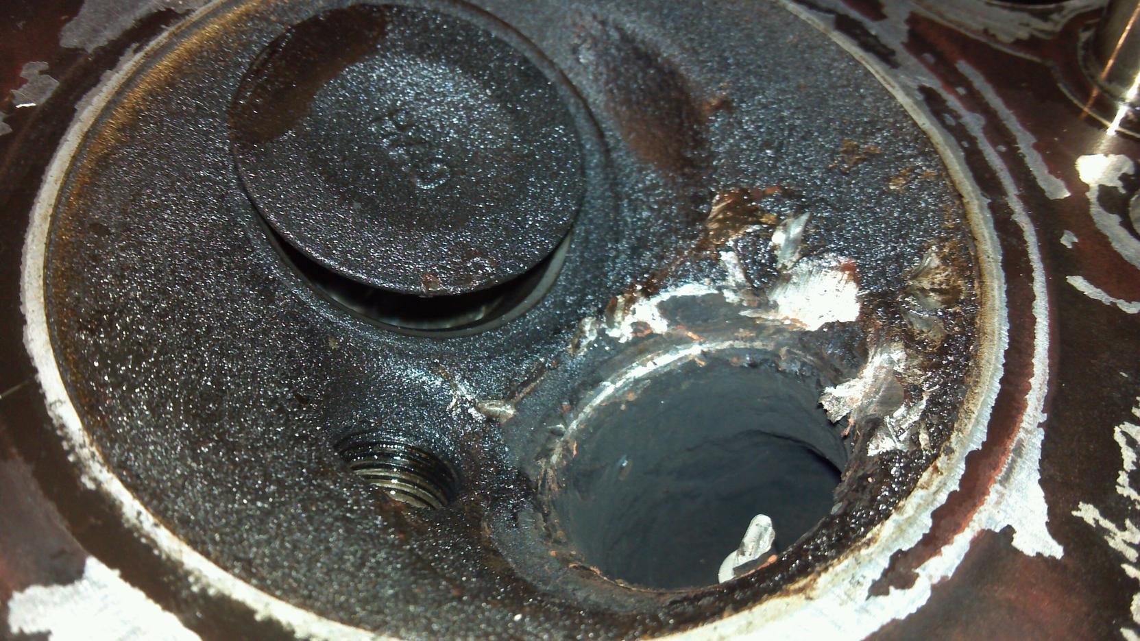

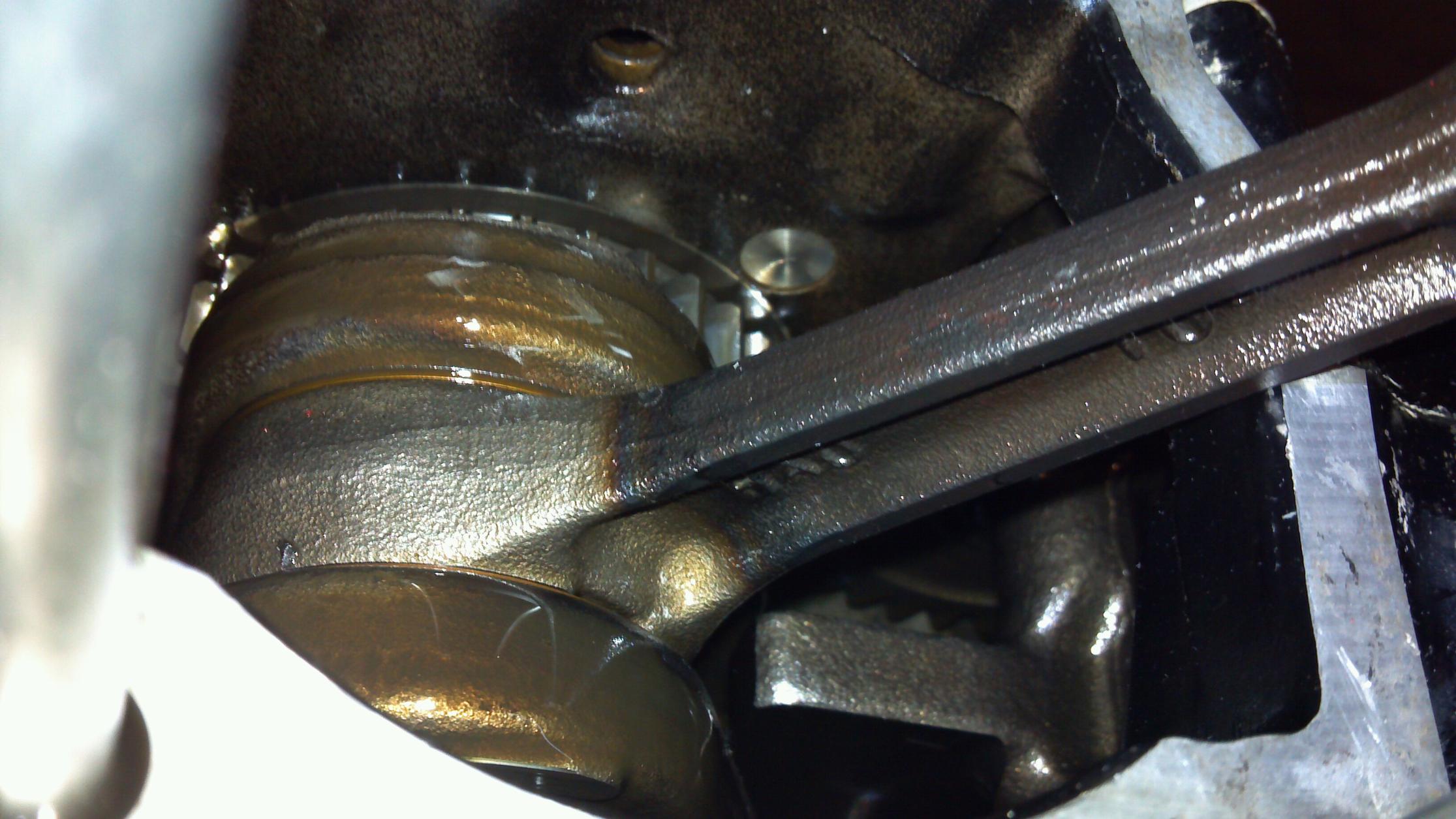

    Suggestions and opinions on what could have caused this! I worked on a quad for a guy and he gave me a 1985 250SX but the rear differential was demolished in it. I put up an ad on CL for one and got a steal on one for $100 but not without consequence. The guy told me that the timing chain fell off the top sprocket and was
    laying in the bottom end and the motor wouldn't turn. He said it was just sitting there idling and it died and wouldn't start back up. I pulled the motor since I am
    going to fully restore it and wanted it down to the frame anyway. I started pulling the top end off and looked in the valve adjusting cover and could see the chain was still there and looked normal. I thought " Uh Oh". Then got the head off and found a disaster with a bent valve, broken valve, and a chewed up piston and
    combustion chamber including the valve seats. I checked everything out to try to find a reason this happened and everything looked good. The rod is straight
    and not overextending, normal free play, crank looks good, etc. The only thing I can think of it that the valve lash was never adjusted and the valve slammed
    shut too hard and that's what sheared the head off of the valve. The guy said it started sounding like a "chain clatter" before it quit. I run my own small engine
    repair shop and think I am right but thought I would throw up some pics and see what other opinions you guys have. Just kind of a open discussion on it. I have
    the first one that was given to me that seems to have an okay motor but am going to do a full rebuild since it's a restore so I'm not too worried about it as it will
    be fixed anyway but like I said, Any opinions are welcome. Maybe someone has a different logical explanation for it. IDK. My only uncertainty it the rod has some
    discoloration on it like heat coloring but I have seen this before and thought it was normal from heat treating during manufacturing. Usually I don't see much of it
    left because of wear and oil staining but this one is pretty prominent. Let me know what you guys think. I hope I can get the pics up since I'm
    new again. Thanks! Click image for larger version.

    when the timing chain fell off the exaust valve was probly open and the piston broke it cause the engines are zero tolerance engines or, the chain got so lose and jump a few teeth and then the piston hit the valve and then the chain probly fell off, had it happen to one of my 200 engines, same deal.
