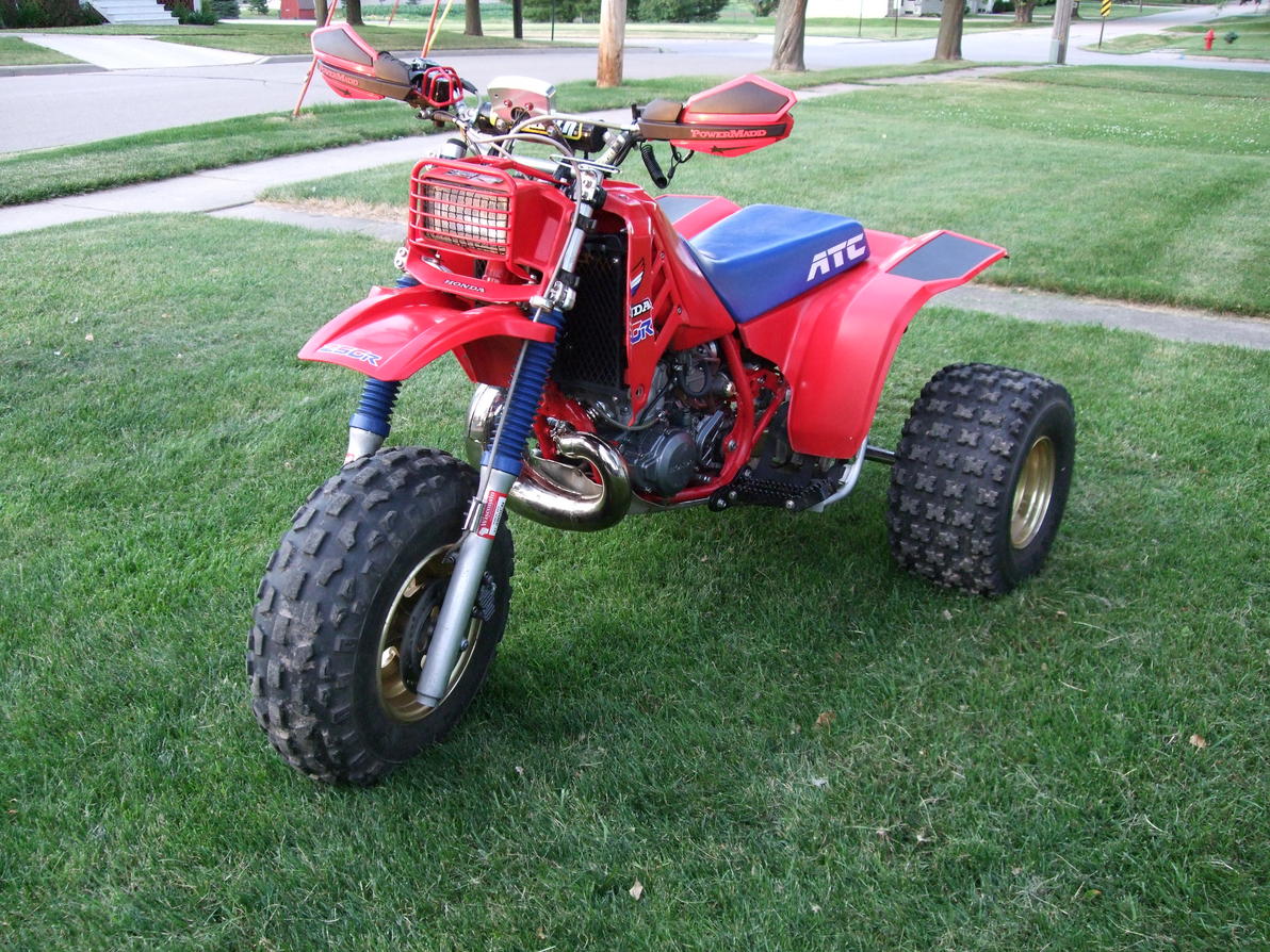

    These are Rath racing heel guards I put on. There for a 08 trx 450R. I then bought some stock 450R foot pegs and then some adapters from Jason Hall on this board to bolt on 450 pegs. I still have to make some brackets to fasten the top part of the heel guard to the frame. Its a couple hours of work. I trail ride and dont want the nerfs in the way. IMO.

    Nerfs are good for racing MX, Flattrack, and oval type stuff. In the trails they become a hangup and will drag in rutted sections. Pantera's pegs look like a nice alternative to full nerfs. If you notice the fenders on most 3wheelers come full almost to the heel area. Newer Quads have shortened rear fenders and have added the heel guards for saftey...and as a part that can be replaced once bent. Nobody makes nerfs specific to 3wheelers...I've talked to Rath and they'll make custom ones at shop costs for any machine. The basic roll of the nerfbar is to keep your competators rear wheel from entering your foot area and to avoid the tire on tire rollover/climb. The nets are nice for the boot slip off the peg.
