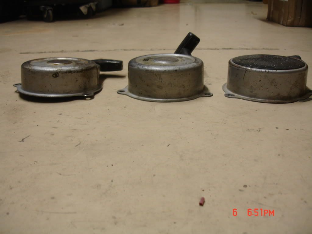

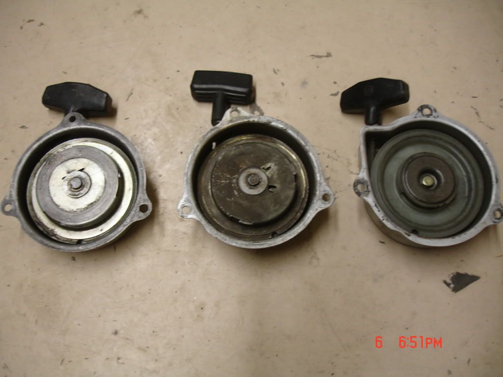

    KASEY's Avatar
    ARIZONAS BIGGEST TROUBLEMAKER
    4,248
    there are 2 different housings for the ATC and one for the trx's as you can see by the picts . the trx is totally different inside too..
    the trx is the one on the right side .. the narrow housing is the early years...

    Thanks Kasey! I can't get the pics to open here but I will look at them when I get home. The spring is my biggest issue. I seem to have gotten lucky and gotten pull starts on all the 70's I bought except one. My 87 TRX needs a spring though.
