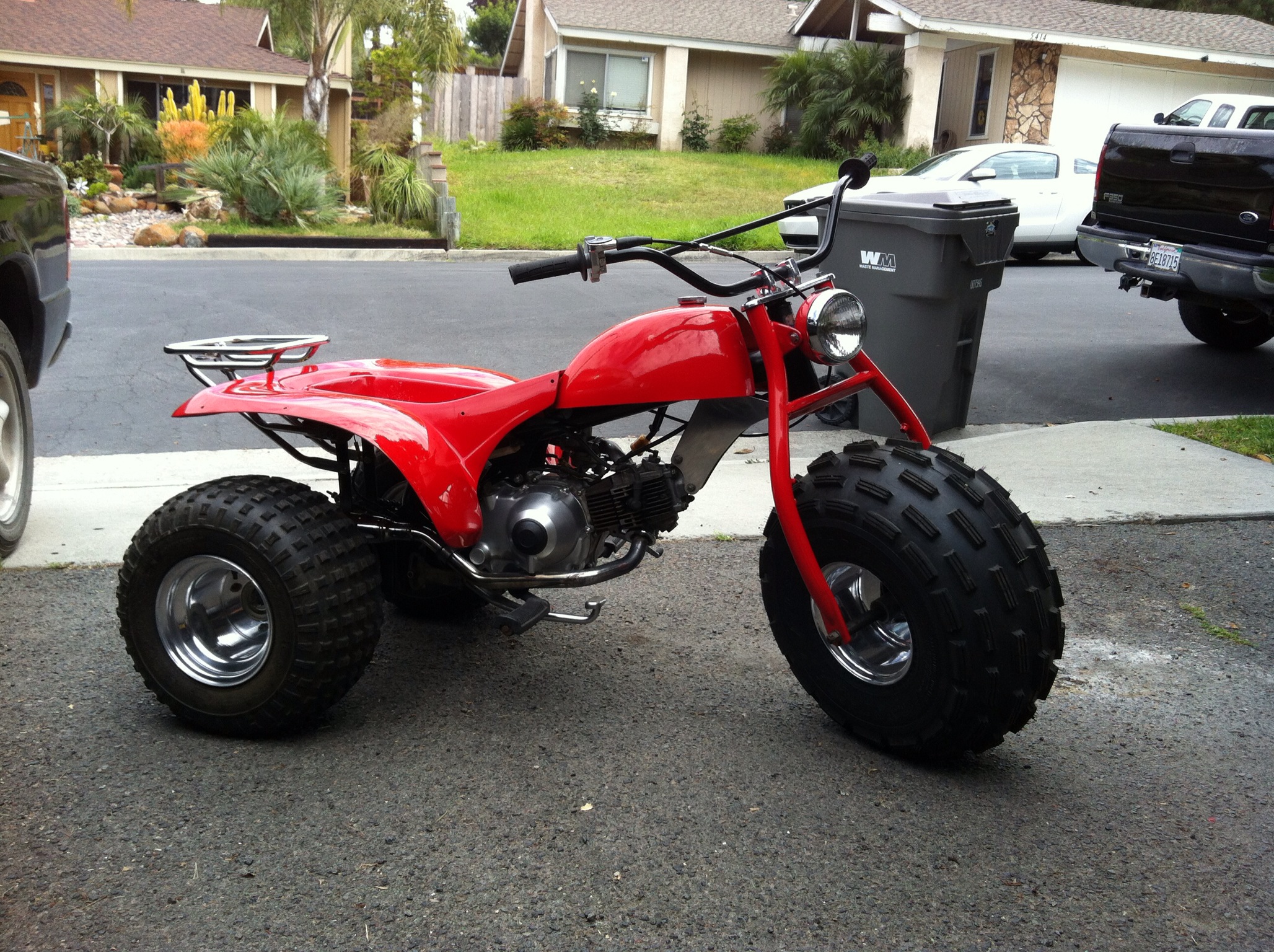

    This was the stuff I used. The Rustoleum came in quart cans. It was easy to use, just thin 10-15% with acetone and spray using detail gun. I dont think cans would have turned out as good. Cans dont put out the volume a spray gun does. I did however use Rustoleum silver metallic for the clutch cover and the side cover. I think it turned out great.

ID:	140802Click image for larger version.
    Here is the clutch and side cover. I am replacing all of the phillips head screws with stainless allen head buttons. What do you think?

Name:	90 1 .jpeg
ID:	178590Click image for larger version.
Name:	90 2 .jpeg
ID:	178591Its done. I just need to get the seat upholstered now Click image for larger version.
