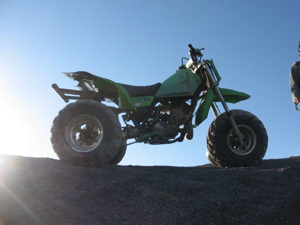

    Here she is in her glory. Far from mint but its the only one I know of in working order in half my country.
    So anyone who knows the 1984-85 tecates will know that the water pump has a small hose that runs into the cylinder. So can I use a T sort a speak and install it between the water pump and the cylinder and have wrap around the carb like mentioned.? Makeing it with a dead end would be easier to build. But will it circulate right? Im not looking for extrewe heat here just enough heat to melt the ice. I can see hoe a trike with 2 rads under the gas tank would help here blowing heat straight back.
