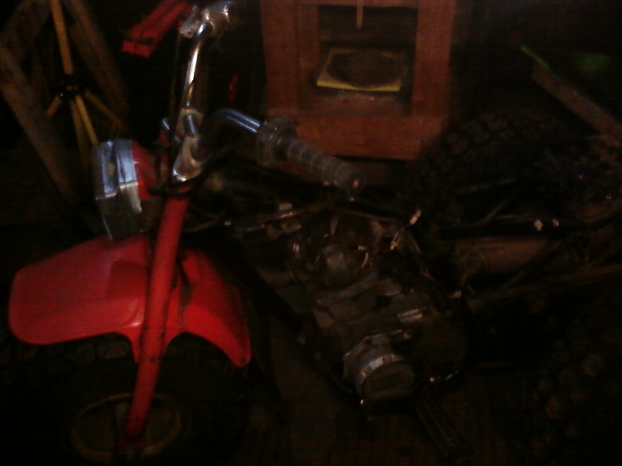

    Well, i just registered and i would like to know some facts on the '82 185-s's. the rarity, value, all that stuff. im planning on a full restoration soon, and would like some info. tell me what you know and i would be happy!

    as you can see, i have some little pin holes in the tank that i gotta patch, if i was brave enough i would use a tig welder and patch it them up, but im not that stupid. im going to fill them with bondo for the time being, and someday patch in a new piece. im also going to re do all that i can before winter, and i may pull the motor and re-build it, new wiring, ect. tell me what you think!

    The bondo will fall out in no time being soaked with gas...You can cover the hole with JB Weld and then coat the inside of the tank. Lots of threads on this site about cleaning and repairing tanks.
    185s isn't close to being rare....they are all over the place...you can get anything you need for them. Your wanting to do a full resto? I have only partially restored my 185s and I have over 1000 bucks in it. This is a hobby that goes from cheap to expensive very fast...for now you may just want to get it in shape to be a rider.
