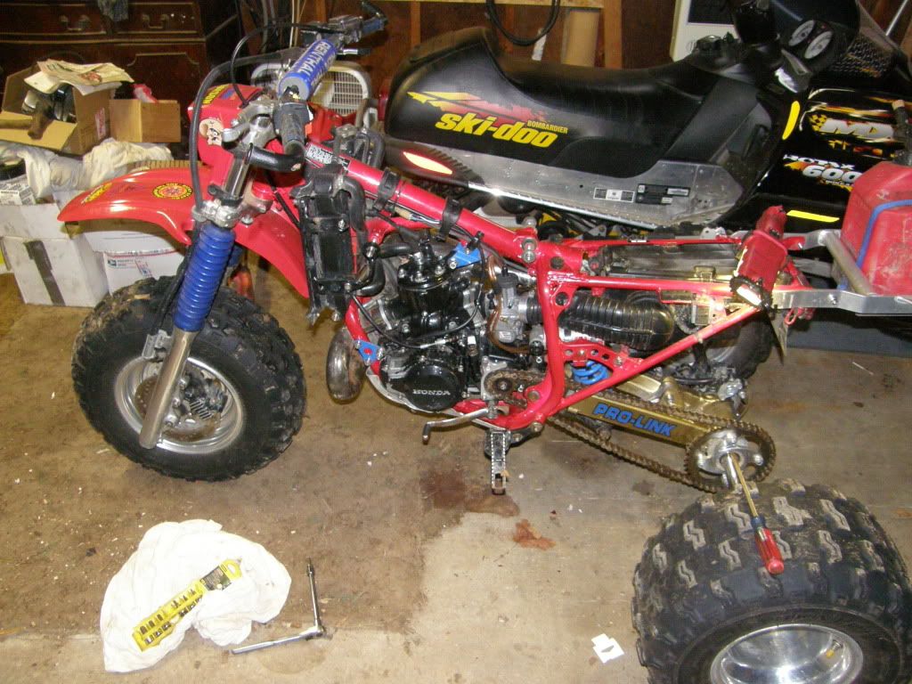

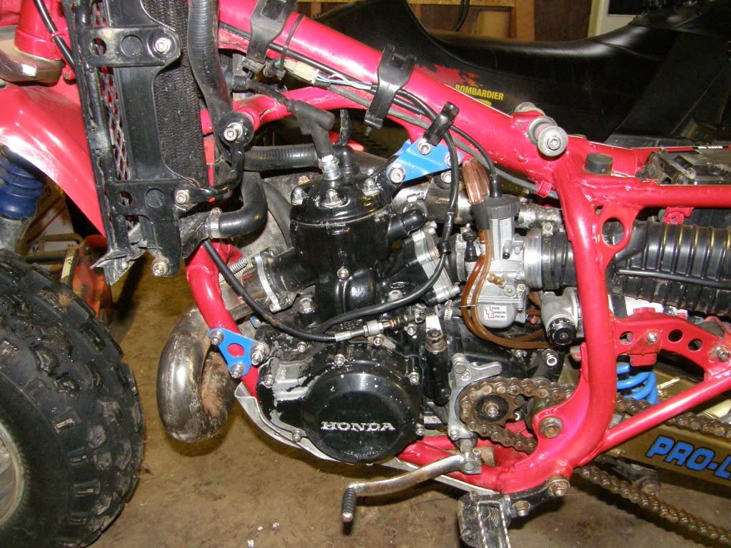

    So it starts....
    So long stock topend! It's been fun...You will come in handy for my near stock pump gas burner that's next in line to be built...
    What have I done??!!
    Now off to my brother's house to tear down the engine. He built/restored this trike as it is now and did a darn good job at it. We are going to have a good time in his garage enjoying coffee, cigars and maybe even a couple of brews while we tackle this little project of mine...
    Depending on my work schedule I should have my case halves boxed up and on their merry way to California for some quality time with Eddie Sanders!
    More pics to follow. If this is a bore to anybody, please let me know and I won't waste bandwidth. Maybe it's just me, but I'm excited to share this with my triker buds!

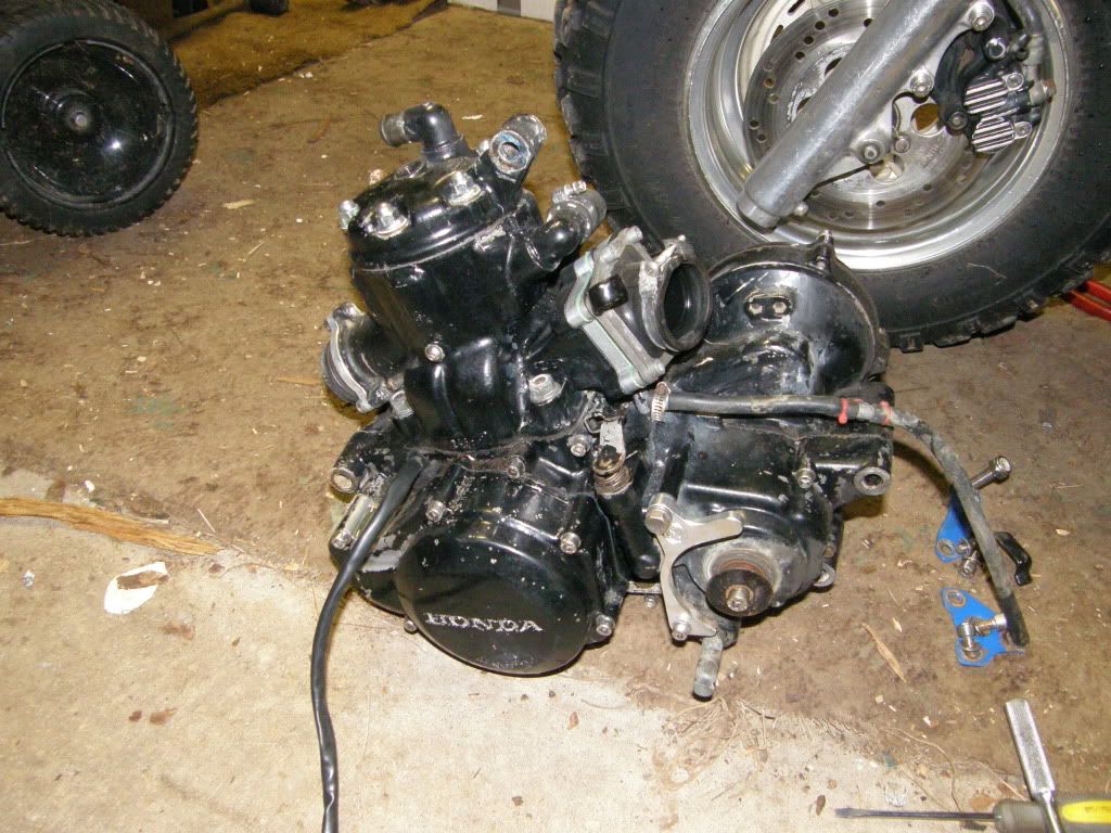

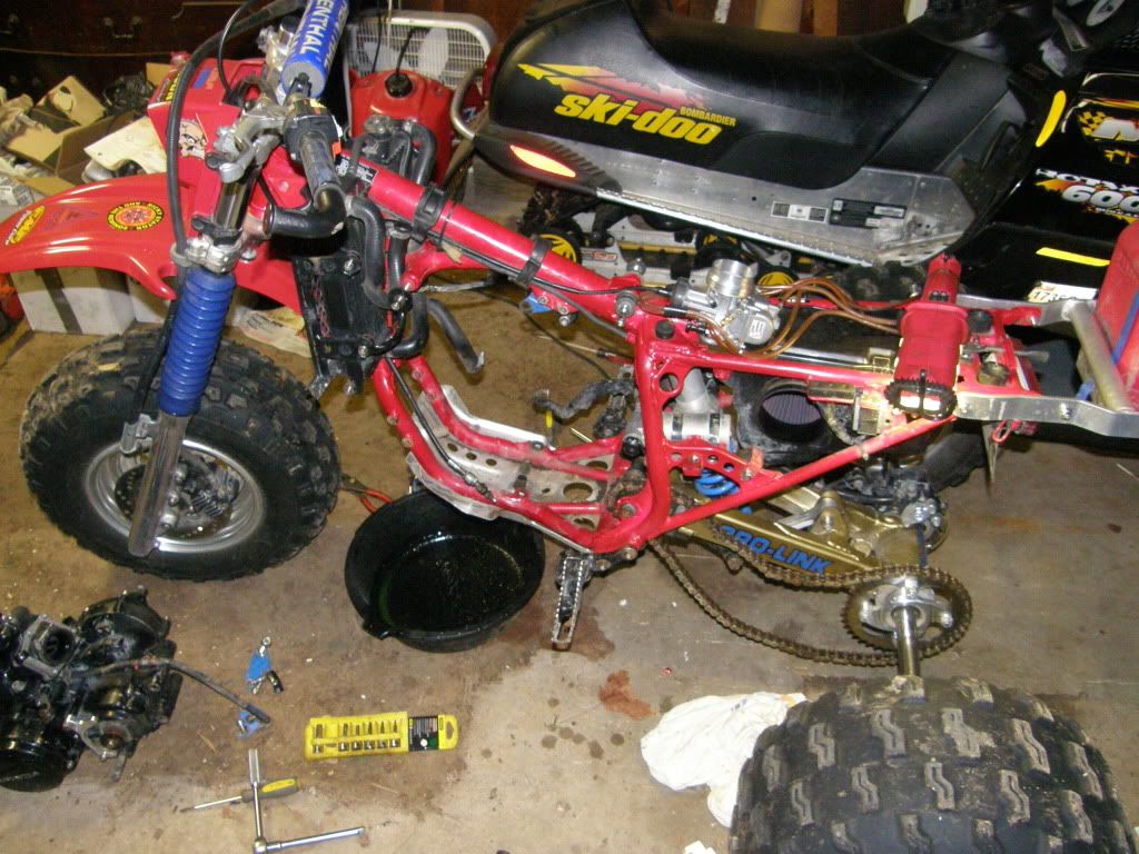

    Well, my brother and I got the engine disassembled today. Just need to clean up the case halves and ship em.
    I'm considering getting my crank rebuilt while I'm at it. Lower rod bearing feels and looks good but I'm thinking about getting it done just because....
    Anyone have any feelings for or against getting the crank rebuilt? It'll be another $165...... Worthwhile or am I going overboard?
