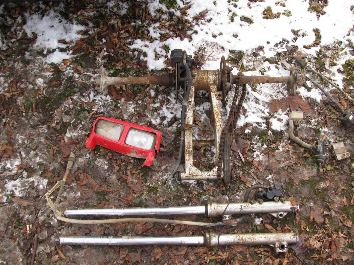

    Heres where Im at after this afternoon...
    Removed the swingarm bolt and front forks,rear master cylinder etc...
    The steering stem nut came off hard and I noticed marks on the stem,so someone probably didnt know about the adjuster nut and now the stem is mushroomed a bit and hard to start the threads,so Im just going to taper the edges with a grinder to get past the squished part of the stem.
    I need to pick up a steering stem socket to finish removing it.Im also hoping the 200x that came with the 350x has the same size ball-bearings in the steering stem,as the 350x is missing quite a few (hence the slop that was found)Here are some more pictures of the progress...Click image for larger version.

    Good start man.
    Personally I don't think the plastic tanks are a bad idea, but to each their own. You can always re-do your metal one or keep your eyes open for a good metal one in the mean time if you want.
    I'd suggest riding the trike before you extend the swinger. The only people who usually have extended swingers are the ones with a lot of extra horsepower or people who are racing, with the exception of the first gen Tecates. That swinger is just too short right from the factory. For a regular rider an extended swinger may actually take away from the experience of riding it. The 350X's handle great right out of the box and it's very helpful to be able to pull the front end up in just about any gear you want for surprise wash-outs and bouncing over logs and stuff. Not to mention just showing off.
