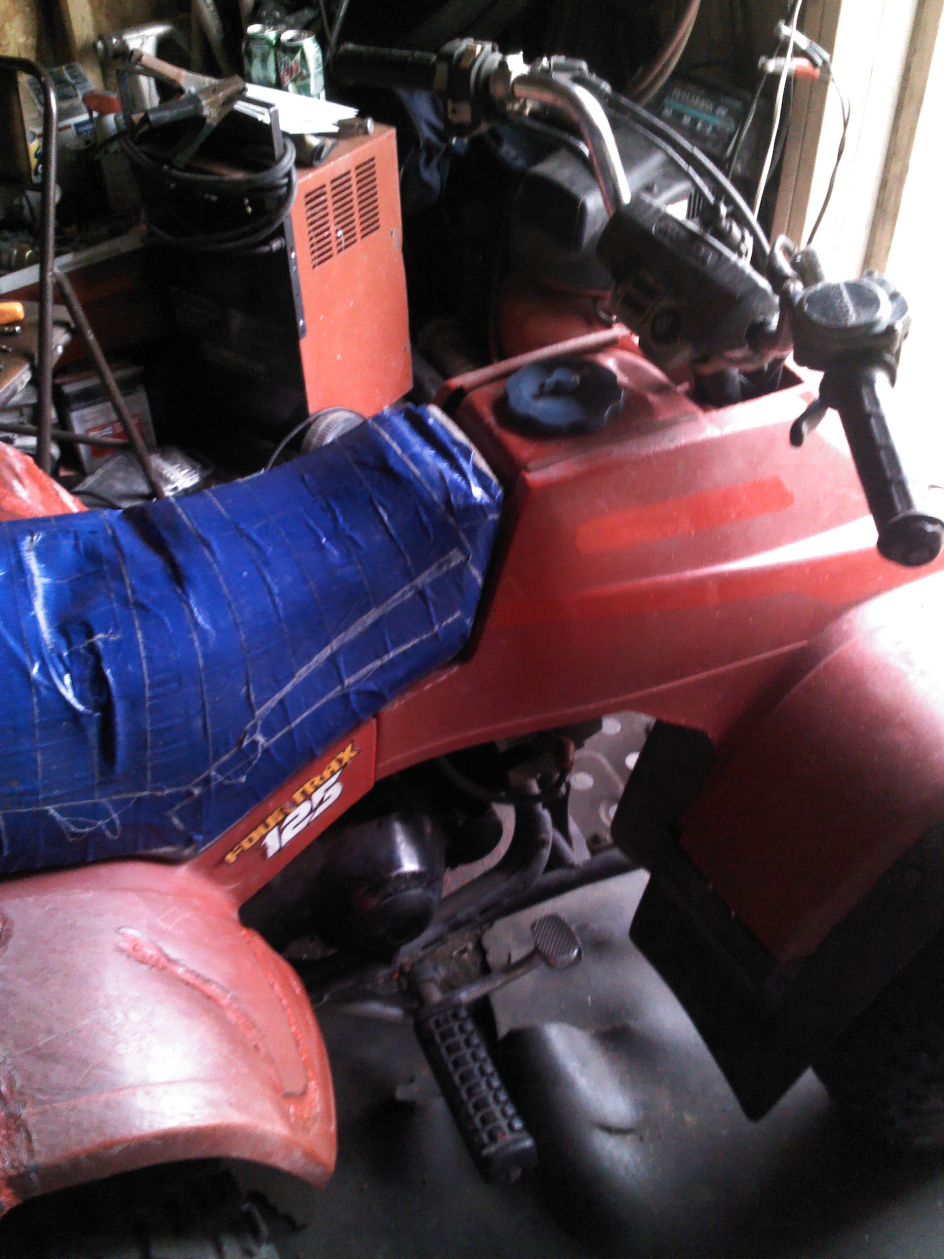

    I purchased my plastic welder from harbor freight a few years back and have since then performed many welds. the best welds are the ones where there is a bead not a complete melt. I have tried it both ways where I have melted the rod completely back into the material and smoothed it, and they always seem to break that way but when there is a bead like with steel welding they hold up to quite a bit of torture before cracking. Here are some pics of the welding I have done in the last 6 months.Click image for larger version.
