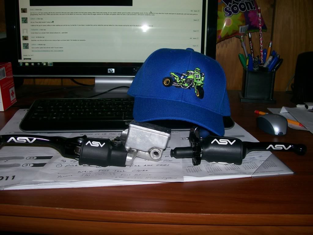

    The asv makes a matching lever combo for the brake too but for some reason they rmatv says it wont fit my bike. Is there site just misleading me?
    17,460
    I got some for about 14-40$ while watching auctions on EvilBay (ASV that is).
    I don't waste the weight of a parking brake, ( and they seize ) So I didn't run them. You should get a long front and that puppy should fit a couple machines. Run it a high loop above the top crosspad and or headlamp.
    OK
    5,450
    Quote Originally Posted by twitch101 View Post

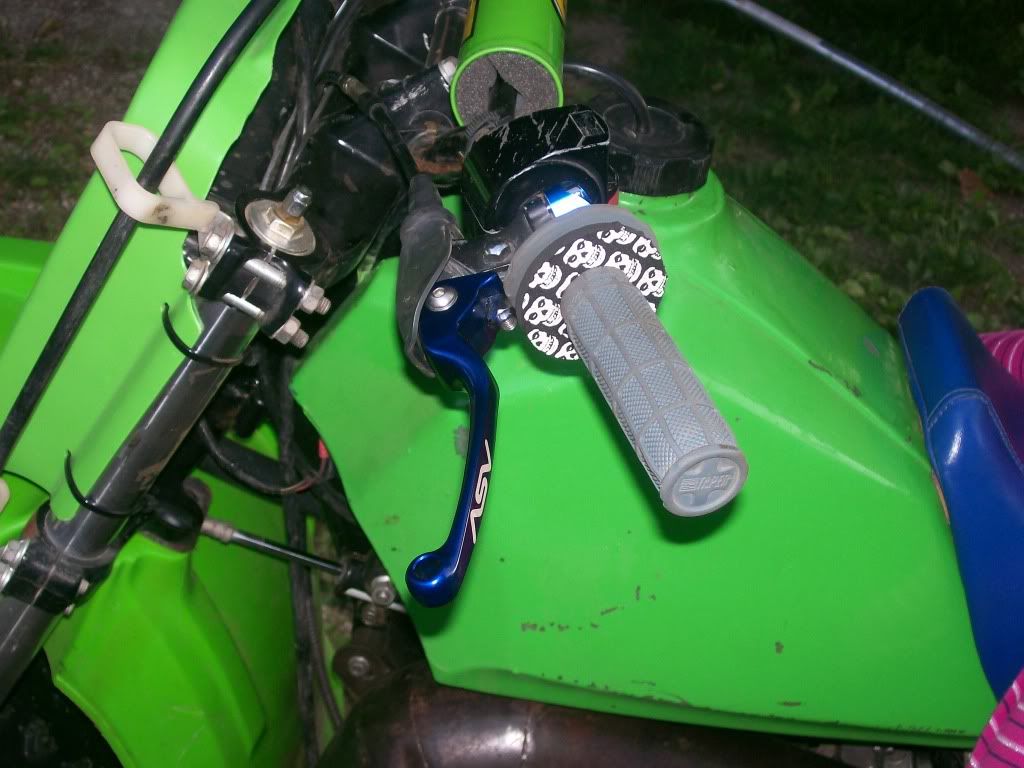

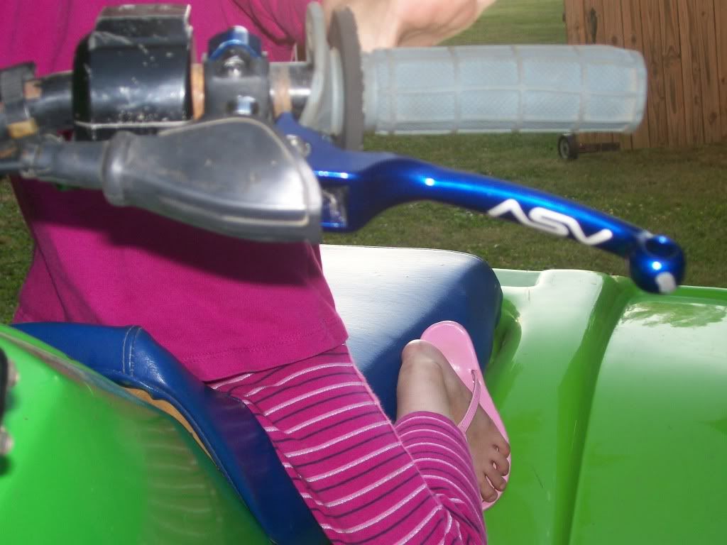

    I looked and didn't see anything for a 350x. They do sell an asv set for the 87-89 Fourtrax 250r/250/300/400EX. I don't know if the master cylinders are the same between the 350x and the trx250r. You may have to do some research on that. I bought a blem ASV lever on Ebay for $20 and made it fit on my '84 Tecate. For the '85 Tecate I bought the ASV kit for the Banshee and bought a used polished Master cylinder off Ebay to make that work for the front brake. The Tecate clutch cable works in the Banshee clutch perch/lever.
    The asv levers just feel good to the fingers, and they move out of the way in case of a roll over.
