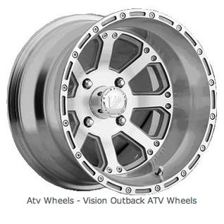

    Hey 3wheeler nuts, I think i got this figured out but wanted to ask first before i gave my hard earned money to Adapter Kings. I changed the rear hubs on my 83 ATC200 to 200x rear hubs for the 4/110 bolt pattern and went with the 12x8 Vision Outback rear wheels (2+6 sticks out nicely) with the Kenda Speed racer 25x10/12 street tires. I was thinking about doing a 200x front end on my trike but this trike is going to be just a run around have fun type of toy. I want to change the stock front wheel to a 12" rim as well to be able to match the tires and put more of a skinny tire on the front.
    Ok here is the break down if i am doing the math right. My stock front wheel is a 9x9 with a centered offset ( I think ), looks like that anyways so all 3 rims and tires to be put in any of the tire locations on the trike. If i went with a the 12x7 Vision outback rim in a 4+3 offset, and then had Adapter Kings build me a 4x150 to 4x110 adapter at 1inch thick. That should center the new 12x7 inch rim correct on my hub. Thanks again for taking the time to read this and any help or advice would be awesome. Thanks 3WW!!!
