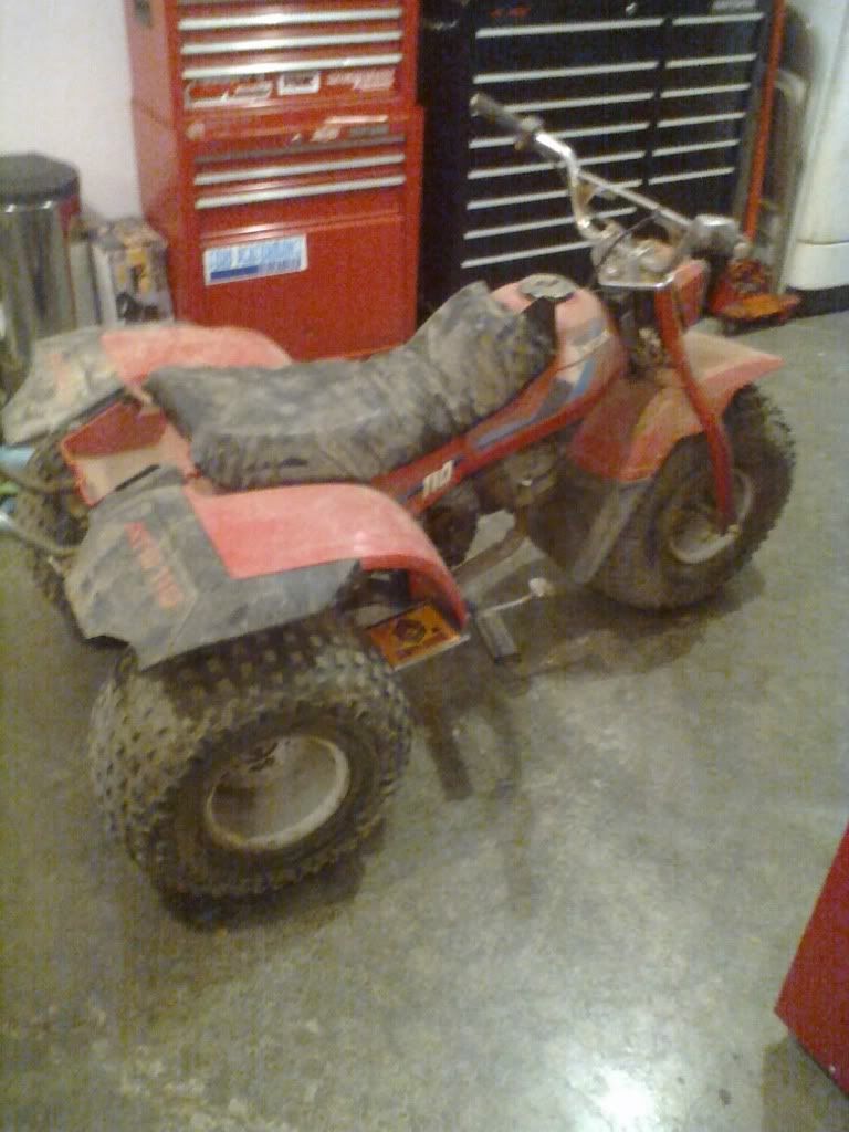

    I've decided that a few ATC90/110's would be good toys for the backyard. Upon telling a friend this, he said, "Hey, I've got one that you can have for free. Just needs a clutch."
    So I picked it up. It's a 1984 and is fairly complete, except it looks like someone took the clutch apart back in 1995 and left it like that. I got it, and the bucket of parts home, and upon reviewing what I have, it looks like I need quite a few pesky things:
    - Recoil starter (is gone)
    - Air boot from carb to airbox gone
    - No dipstick
    The rest is all inside the clutch area. I'm missing:
    - One clutch spring
    - All four bolts and washers that go to the springs
    - Gear selector arm up in the top left corner that keeps you held in gear (have the spring though)
    - Need 3 new friction plates obviously
    - All of the clutch actuator parts that go on after your clutch pack is installed, but I have the arm that mounts to the shifter shaft.
    So this is it, doesn't sound horrible, but......I also know nothing about this motor. I removed the plug and put my finger over the hole while turning the clutch pack by hand. It didn't feel like it had ANY compression. So I don't know if it wasn't turning fast enough, or if the cylinder/piston is shot as well?
    What do you guys think? I have never messed with any ATC110's and never even saw one in the flesh until I picked this up. I've just been going over parts and looking at online diaghrams and figured out what I'm missing. Is this thing worth saving, or is it a lost cause?

    It doesnt matter how fast you spin the motor it should still have some compression even with your finger. It sounds like you should check the top end just to make sure everything is ok and check the piston and jug those are the main issues for compression. These bikes are always worth saving if you know how to do the work and these motors are very simple and friendly to work on. Esepcialy clutches. Get some pics up of the motor.

    I am inclined to get this thing running.
    One thing that is puzzling me about the clutch is the spring arrangment on the first steel plate. I've only got 6 springs, 4 long and 2 stubby. I can't figure out how it should all fit with the fibers and other steel plates.
