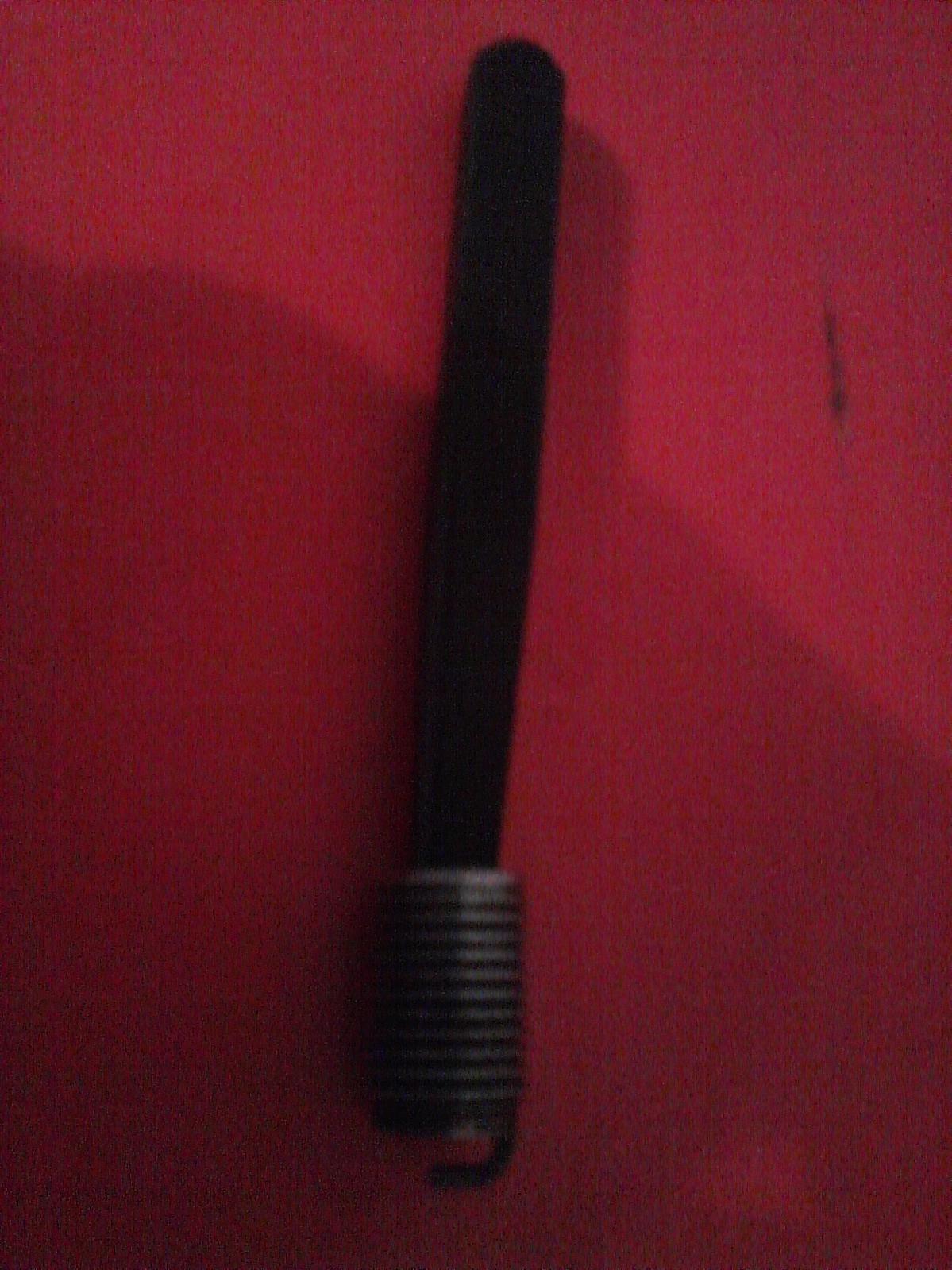

    Thanks guys for all the input I just bought the squared easy out 5 piece set from the auto shop and will have to try that. I also sprayed WD-40 inside to help relax it a bit. As for the pictures here is the broken plug, what I plan to use, and the broken plug inside the head....
    Attachment 138211
    Attachment 138212
    Attachment 138213
    Attachment 138214
    Attachment 138215

    I want to personally thank all of you who took their time and stated their opinion to help me out. I got it out after using a #4 square edge easy out bolt extractor. This is the aftermath of the surgery....
    This little rascal caused so much trouble....
