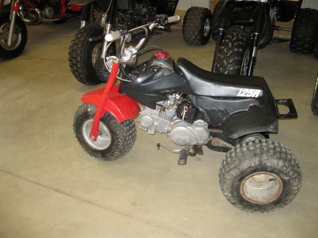

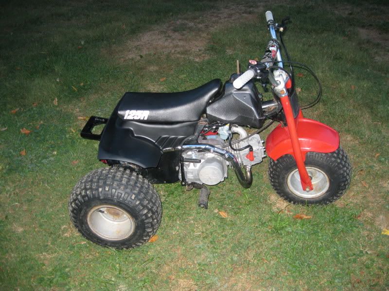

    First off, I'm gonna start building another 70 for riding with my kids.. I really want to use a 125cc pit motor, and I'd like to keep the kicker on it. Who has a 70 with a kicker and how are you set up? Bobbed fenders? removable seat? let me know! thanks guys. can't wait to get this thing going!

    We cut the fenders back, remove the heel guards off the pegs, and build wheel hub spacers about 2 inches each side.

    back in the day and before there were 450 4 wheelers guys were putting motorcycle engines in there quads. they would make a flip up seat. the front of the seat/fenders would flip up and out of the way to start them.

    both are good options. I'm thinking of bobbing the fenders though, quick and easy.
