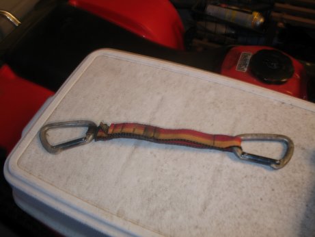

    IMO, BR are the caddy of 3wheelers.
    not sure if you have the clearance to use something like this, but this is what i use since i have no hitch yet. i just wrap it around my carrier and hook the chain to it.
    2 150lbs carabiners and strap (forgotten the actual name for the strap).

    yeah i heard those Big reds are the power horse of the three wheelers , but that setup you got there looks like it would work pretty well , but do you know if it would work with hooking it on the grab bar since its so high because my 200x doesn't have a trailer hitch , which is part of the reason i want a big red

    I think Jon Boy has that set up so he doesn't have to hook to his grab bar. You want to hook as low to the ground as possible so you dont wheelie up. Just run you chain or rope around your axle carrier.

    okay thank you ill try that when i go back out this weekend to work on the trail

    yeah swampthang is correct. only reason i use the strap also is so i don't mar or mangle my carrier.
