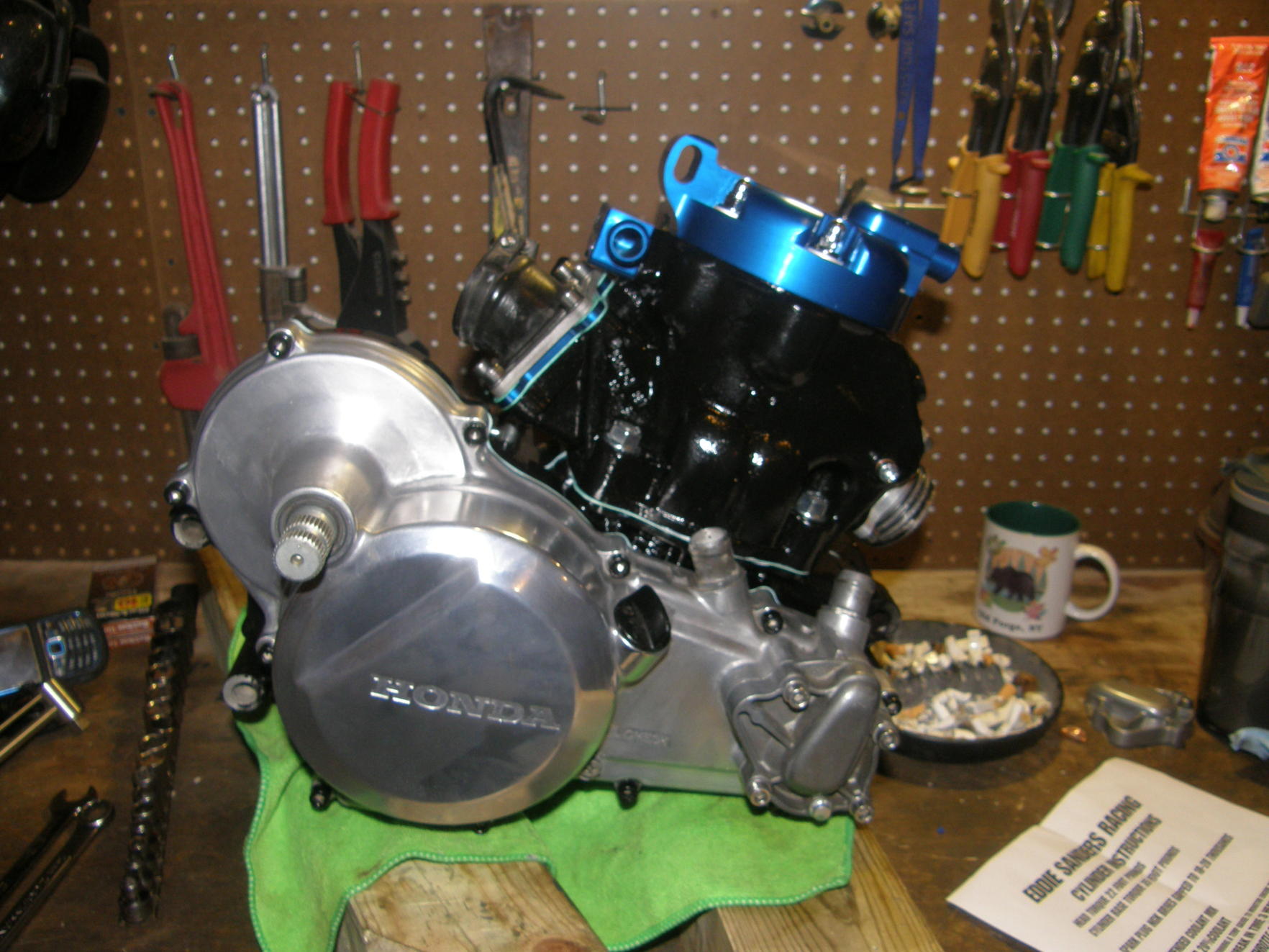

    Hello new members! At the request of my brother in law who is a new member here, I'm going to post some pics here of my ESR 350r build. Not fishing for compliments, just thought I'd give our new members a chance to comment. All comments welcome, positive or otherwise. Also, feel free to ask any questions you have.
    Hope you like... Joe
    First 2 pics are of my R the way it used to be... Stock cylinder bored .060, ESR 38mm Airstryker carb, 1Dir Racing reedblock and torque spacer, high comp head gasket, FMF Fatty with silencer, Hinson basket and pressure plate, ESR billet counterbalancer carrier and all bearings and seals in bottom end/transmission replaced. Chassis wise, nothing real spectacular, Durablue +4 axle, LSR double bearing carrier, all Maier OEM style plastic.
    Second 2 pics shows the chassis waiting to be cleaned up while I put the 350 together..
    Last pic shows my goodies...

    Just pics of the assembly stages. I decided to go with the semi-'85 engine color scheme. Painted the cylinder and crankcases by hand myself.. 4 coats on the cyl, 3 on the cases...

    Oddly enough, in all the excitement, I forgot to take a pic when it was all back together and ready to fire up!

    And it starts!
    So, in the end, it now has an ESR 350 BB kit with custom TRX9 porting, ESR ATC5 pipe with silencer, ESR reedblock, newly rebuilt crank with old-school Wiseco rod. I stayed with the short rod setup as there is DEFINITELY a spark plug cap clearance issue due to the ESR head having the sparkplug hole straight up as opposed to angled slightly like the stock head. Running the cylinder spacer plate required with the long-rod topend would only worsen that little problem...
    Here is a vid of the first start-up. Lemme tell ya, sounds completely different and ALOT meaner!!!
    http://www.youtube.com/watch?v=30siE...Q-fzSN5y26wTKo
    SO, what do you all think??
