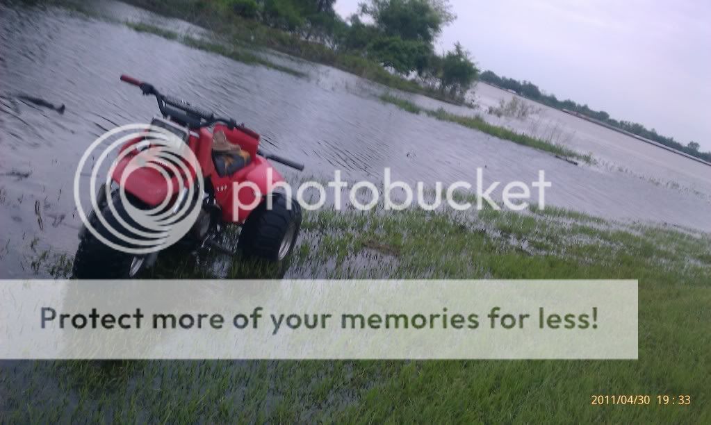

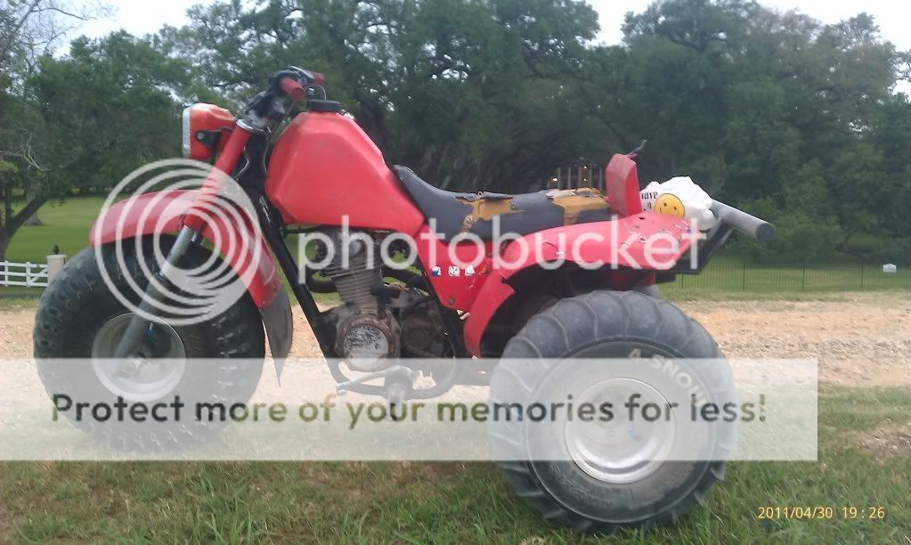

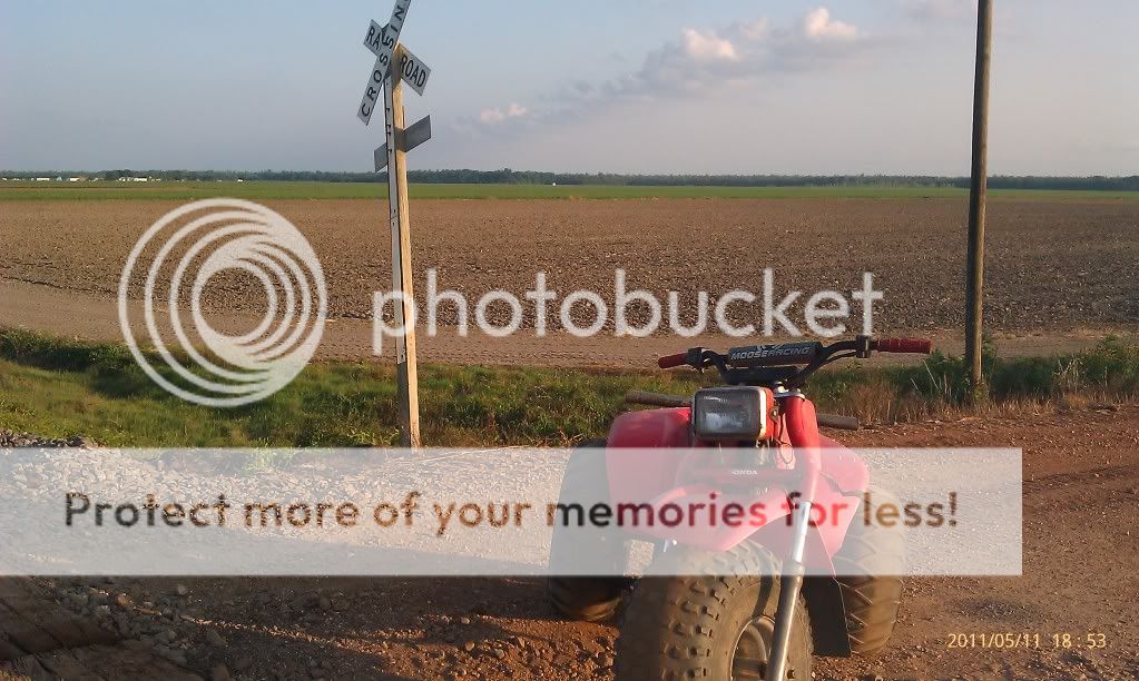

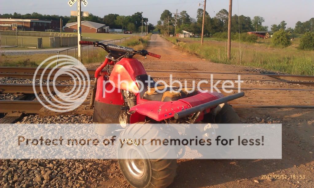

    These are my mods all stock with jets,exaust new head, and as for a more sporty look I got aluminum rims all around with lightweight tires and I had a custom made grab bar but I got a stock one also I got. A tool box from Craiglist
    85 200s (my all around bike)
    86 350x
    85 250sx (trail ride mud ride)
    85 200x
    84 200s ( restore)
