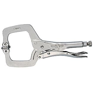

    Quote Originally Posted by Thorpe View Post
    Tanks dent, big knee dent? Easy fix... Long reach padded vise grips, (Irwin # 24SP) Empty tank, bolted to the frame of the trike, tape the swivel pads with a few layers of masking tape, (to prevent scratches) reach the clamp down through the filler neck, clamp on the dent, (centered) one pad inside the tank, other one outside, and pull on the outside of the vise grips... Pop out the dent. 10 minutes later, its good as new...
    yes, a big knee dent. if i cant get padded vise grips, can i used somethin else?
    That dent would pop real nice with the vise grip trick....
    these are the only vise grips i got available at the moment. but i think theyre too short. not sure if the loooong ones will fit in there due to the hump where the frame backbone is...
