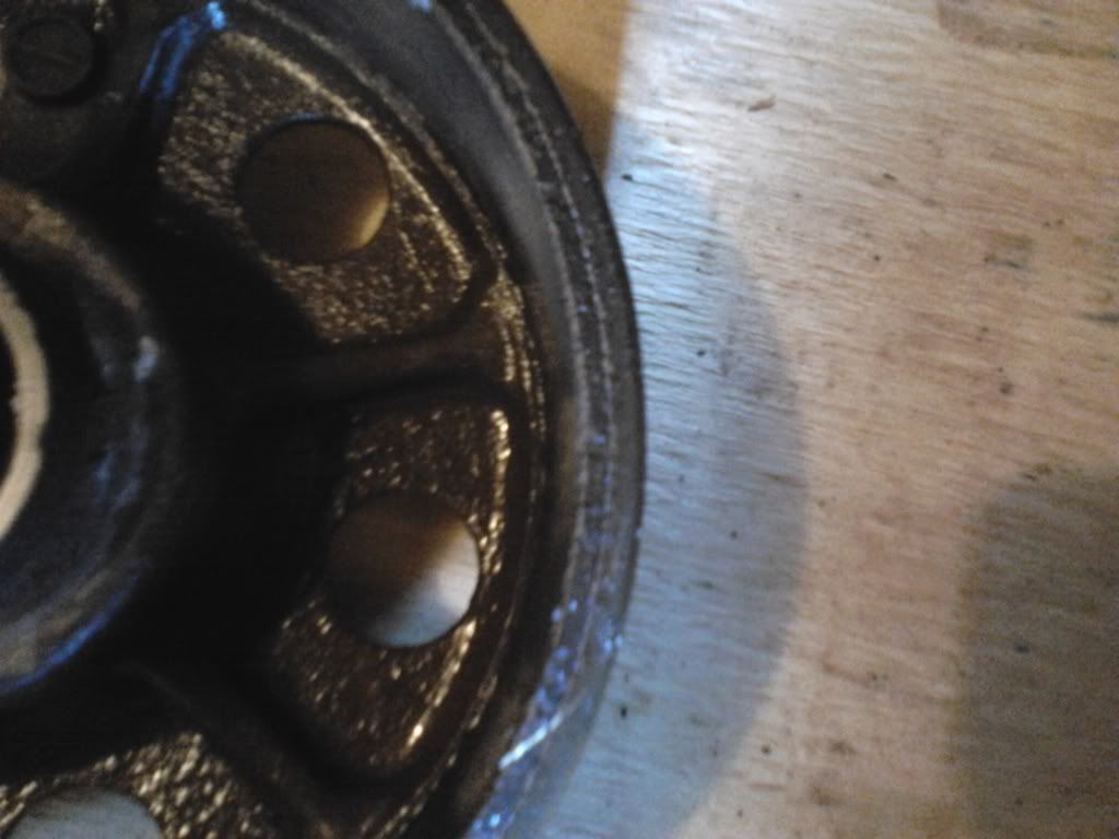

So I was finishing a rear brake shoe and cable swap. The cable swape went quick and easy. Took maybe 3 minutes tops. Tore down the rear brakes and put new shoes in after cleaning up everything the best I could and greasing the pivot point and cam. Went to put the drum and it won't go. So I tried squeezing the shoes down and shoving the drum on. No dice. Came inside to see what's up and find out there's a ring on the drum that has to come off so it can slide over the shoes. I didn't know this because my ring is so rusted that it looks like it's part of the drum. I absolutely cannot get this ring out. I've torched it. Soaked it in several penetrants. Pounded on it with a bigand screwdriver. The ONLY progress I have made is that I did find the edge with a razor blade and scored it most of the way around.
So my question is this. Does a brake drum from an 82 185s fit an 84 125m? I have a complete rear axle assembly I was saving to make a trailer with. I don't want to pull it apart if I can't use the drum though.
Also, I've read that alot of people don't install the ring again as it's a major PIA. Is it ok to run it with out the retainer ring? Will the shoes stay put or will the move to much?
