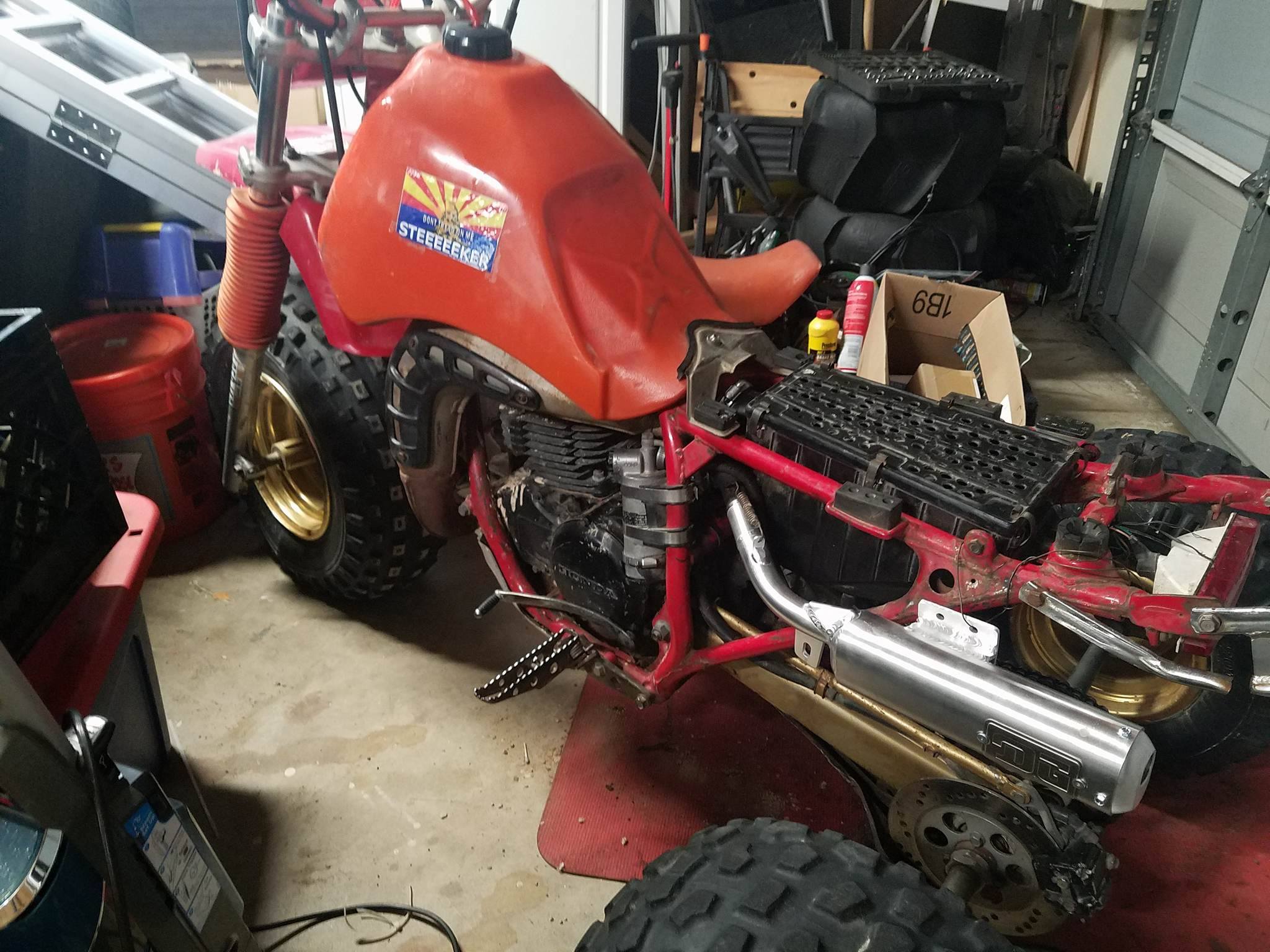

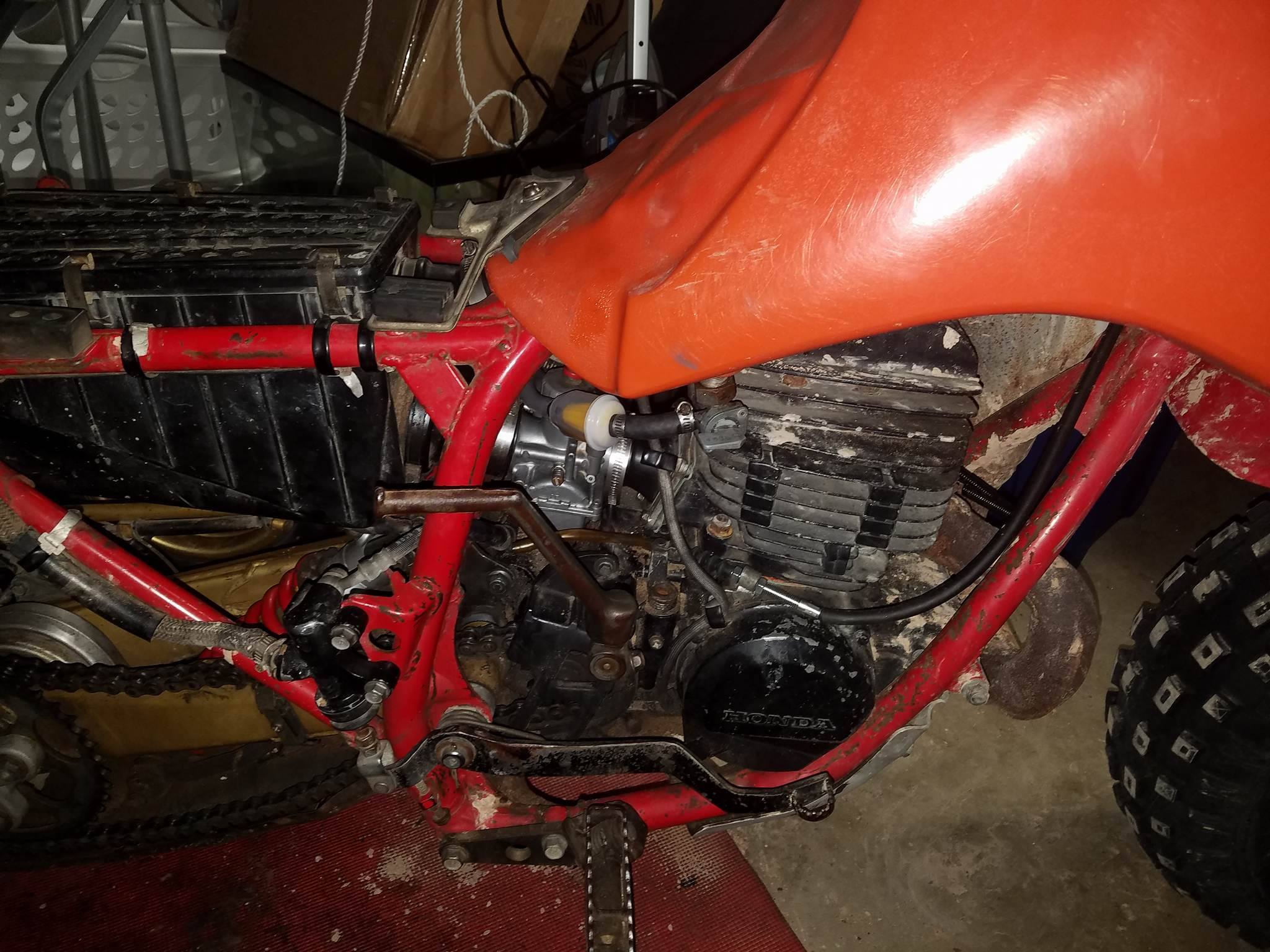

    Brushed off a good amount of mud around the shifter and couldn't see and visible depictions of the number of gears. My phones charging currently then I can take some pictures?

    I don't think the shift pattern is on the cases but I could be wrong. The 82 cr480 was 4 speed, 83 was 5. Take a picture and post it up
ID:	239117Click image for larger version.
ID:	239118Click image for larger version.
