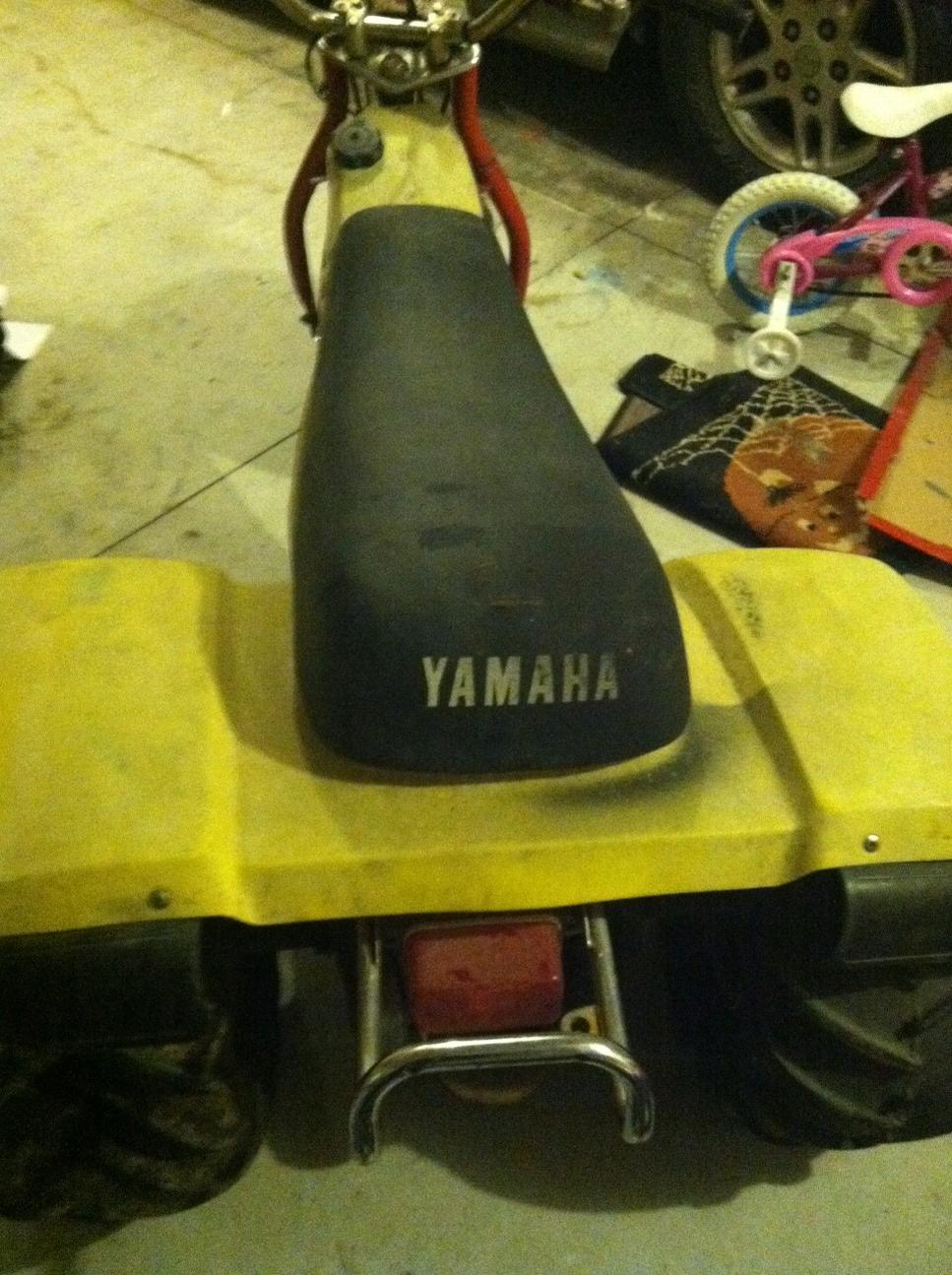

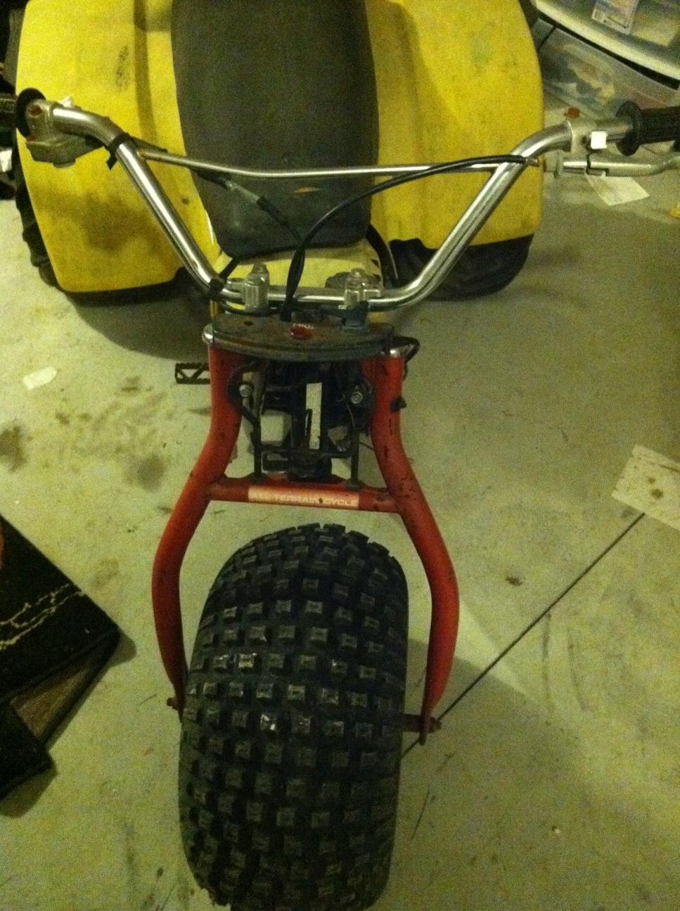

    Just dropping in a line and sying hi to everyone. My brother got ahold of a Yamaha YT125 for me which I believe is a 1985. It is in need of a rebuild and missing parts so I will be on here seeking as much help as needed. I found a condensed sevice manual and a wiring diagram so far. So far I need a breather box assembly all the way down to the carb (any aftermarket solutions?), Front fender, head light and all the mounting stuff including the plastic, bearings for the front steering, and a cap for the oil tank... I might just premix though. It does not run so I need to see if I can get it to start with some cleaning. the wiring needs to be troubleshot as there are loose wires all over. I also found a clear tube just hanging out by the Carburator and I have no clue what It's for yet. I got it lastnight and had to go to work. Does this thing use a battery? pics soon.
    I think I will bring my carburator to work and clean it tonight. I am hoping to atleast get it running without having to open up the engine. Anyone got an E-owners manual for this thing?
    Omaha, Ne
    42
    Bad luck so far. Took the reed valve assy out and itt was full of dirt and grass. Hope it was from sitting. But I looked at the piston from the hole and low and behold... The piston has several scrates and they look pretty bad. The carburetor was already cleaned once and they did a poor job. Several ports were gunked up. All the hard work was done though. Looks like it has been sitting for a while be because the inside was rusting. There is still oil in the crank case and I am trying to figure out what all the hoses are on the bike. I found 4 loose hoses so far and I know one of them should probably go to that tank in the back left but I don't know what it is for? Is it a reserve tank? Really wish I had an owners manual. There is a large clear hose running from the back right wheel area to the gas tank area on the left side... Not hooked up. I also found a short hose under the carb when I took it off. No clue what all needs to hook up so I will just premix my gas and see what I need to do to try to get this thing running.
