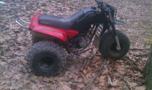

    Here are the pics:
ID:	140791Click image for larger version.
    glendive, montana
    1,822
    a little rough but it looks to almost complete great score, and if you feel that you want back mudflaps, let me know I have two sets laying around.
