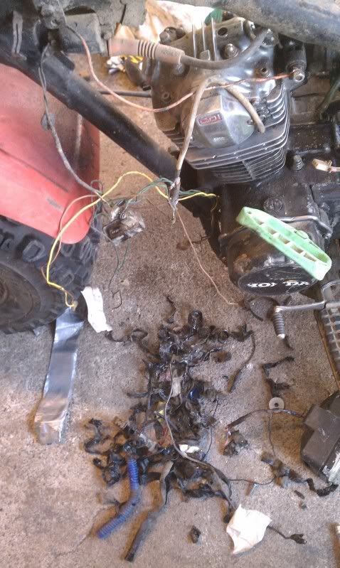

    So While I am waiting for all the parts I ordered to get here so i can ride this thing and cause all sorts of hate and discontent around my neighborhood I decided to take a look at the wire harness....or what was left of it!
    You would think that with what, only 6 wires on the whole bike that they wouldn't need a whole roll of electrical tape.

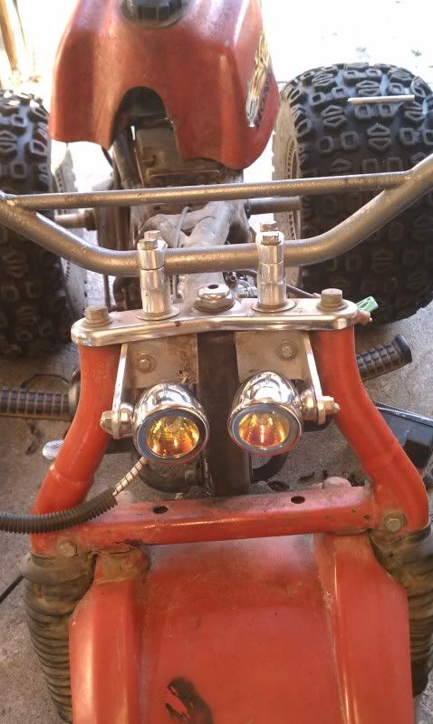

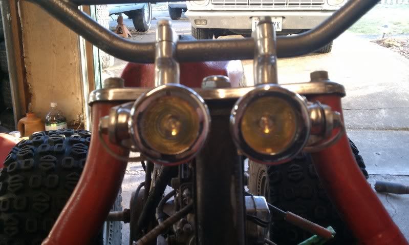

    The headlight worked but was on its way out. I have these accessory lights sitting in the top of my tool box for a few years now so I will give them a shot. The spiffy brackets that held on the other light will get straitened so the lights are aimed. Just one of these lights hooked up to a 12v battery will blind you and light up the whole neighborhood hooked up to a 6v they are still super bright so we will see what happens.

    My biggest pet peeve on bikes now: WHY THE HELL DO PEOPLE FEEL THE NEED TO CUT, HACK, TWIST, AND TAPE the SH!T out of a wiring harness?!?!

    the 83 185s had susp forks , if you still need wire harness and muffler pm me , I have lots of parts for 185/200 most interchange but not all .those lights might fry your stator! the 185 doesn't put out much juice.
