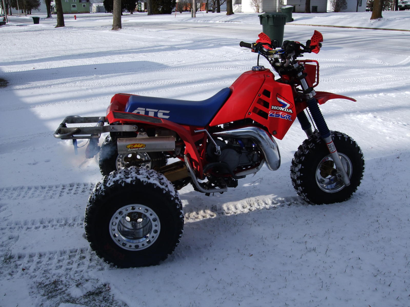

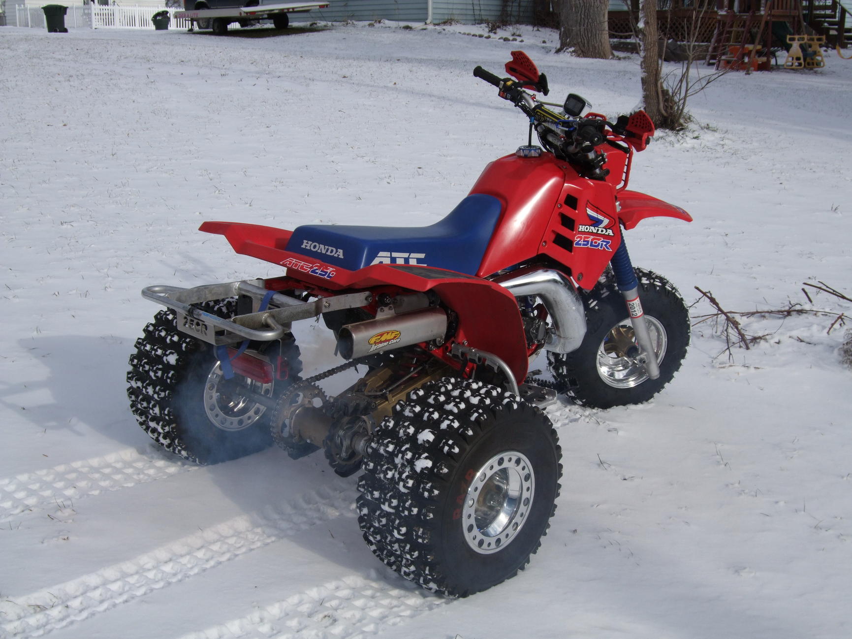

    Welcome I see you are form Wisconsin.Where you live? As far as rear tires 9" are oem. I got maxxis 20x11x9 Razrs and there great. I have some 8"rims with 20 inch itp black waters and there worse then bald stock tires. I'd stick with the 9" and for the front theres members on here that have 10" front rims to convert your front tire so you can use all the popular 4 wheeler front tires I have a ITP quad cross 21x7x11 and it works great

    Thanks a bunch guys, I really appreciate the input as a "newbie"!
    I'll pass on the 8" wheels and keep an eye out for a good deal on replacement 9" wheels.

    Thanks for the welcome! I live in Hartford, about an hour or so South of you in Ripon.
    Thanks for posting pictures of your ATC! I love the look of your tire/wheel setup....actually I like the look of your whole ATC....it looks great!! I do also appreciate the suggestion of picking up a front rim that will utilize a more common quad front tire as that makes alot of sense to me.
