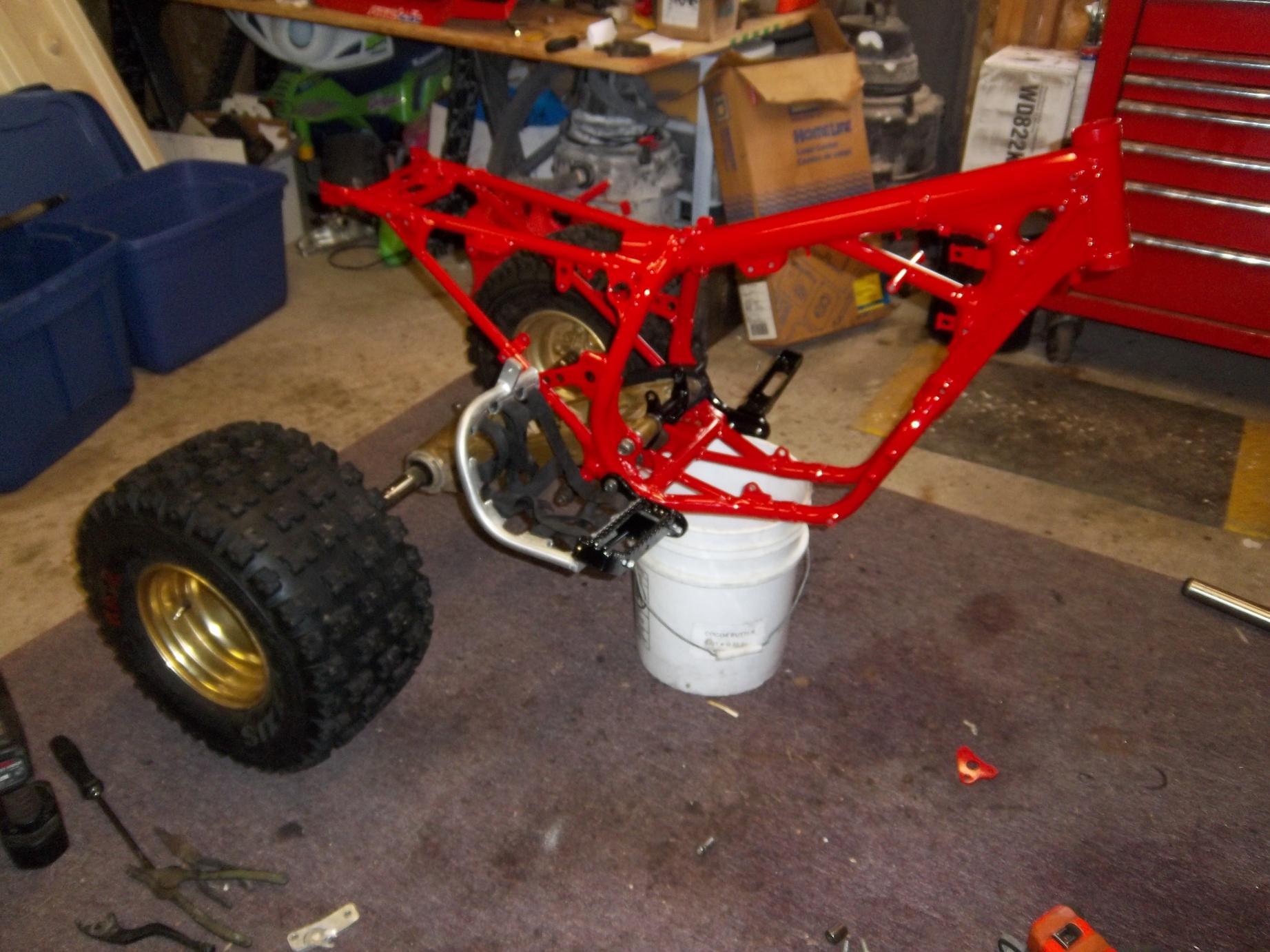

    I got some adaptors from Jason Hall off this board so I could use the stocktrx450r style. I put on some rath racing net heel guards on. I like the feel.

    Pantera, that is exactly the setup I have been after! I don't like the huge nerfs a lot of the Moto guys are running. Those heel guards are minimal but get the job done. Where did you get them and what did it take to mount them up?

    Havent been on here much sorry. The heel guards are from http://store.rathracing.com/index.cf...ategory_ID=468. I bought them from a local shop that uses them on their race quads. I cut off the upper mounting tabs and the fender braces. I can envision it done and gonna make some steel mounts that will bolt onto the master cylinder mount and chain guard mount. I shouldnt have to drill any holes. The adaptor are form Jason Hall thats on this board. P.M.him. there stock 08 trx 450 R steps which got on ebay. I ended up buying 2 pairs because the people that weld them do sloppy work. the kick up was a 1/2 differnt from one side to another! then the kick ups I bought used for $10 there stainless ones. They really look trick on there. and with the net design they wont fill up with mud. I think the guards were $110, adaptors were $40, pegs were $12 pair shipped and the kick ups were $10.Rath is slow on shipping Rath said they sell them in components so you dont have to get the whole nerf set up.
