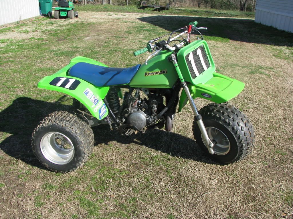

    I added a tecate to the stable yesterday.

    Looks good. Does it run?

    Nice tecate man!
    OK
    5,450
    Very nice. Looks like an old race bike. Love the Maier Ram Air plate. Klemm Research stickers.. hmm.. Got any closer pics of the motor, pipe and silencer? Looks like a flat slide Mikuni on it.. Just a shot in the dark.. could that bike be connected to Jackie Meadows? I think he ran the #11, and he's from Tennessee.

    It runs but it is surging a little coming back down to idle. I'm going to do a leak test on it and see if there's any leaks. It pulls hard on topend but nothing down low. It has a 38 mikuni. The pipe is just a Doesn't Go (aka DG) pipe and silencer. I think this bike had alot of history. It would be cool if it is a old Jackie Meadows bike.

    Finished the compression test and leak test. It has 150psi but it has a leak in between the cases. I tried tightening the bolts but it still leaked. Got to split the cases and seal it up.

    I was tearing it down today and found out that it has a motoplat ignition. I need to pull the flywheel and was wondering what puller I need to do it. The threads are coarser than my 250r puller. Any one have any idea what thread it is?

    Man!!! Score!!! Pull the headpipe off and see if the exhaust port is split. It may have a KX cylinder too...

    It doesn't have a bridge but it has been ported.

    I think you picked up a gem... There is a gasket on the flywheel side. No RTV.. lol

    Very cool find! Very good looking machine. Are motoplate ignitions sought after too?
