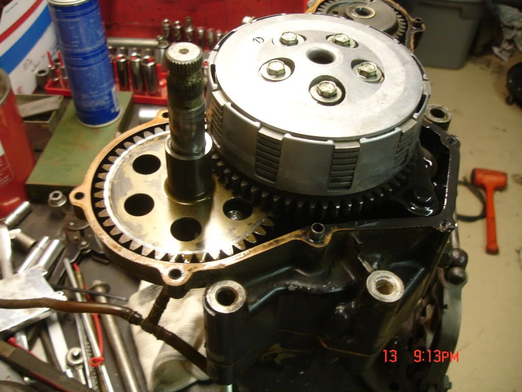

    ok well i just stepped out in the garage .. i happen to have a 250r motor on the bench,,, since i just did a clutch lastnight in another 250r,, i figured i would help you out,,, the 85 has a very thin spacer in them between the case and the kicker gear,,, it wore away pretty fast,,, or wasn't very close on tolerance,,, every 85 i open up i update th spacer to an 86,,, it seems to solve all the kicker issues!!! here is a pict of the spacer (an 86) and yep you have to pull the clutch to get to the kicker assembly!!!
    thanks...
    do I need any special tools to pull the clutch off ?
    so the spacer on the 1985 wears out quickly..meaning that it it gets to short..and needs to be replaced with a longer one ? If so, how long should the spacer be ?

    so most of the time, the spacer is to worn down { in length} and thats why this problem exists ?

    I AM GOING TO SAY NO.... 2 of the 85's i tore down needed more than that spacer,, but several with a ocational skipping problem were cured by replacing the spacer.....
