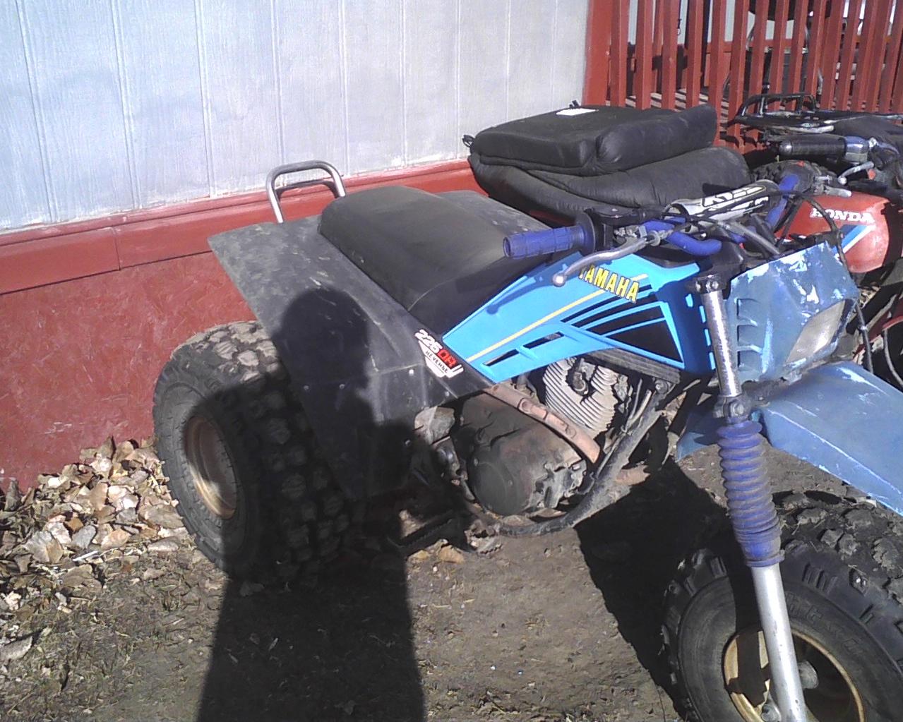

    I have done it it is not a direct fit, unless you have money for a machinist, or are one with access to a mill, and can grind the steering stem out from the original honda to be put in the yamaha triples it will not work. I did it because for me it was cheaper to do the interchange than to buy a new front hub for an 81 atc 200. If you want more details and pictures of the swap let me know, and I can show you what was needed to be done
    glendive, montana
    1,822
    this is what ytm 200 k forks look like on an 81 honda 200
    I also have a custom mounted ytm 225 tank on it but fork wise it was an improvement to the non suspended oem honda forks. I don't know why it added the pictures of my dx but ok
