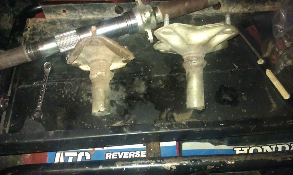

    Grind around their welds,,pound them,they'll pop right off.

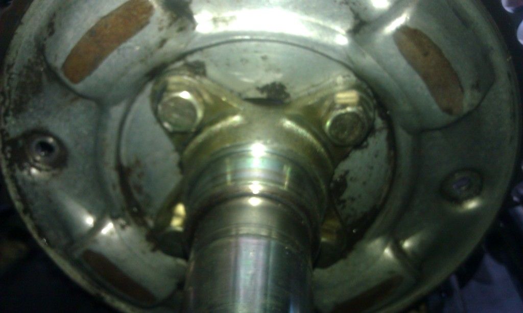

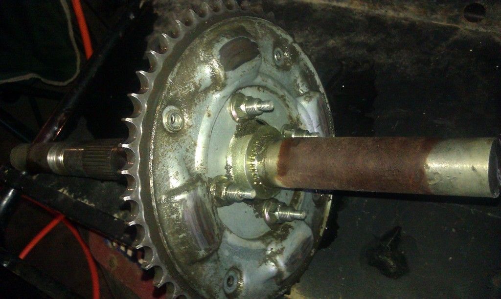

    I cant seem to break these sprocket nuts loose? am I missing something?
  3. #48
    Jan 2011
    Brazil, Indiana
    2,087
    Quote Originally Posted by tulsamike3434 View Post
    Heat it and beat it.

    lol thanks hoosierlogger! Ill give it a shot!
  5. #50
    Apr 2009
    Oklahoma
    1,234
    Quote Originally Posted by hoosierlogger View Post
    Man them were some -HOGS to get off there! But I got them!

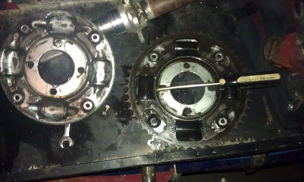

    My IP is blocked again! it took me forever to find a proxy server that let me post anyway.....

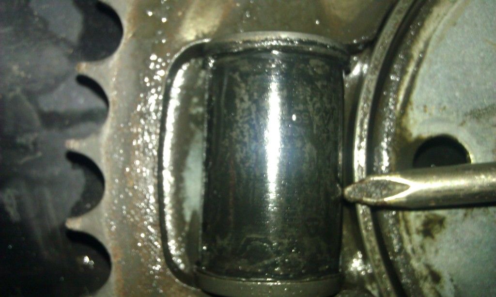

    What are the reason for these RUBBER, DAMPER peaces? Are they weights? What my screwdriver is pointing at.

    Instead of asking about what they do, take a minute and figure it out. Didn't you say you wanted to learn while do this. Put your thinking cap on and think and learn. C'mon Mike.
    Well I did I went here...
    http://partsfinder.onlinemicrofiche....pe=13&A=5&B=25
    and got the name of the part bit I was just wanting to know what there function was.
    And I am learning a lot thanks to all of you! I hope that when I am done with this thread it will help someone else who needs it. I will try to be as in depth with it as I can they will see my mistakes and my fixes. This is almost as fun as riding!

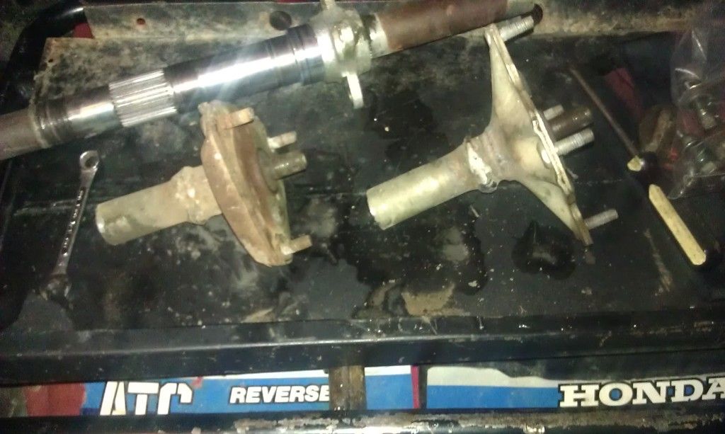

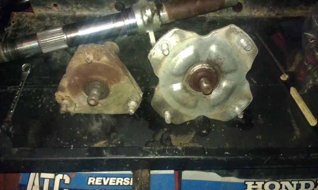

    That would have been point less. Who ever did this wanted to ride BADDDDDDDDD!!! The hubs were off 2 different trikes lol one was a 110 and the other was off a 185s I think my 185s has a 3 bolt pattern. WOW the things people do. lol

    I was gonna say hey just cut the things off if you had a spare, but....... looks like you already did that.

    the 185s hes 4 bolt hubs ,the 3 bolt is early 110 or later model 90 ,keep at it

    The rubber pieces are shock dampeners for when you start to move forward on the trike, they take up slack and cushion the starting or stopping of motion.

    Like "damper" springs in a clutch plate. But springs aren't dampers - kinda like restore vs refresh or engine vs motor
    Maybe cushions?
    The bolt patterns are year specific not model specific on the "sport trikes".
    3x100 = 74?? through 81 on 70, 90, 110, 185s, 250r, FL250
    4x130 = 82-? 110, 125, 185s, 200s, 250r (82), FL250
    4x110 = 200x, 250R (84+), 350x
    The original 185 and similar 200 200m etc got a 4x150 bolt pattern with 9 inch wheels.
    The funny part is seeing a 3 bolt on one side and a 4 bolt on the other welded on. Cutting them off is the best plan - they're usually welded on because the splines are stripped on axle and/or hubs.
