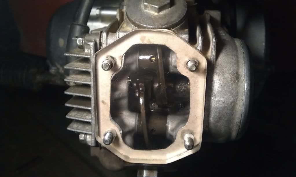

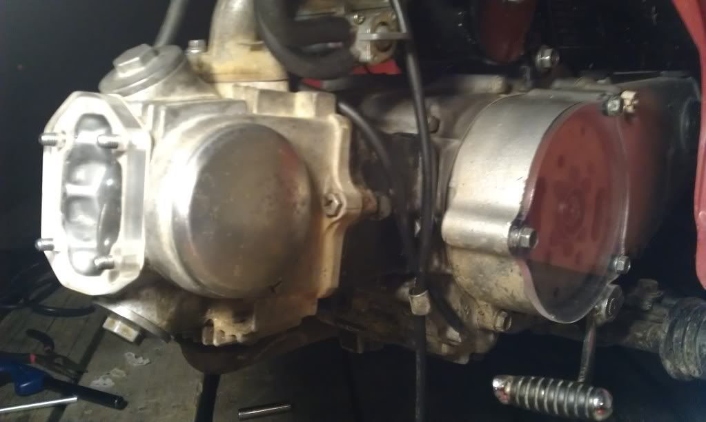

    Atc 70 Clear Cylinder Head Cover! (Lotsa pics! And a vid :])

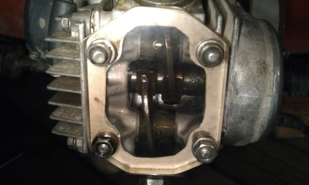

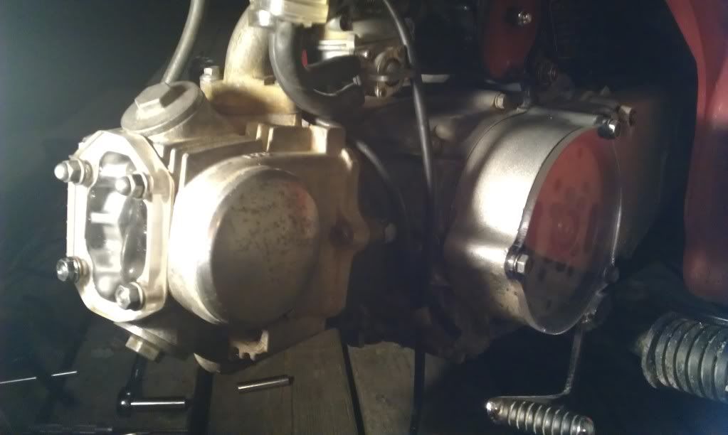

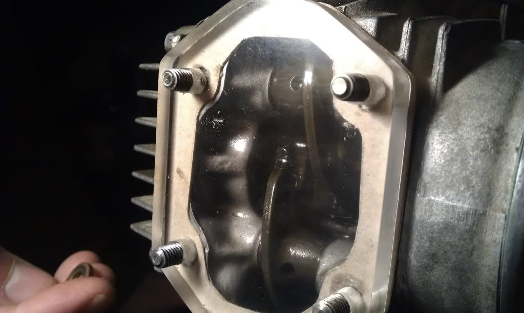

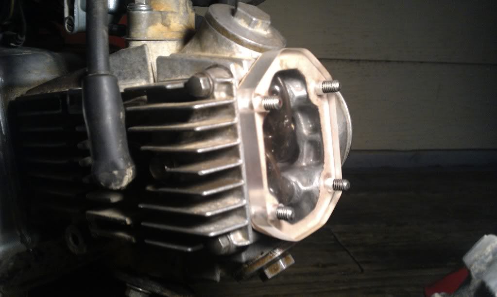

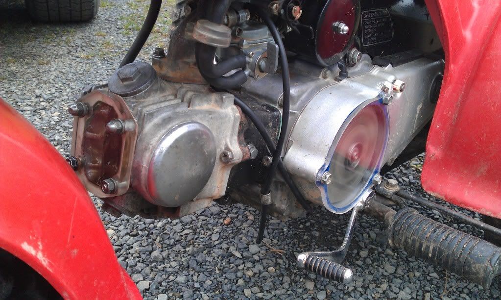

    Used a old piece of boat windshield.
    Heres how it turned out.

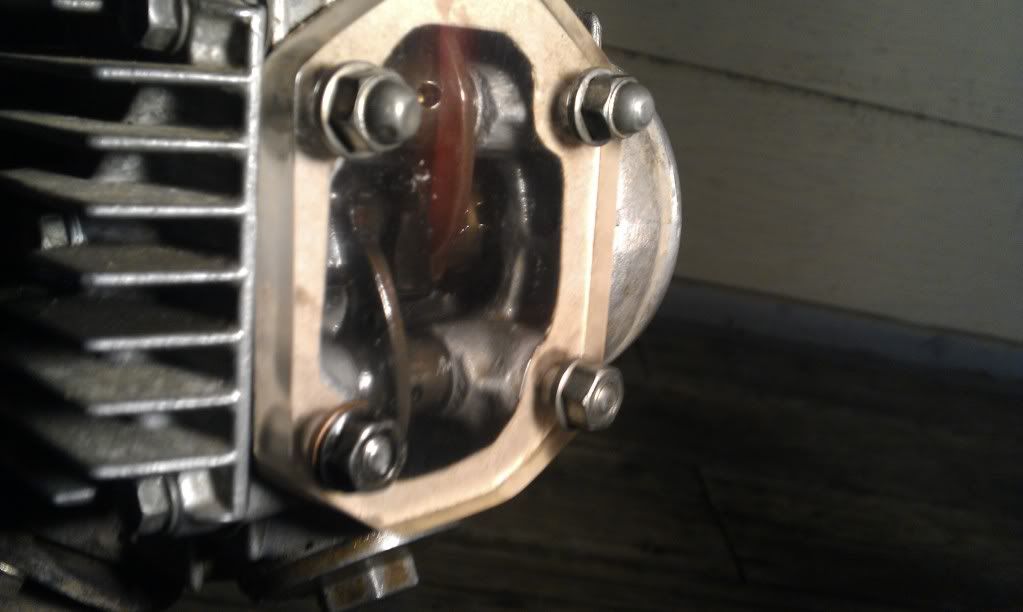

    Held up for a little while, then melted and the seal broke. Need some sort of stronger plastic and maybe some bushings for the nuts to tighten down on. R&D man.

    thats actually really cool. sad it didnt hold up. but i think youre onto something here

    Great idea. I love the clear flywheel cover too.

    I cracked the flywheel cover, need some stronger plastic. hmm I could pop a couple of these out if someone wanted one, the hours of labor would determine price though.
    Gonna try some different plastics if i get the chance, but they work awesome for a sand cruiser not so much on trails.
    As for the rocker cover I need something very heat resistant.
    However, both covers were just spur of the moment things and were from scrap materials.

    You don't want an acrylic material (i.e. Plexiglass) you want a polycarbonate (i.e. lexan is the trademark name for clear polycarbonate sheet). Look for a piece of Lexan, and I'll bet it will hold up.
