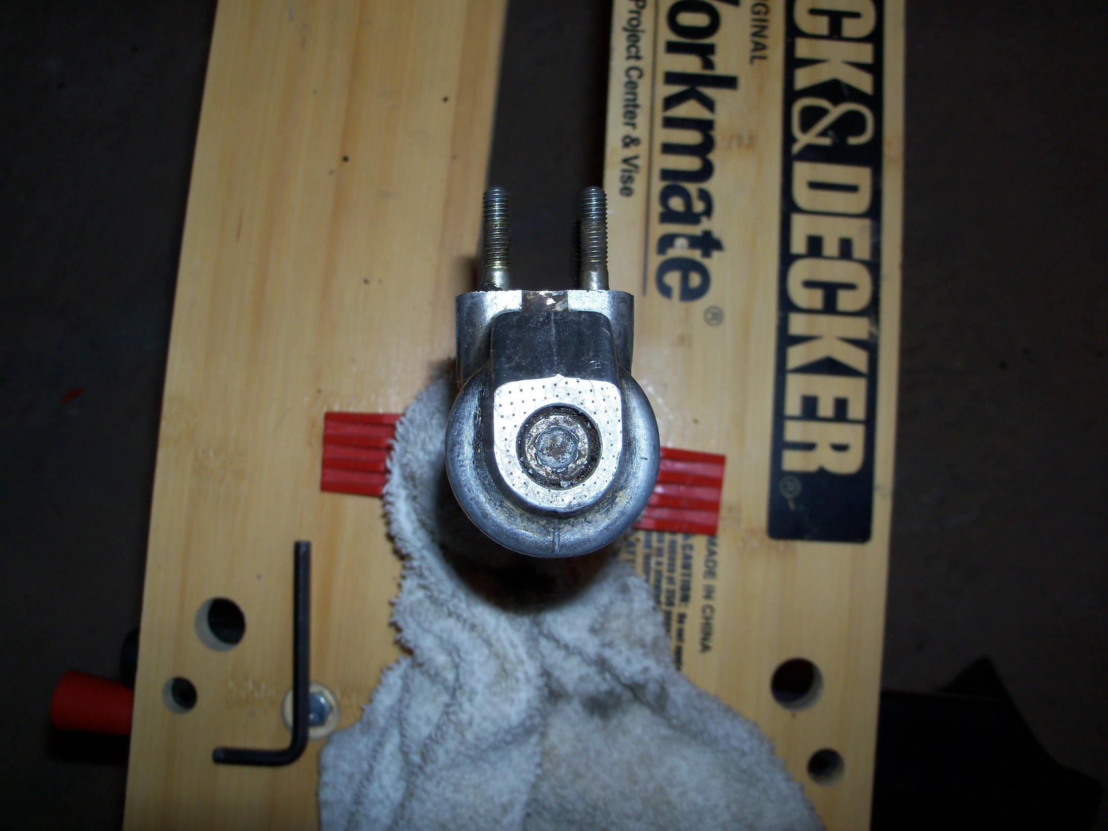

    Maybe heat it a bit? like the aluminum that it goes into.

    I have actually done that before. It worked for me, JB weld is great stuff. Best way to get those out is use a butane torch, heat the crap out of it and the will pop out pretty easily. Metal bolt in an aluminum housing....works every time.

    Ok! Now it's stripped! Heated it up but was just to far gone. I only need the fork tubes . Can't I just drill it out? Not like I trying to save the slider.

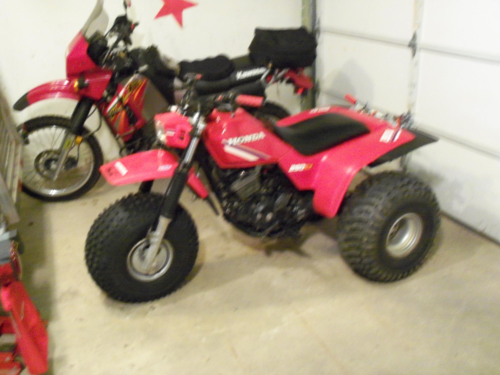

    Ok! A little update. All is good in the world!!! I bought a entire front end off ebay for $45 +$25 for shipping. Got it all together! I put a Cheng shin or (whatever the name of the company is) front tire on. The tire says 5psi manual says 2psi. Which one? Tried 2.4 psi but tire looks flat.

    Apr 2012
    Northern Utah
    I would just mess around with the pressures. More pressure=Better steering. Less Pressure=Cadillac ride
