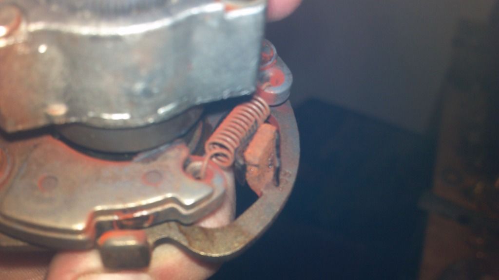

    Are these little "insulators" impotant? The black plastic thing between the spring and the post? Are replacements available? Have people come up with an "at home" sollution to this issue?

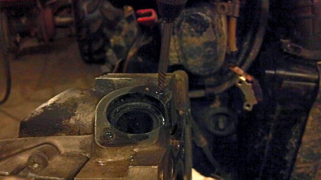

    So I came home from work and decided I didn't want to wait for Baxter's. I successfully drilled into one exhaust studs and was able to get a good bite first try with a couple taps with a . Didn't really want to budge. Hit it with some Liquid Wrench and it's soaking now. Successfully started drilling a new hole in the stud I messed up a few months ago trying to drill it out on my back on the garage floor. Drill ran out of juice. Battery on the charger now. I need propane for the torch as well.
    EDIT: I'm that MORON everyone loves to laugh at.
    Just broke my reverse tap clean off. Be honest. You saw it coming a mile away. Now it's just going to be easier to buy a different head I think.

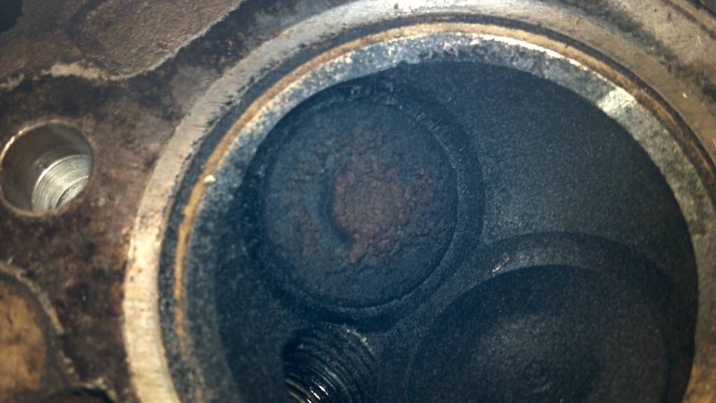

    So now I ask you this. What is up with this valve? There is insane build up. Is it just rust from years of sitting?

    Have a welder??? The way i get ones like that out is to get a nut thats just about the right size and sit it over the broken stud, or remover, then weld inside the nut. Works best with a MIG since the wire is small enough, but basically you build up the stud a small weld at a time, zap, cool, zap, cool, until you get up to the nut and then start to incorporate the nut into the weld. Let it all cool for a while, don't use water, just let it air cool. The added heat from the welding also helps break the stud free. Then just wrench it out if it held. I have done this many times, even with ones broken flush, before i got my broken stud remover set. Although i have broken a few like you and resorted to welding on the nut again!
