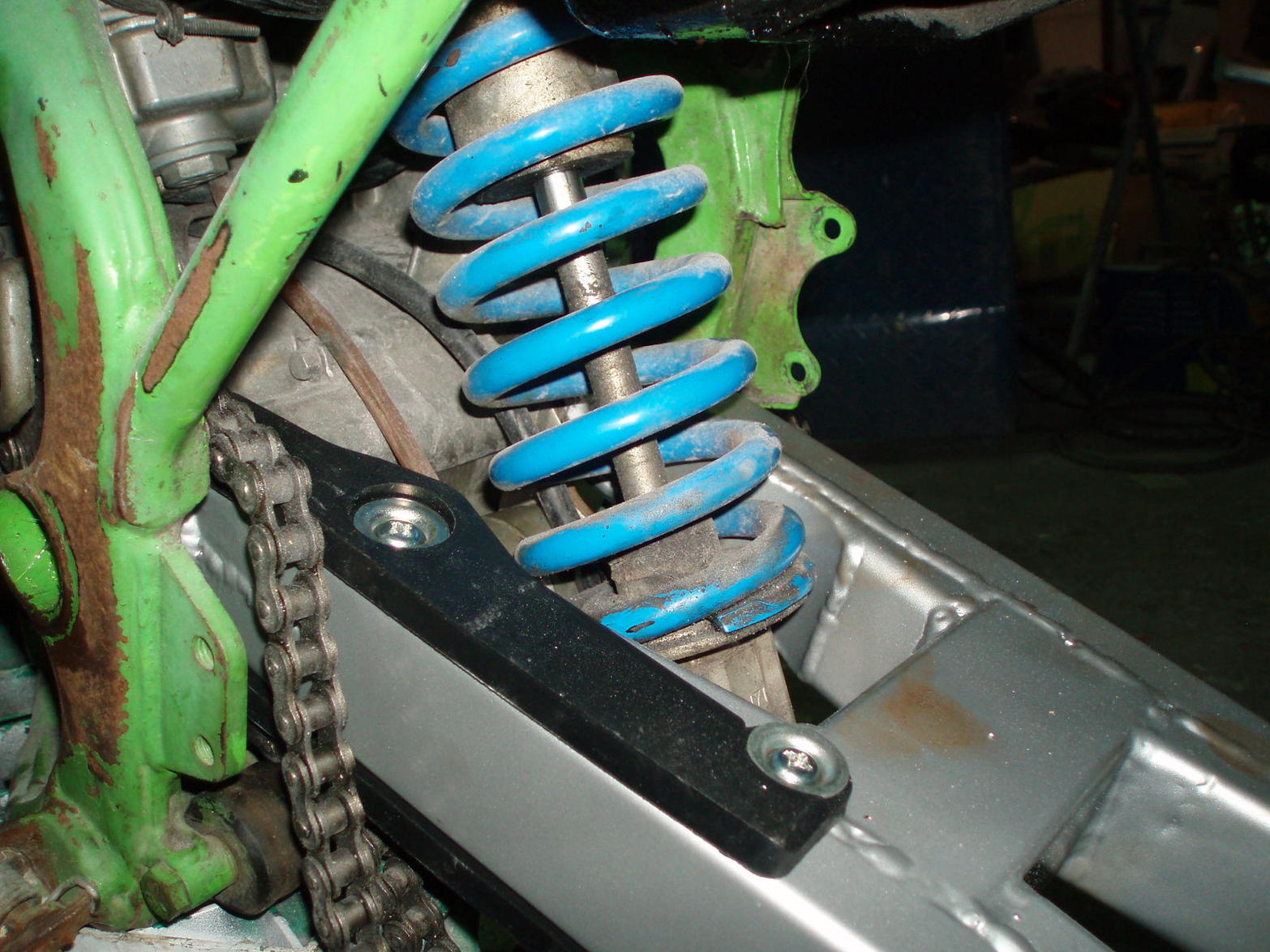

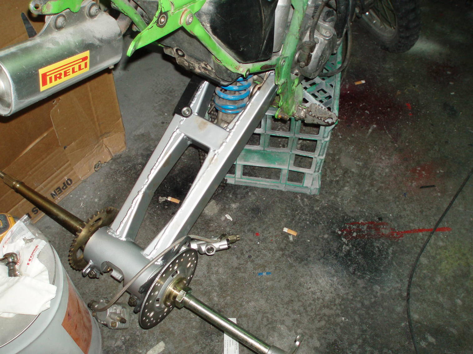

    ok time for a quick update.....finished the arm,epoxied it,painted it in original silver with satin 2 part clear,fitted original chain guide,new bearings and seals and shoved it back in the hole.....i will now be able to sit it back on the floor and make the triples and work out the ride rake i want

    heres a shot of it back on the floor with the rear wheels on
