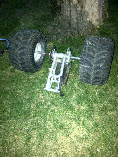

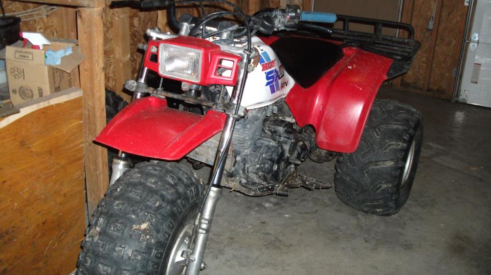

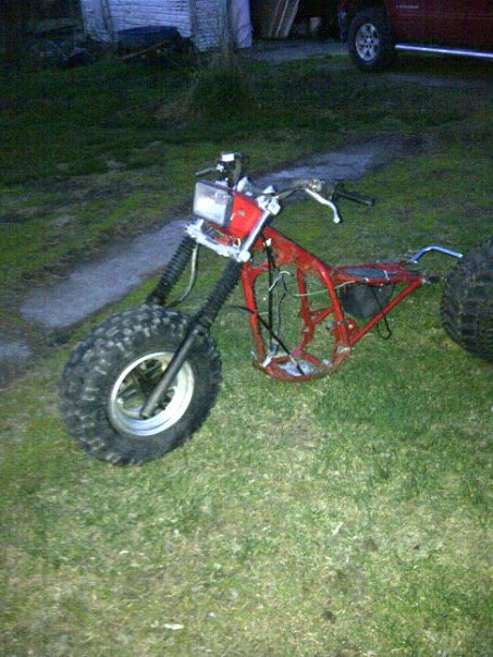

    Here are a couple pictures of the 200x I'm getting. I have 1 picture of my 250sx from when I bought it
ID:	146267Click image for larger version.
ID:	146268Click image for larger version.
    NC
    907
    Most people use the entire 200x front end, personally I just used the 200x forks, hub, wheel and brake caliper. I used a 24" tall AT489 tire for the front and like it so far. New spacers have to be made to center the hub on the axle and a spacer for the brake caliper also has to be made for that to work. Not sure about using the entire 200x front end, but if I understand it right it is a bolt on and go deal.
    NC
    907
    After reading a little, you may or may not have to replace the steering stem bearings and you do have to add a steering stop.
