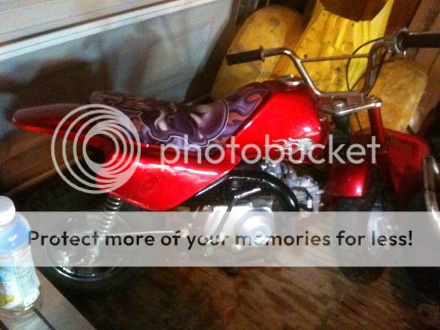

    I sold this pit bike 5 years ago and its sat since. When the guy tried starting it he messed with the carb screws. Now I got it back and cleaned the tank. Ive had the carb off at least 5 times and cleaned and disassembled every screw and microscopic jet. Last time I even boiled it all in lemon juice and water then blew out with the compressor. There is a new fuel filter and brand new fuel lines on it. I seen light through all the jets and ports so am finally ruling out a plug. I bought this new and only had a few hours on it. Ive had the screws almost everywhere and googled to death but cant find a stock carb setting or how to set. My question can you get me in the ballpark and which screw is which?? Trust me my right foot feels about broke from kickstarting. New plug too. I can get it to start but when gas applied it just bogs and dies. I can get it to Rev up if ibaby it but it dies anyways each time like its out of fuel.fed up because I know its clean as a whistle. Yes Iso have a trims but my new membership wouldn't allow me to post in the bike section. Some small trikes use this motor too I'm sure.
