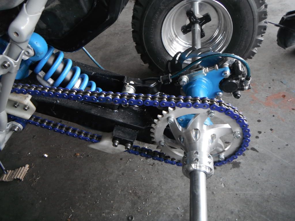

    this back end cost me a couple of my kids.

    It's looking really good, I think your second chain slider/support is on backwards though

    awesome hadnt even noticed that. let that be a lesson to you kids dont drink and build.ive got a set of carbon fiber black and a set of blue ordered with tammy. still waiting on rear/engine/pipe skid plates from omf.

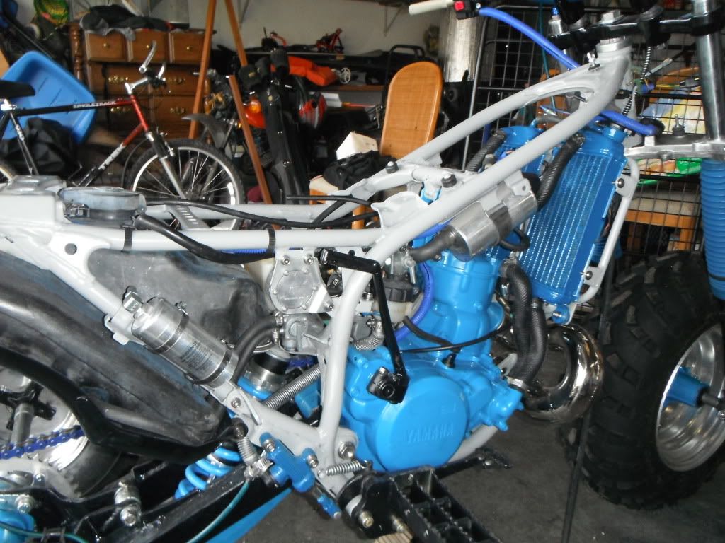

    still have loose ends wiring and hoses

    what im amazed at is it only took me 3 hrs and a six pack to rip this thing down to the frame to powder coat stage. ummm shouldve taken pictures first because im kinda like cole trickle i can ride the hell out of em but putting one together... im like a one legged man in an ass kicking contest.

    cdi anyone? dont remember does it go on the left tab or tab between the radiators?
    Sep 2006
    Northwest Indiana
    1,893
    Between the rads.

    alaska rubber made them for me 45 bucks a piece. sorry no part number i just brought them the old lines and they matched up the bajos and length. they had them ready for pick up in less than an hour. i guess i should post some info about my bike.

    figured i better give some info
    stock engine with 490it rod and spacer kit, just entirely rebuilt by dave at Alaska Drag Bike.
    new DG pipe and silencer
    banshee axcaliber rear axle
    douglas 190 wheels with razr 6 ply 20x11x9 rear and carlisle AT489 up frt
    lone star racing billet banshee 6 bolt sprocket hub
    lone star racing billet axle lock nut
    streamline yfz 450 rotors frt and rear
    new OEM calipers frt and rear
    alaska rubber made the brake lines
    works ultra custom rear shock and progressive spings frt forks
