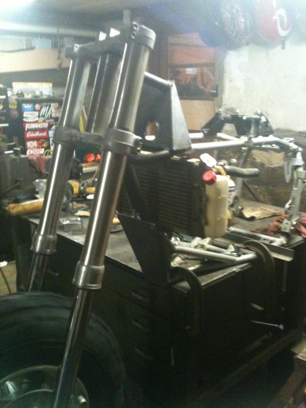

    so we got more frame work done before we ran out of weld wire heres the progress so far.

    I would be a little leary of how you can control your welds with a mig on such small tubes. Tig would deffinately be the prefered method. But looks good so far keep the updates coming.

    thats all just tacked together my welder Vito got to bring it to work to finish weld it

    It coming together nicely. How well will the plate in front of the gas tank support your top tubes from the neck? If it was me I would run some tubing from that point back to the main frame, on the sides of the gas tank.

    no room for pipe but we plated both front sides and inside should be plenty of support. i do mostly trail riding i dont go crazy tryin to hit jumps, broke my collarbone last year and cant afford to miss that much work. the video of me breakin my collarbone is on youtube that s@#t hurt!!

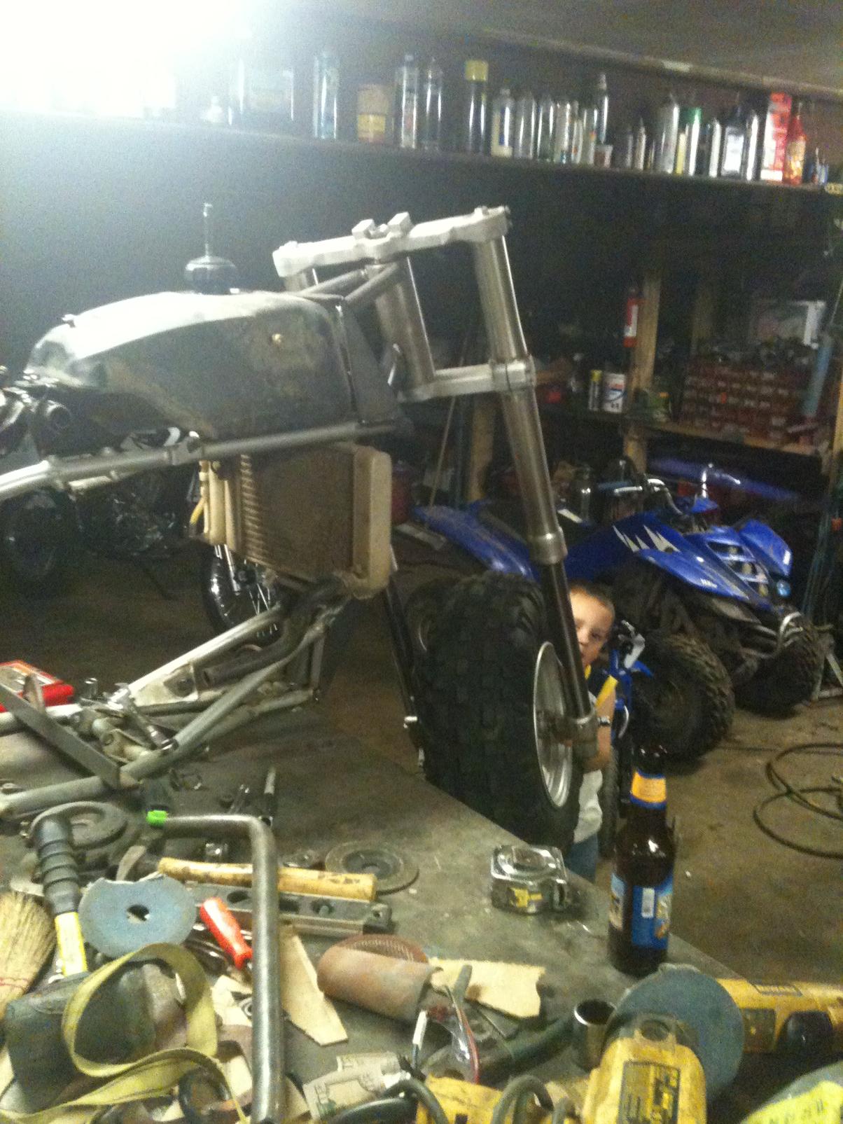

    heres a video of the the frame all tacked up just some tig and some more mig welding and its done

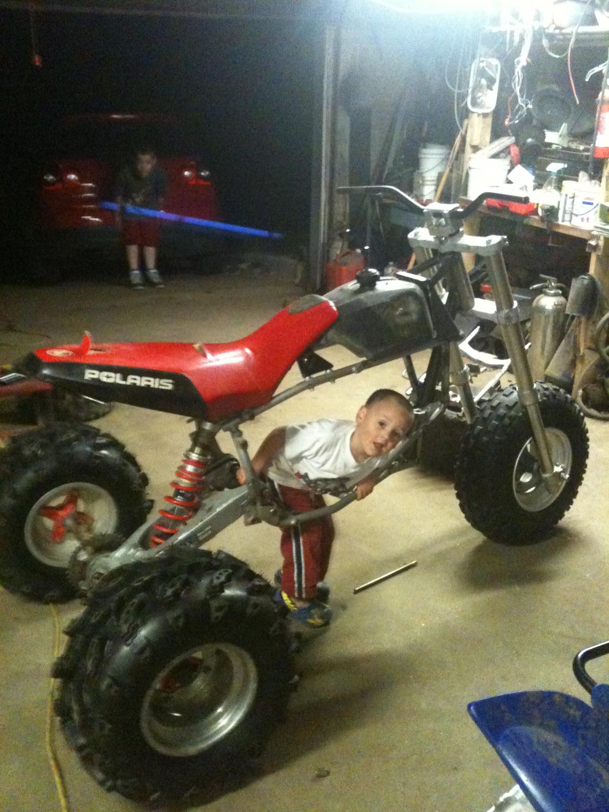

    so we got a rolling chassis!!!!
    And in case u thought it would be small heres a photo of Vito(the welder who built this for me) sitting on it
    I think we got a Junior powered trike...LOL

    its the MONSTERTRIKE!! it eats 4wheelers and dirtbikes!! cant wait to see it rip!!

    Looks really cool. Very long engine cradle.
    But honestly I would gusset the sh*t out of that steering neck area.
