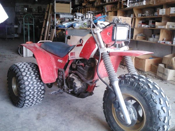

    im told this is a 200x. it obviously says 250sx on the rear fenders. whats going on here? are they interchangeable? ive been searching for a few hours now and ive seen nothing.

    check the neck of the frame on the right side should be year model and vin

    Looks like a 200x with SX back fenders

    Those are 200x fenders with a 250sx sticker.

    I agree with Jason, 200x with a 250sx decal on the rear fender. 250sx's dont have front or rear disc brakes, or a live rear axle.
    Wonder why someone would put a 250sx decal on there, so weird.

    i dont see 250sx mud guards or the holes for them on the fender, also is there a trunk, 250sx had a trunk unless you have aftermarket maier plastics, but im leaning towards 200x fender with 250sx decals......but why??

    Its a completely stock, original, 200x. With the sticker. Even has the original front tire still.

    it looks like a 1983 200x with the correct plastic and the wrong stickers.

    ill find out sunday sunday sunday! and hopefully its not a pile and i have a 3 wheeler!

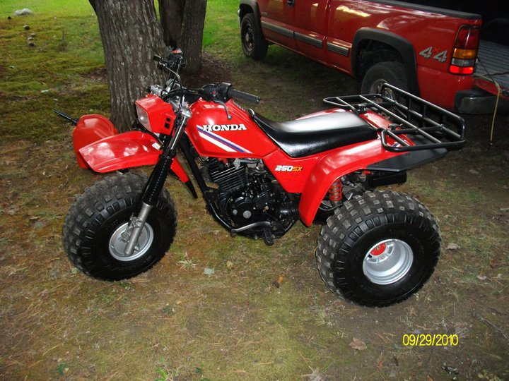

    Looks like a 84 200x...Definately not a sxClick image for larger version.

    YUP! was an x with sx stickers. story is the previos owner was restoring an sx and had 2 sets of stickers. they ended up on the 200x for some reason.
    mine now! starts like crap and wont idle... my foot hurts and im tired. carb rebuild tomorrow.
